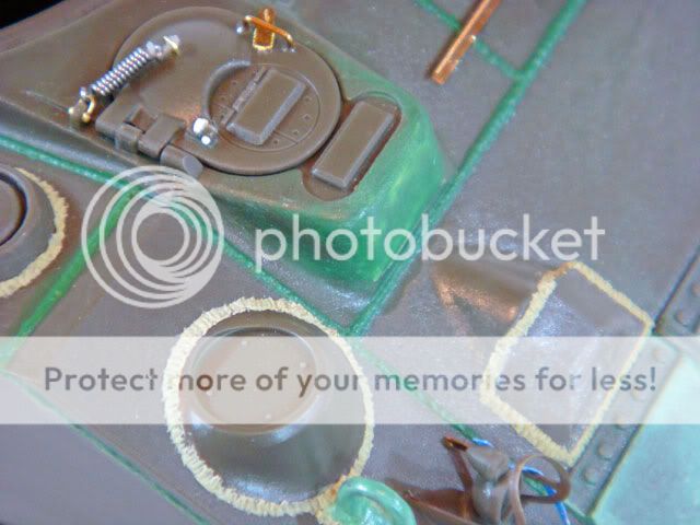

For long, straight welds, I use two pieces of blue painter's tape (cut thin on a piece of glass) laid parrallel on ether side of the weld. I fill the space between with thinned Squadron Green Putty (thinned with acetone and liquid cement). I put the thinne putty down with a cheap, nylon-bristle paint brush (easy to clean).
After the putty skins over, I use a toothpick (cocktail stick) with one end carved to a chisle shape, dipped in acetone, to "chop" along the weld and create the texture. I then peel up the tape, and apply a bit of thinner along the weld to soften the edges and blend it some.
Sounds like a lot of work, but it's actually very fast and easy!
For small welds or welds along tight corners or at the bottoms of small PE parts, I use Milliput two-part epoxy. After mixing, I roll thin "worms", chop the worm into a short piece (the length of the desired weld), apply it to the model, then use the same toothpick (wetted with ordinary water) to chop and texture the weld. Also, fast and easy.
Here's a photo of some on my Firefly:
And the same kinds of welds after base-coating:
