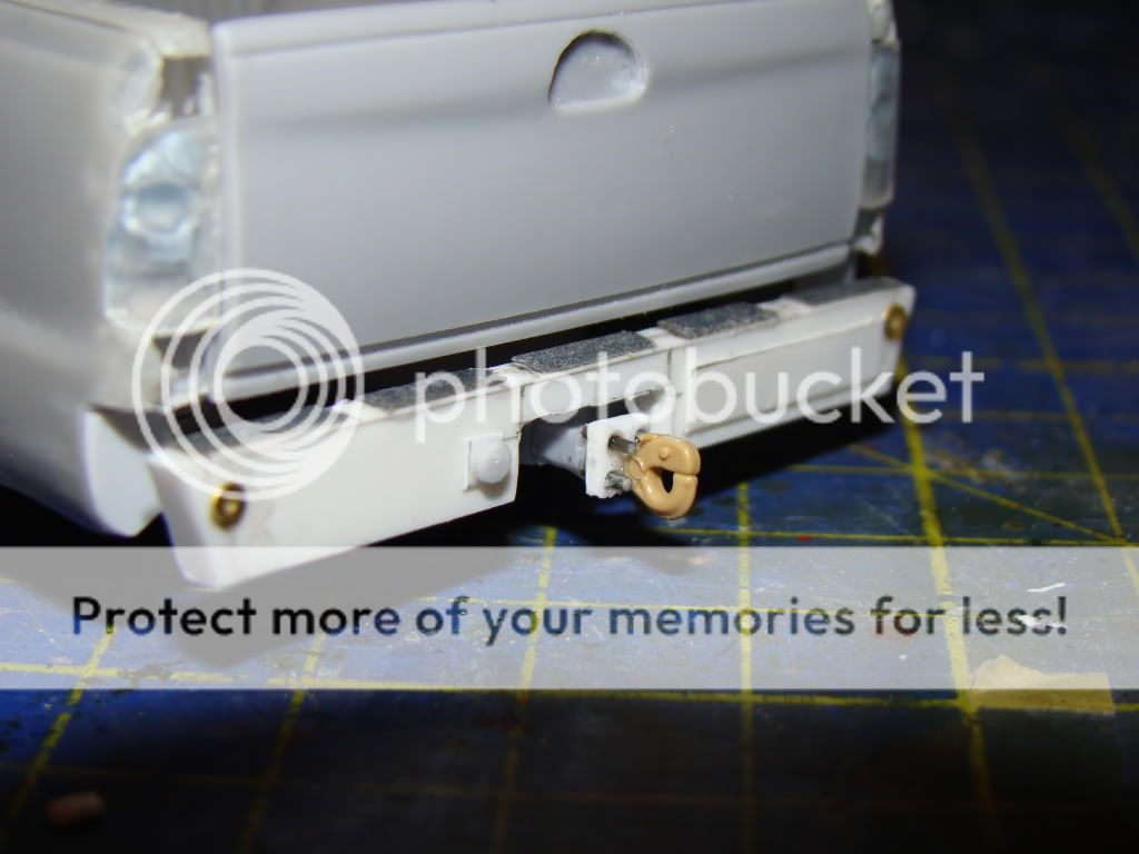

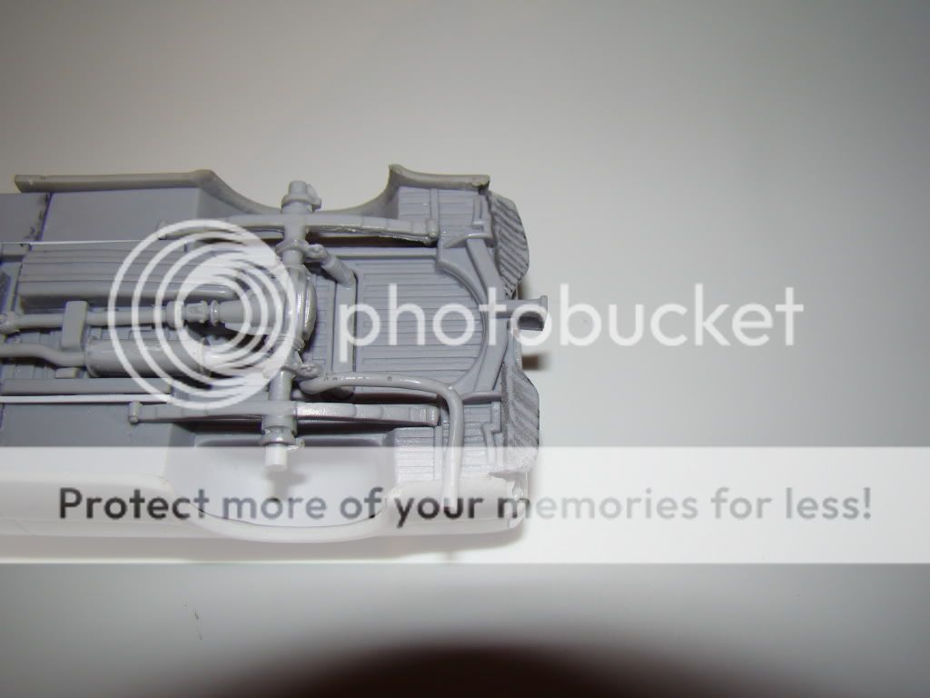

Last night I started scratching the rear fender (Bumper).
As the kit bumper is more suited to the commercial market & has lovely lines & curves, the Irish F-350 is a less glamorous design and very simple in design.

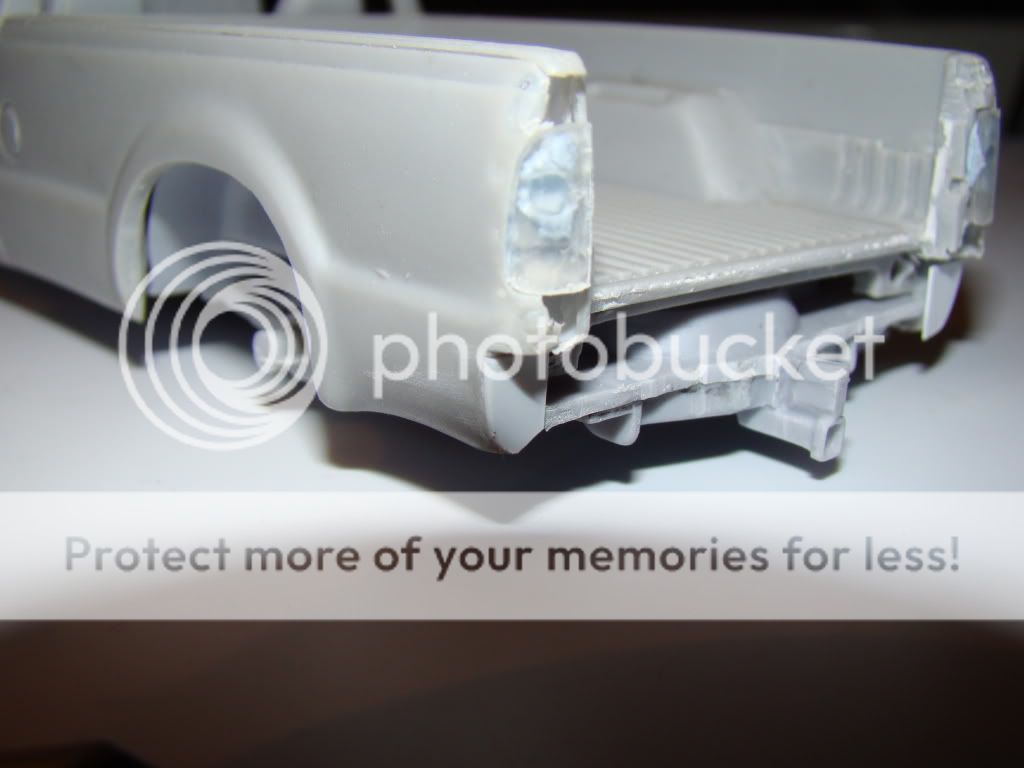

To start with I had to remove the fitting for the commercial bumper seen below.
The original bumper/fender itself is not needed & cannot be converted so I had to scratch a brand new one.
I began by marking out with a pencil what I needed to remove from the rear end chasis (see below)
I cut this away and sanded the area down.

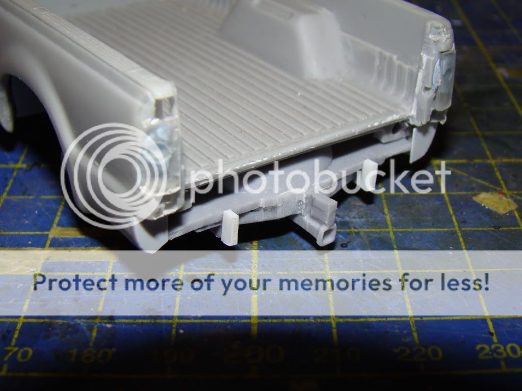

Next I added some thin plastic card to the corners of the pick up hull to simulate the where the hull end curves in, usually hidden away by commercial bumpers on most vehicles.
next I added new attachments for the scratched tail fender. They are just an extension of the main chassis as the rear fender doesn't hug the rear body and is extended a few inches from the main chassis and body.

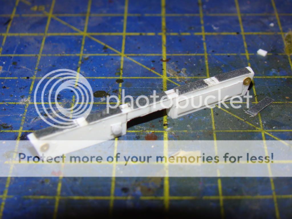

I began building the rear bumper (fender) using tow pieces of thick plastic card glued together.
I measured out the length & depth of the bar and cut away a small rectangular section in the centre for the tow hook assembly.
I used small cut out pieces of P600 super fine Sandpaper as the foot grips on the top of the frame. I scratched the registration plate, added an electrical socket for towing and some PE rear reflectors found in my spares box to the face of it too.

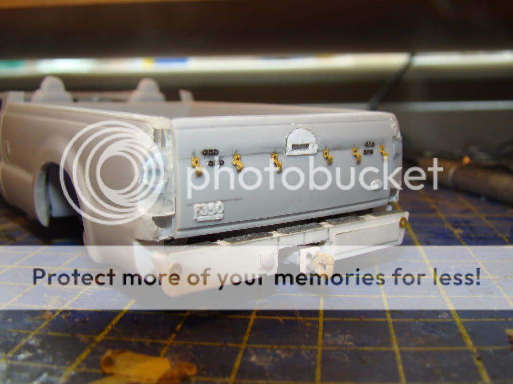

A tow bar attachment is built into the Vajra kit but it is the wrong type for this project & is also in the incorrect position for the Irish F-350.
To correct this I removed the original cast. I rebuilt the required tow hook bar & joint from scratch. Attaching it up higher onto the rear chassis & later adding a tow hook pilfered from one of my spare Humvee kits.
Here is the new rear fender now attached to the hull, along with the scratched tow hook

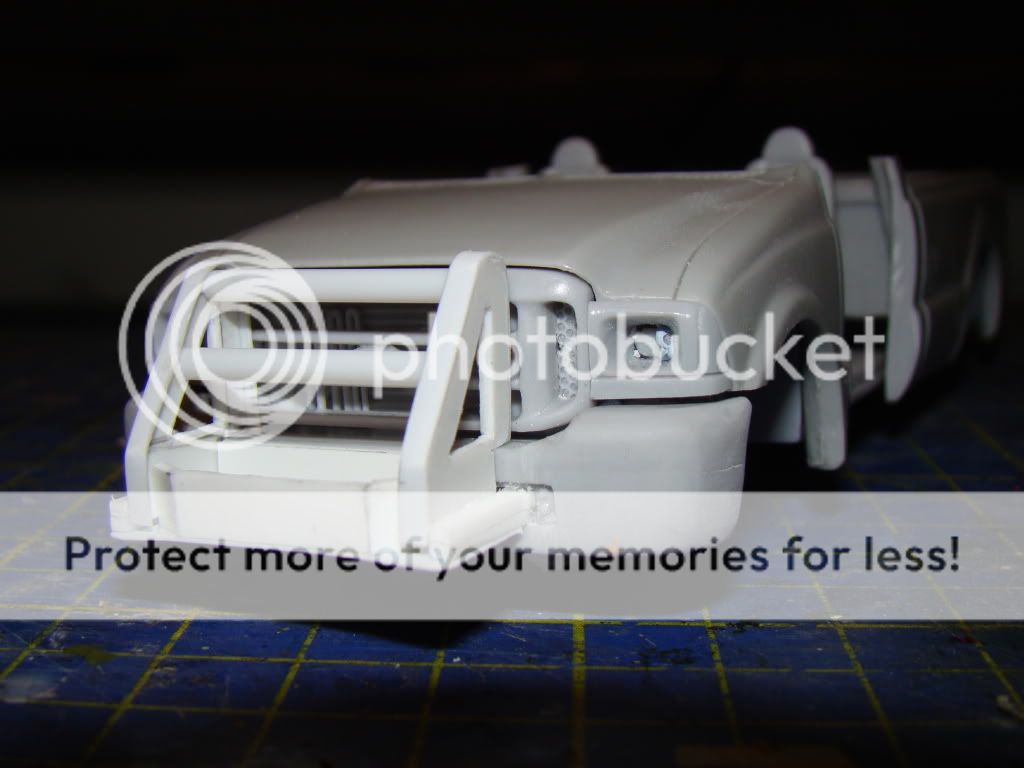

Posted: Tuesday, February 15, 2011 - 10:15 AM UTC
Seb, Shane, Nicola, Thanks so much guys!

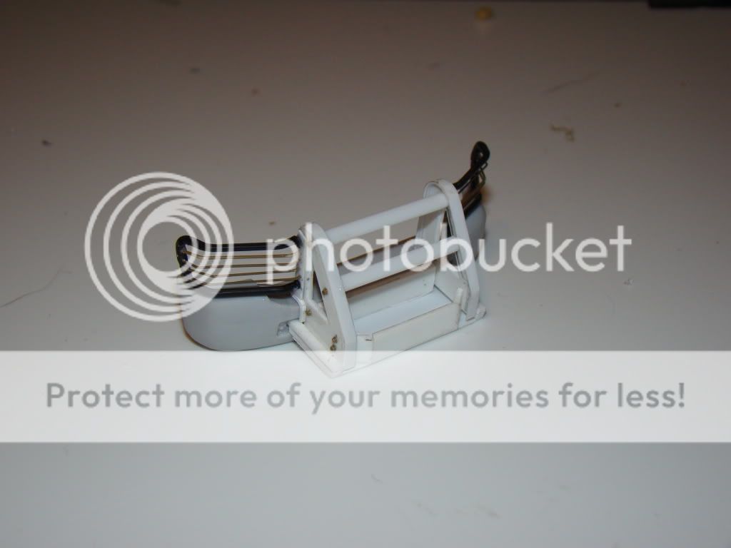

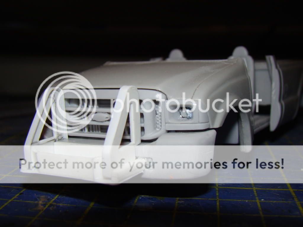

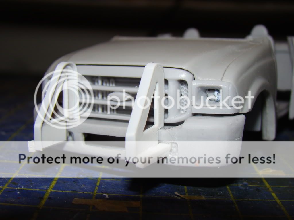

I moved on to the front bumper section today & spent alot of hours scratching the bull-bar rig.

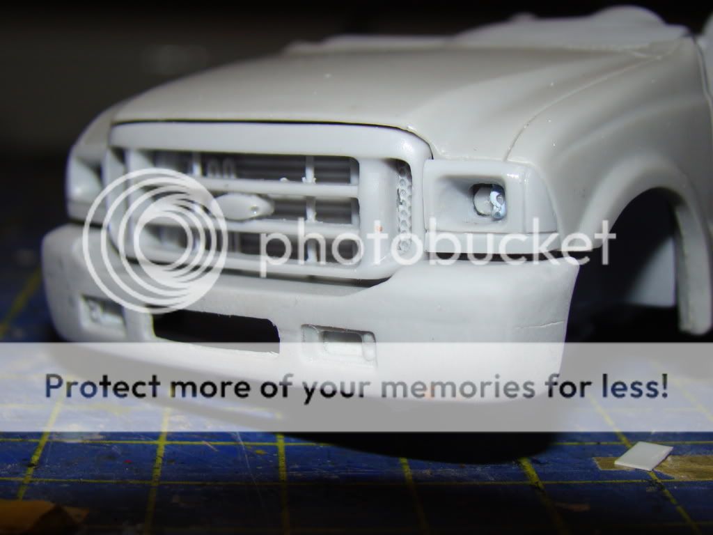

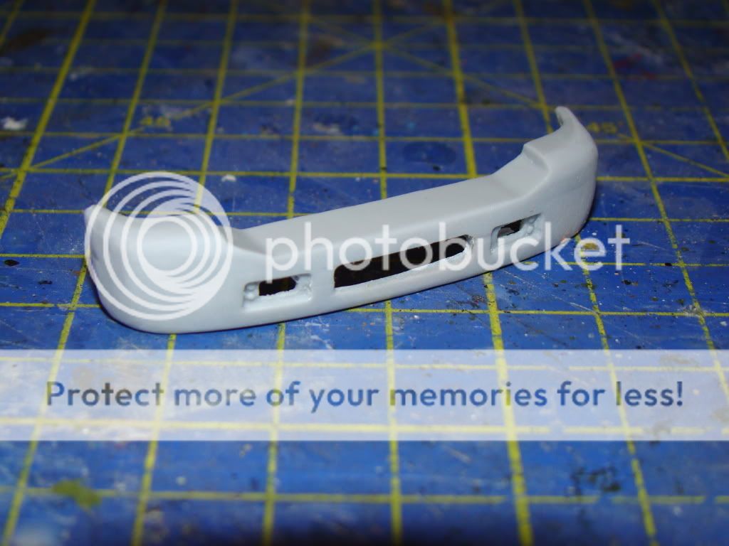

I began by returning to the front bumper again and sanding it completely down. The SRV has a plain bumper as I mentioned before so I had to get rid of any signs of the commercial fender in it!
Next I put some plastic card in behind the front bumper slats where the chassis is hidden. The frame that supports the Bull Bars are attached here on the Irish F-350's.
Using Plastic card I scratched the Bull Bar frame.
I added the base of the Frame where the motorised hoist is located.
Then using cut down cotton bud sticks I added the two main frame bars to the centre section, connect at both sides to the Bull Bar frame.

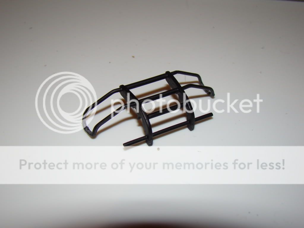

I had an old Bull Bar set from a die cast 1/43 Jeep I had been fooling around with & was amazed to find that I could use the leading edge sections as a perfect frame for my 1/35 Bull Bars!
I added these to the partially constructed Bull Bar frame and found them to be just perfect!
Next using very fine stretched plastic sprue I added the smaller bars to the inside of the left and right side bar frame.

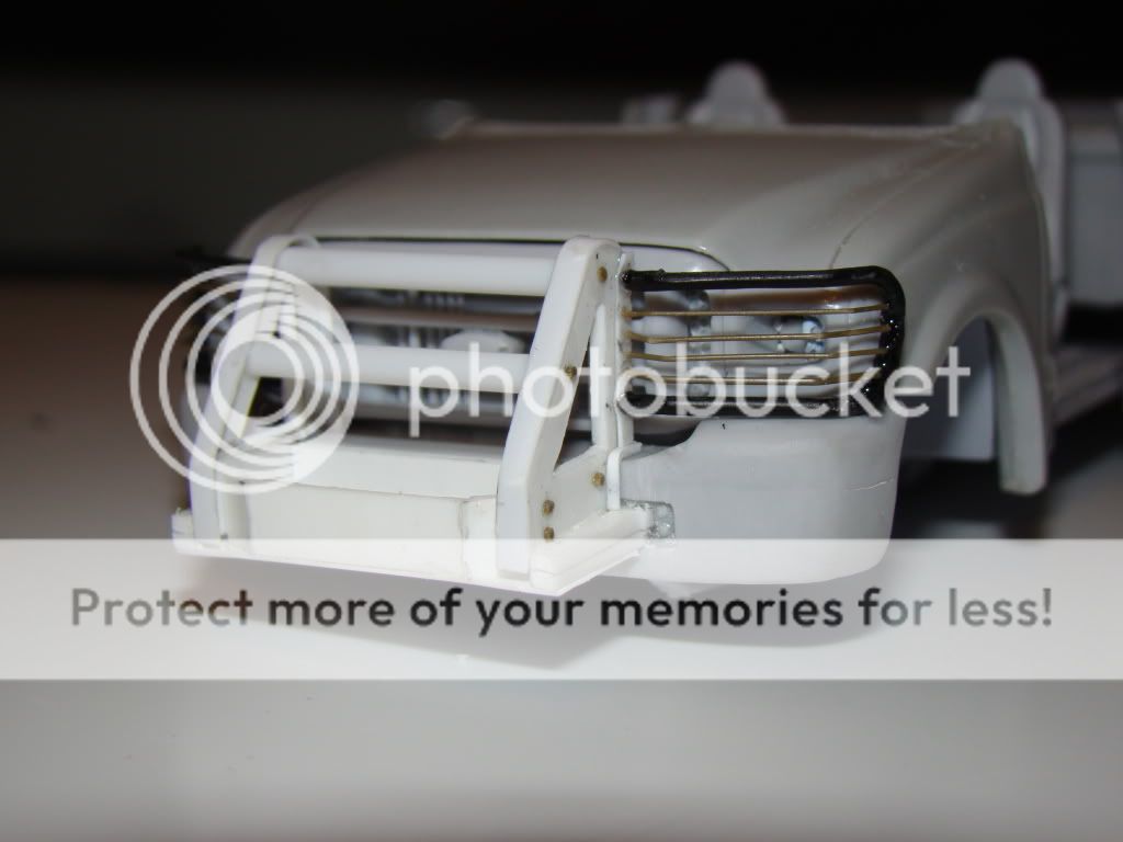

And here is everything dry fitted so far.

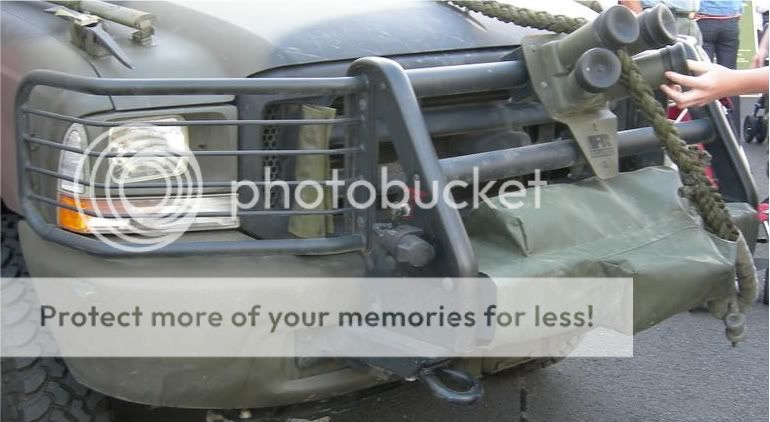

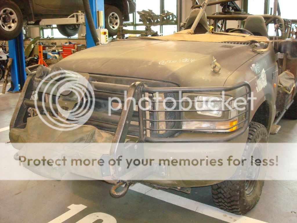

My F-350's hoist is going to be covered like the photo so I'll be returning to this later in the build when I'll be constructing the rest of the canvas sections!
BTW I wasn't entirely happy with the result at first but later AFTER these photos were taken I went back to re-adjust some of these fine bars. I'm going to leave this section for a few days and take a look at it with fresh eyes during the week, if I'm not entirely happy with these small bars again I may use another media to build this small section. Infact I have some small brass roads being delivered over the next few weeks from Lucky Model so they might be perfect!

umm, wow glad there was page 2 otherwize i would have been disapointed this is one hell of a kick ass build you have going on here special forces stuff is always at home with the scratchbuilder keep it going and keep us posted
personaly ithink the main bars on the bull bar were the winch is mounted are to thick need to use a smaller tube stock ......jamie

J, thanks for your kind words mate! I understand where you are coming from with the centre bars, but honestly this is more a result of my bad camera skills than the wrong size of tube With the White color, the proximity of the kense being so close & ultimately the flash everything is appearing chunkier in the pics including the main frame I built too! Infactvwhen I posted the photos last night I actually got a fright looking at the frame thinking it was oversized but when I went back to the model itself I was relieved to find everything looked ok ..but please feel free to point out anymore things that don't look right, I'm open to suggestion from a fresh set of eyes

Posted: Tuesday, February 15, 2011 - 08:43 PM UTC
This one looks really good, impressive and something that others can learn from (a good 'how to' guide). Just two perhaps nitpicking points:
- There seems to be the remnant of an airbubble in the oval thingy in the centre of the engine grill.
- The 'ghost' of where the original bumper was supposed to go seems to be a bit more rounded, and the end-plate is slightly thickened. On the last image of the rear you posted it seems it is still square and not thickened yet.
I am looking forward to the next installment of this build-log.

I think the bull bars look just right- with the different materials in their natural color it is bound to look weird in a picture, especially if it isn't professionally lit (thats not a commentary on your photo skills Roy!). I reckon it will all look better under a coat of primer- a single color will help to bring it all together before painting the camo begins.

Posted: Wednesday, February 16, 2011 - 04:28 AM UTC
Hi Harm, thanks for your kind words!
Your completely correct about the air bubbles in the front section (that would be the Ford badge to be precise), infact the cast has quite a few air bubbles through out. In particular the rear pick up section on both sides of the back door!
I will be filling these in later when I am finished the entire scratch conversion, no point doing it now & having to return to it again later!
I'm just a little bit lost as to the rounded bit at the rear you mentioned, however if something that's meant to have a sharp edge is looking a little rounded I can assure you it's just like Karl said, it's likely the photo! Ive spent quite a while ensuring everything has been sanded down flat were need be
I'll try attach better photos later
Karl, as ever thanks for the support man!
I'm of the same opinion that this will hopefully look a whole lot better with colours applied & some more care taken with the camera!
Infact I might start taking photos that are not so close to the camera lense & without the flash, it's not doing tge model much justice!

Looks good, but personally I'd redo the fine bars that are protecting the headlights. The bottom one looks thicker then the rest of them on the left handside. Try some .10,.15 or .20 styrene rods or brass rods instead?

Scott; I have to agree with you, I'm not entirely happy with those fine bars, I mentioned this earlier. As soon as those brass rods I ordered arrive I'll be returning to this section to improve it

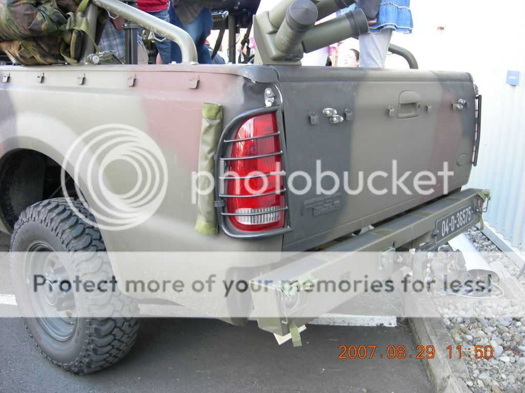

Posted: Thursday, February 17, 2011 - 04:32 AM UTC
Obrigado Vinicus

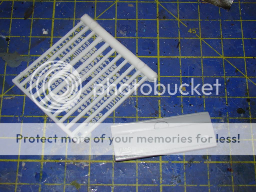

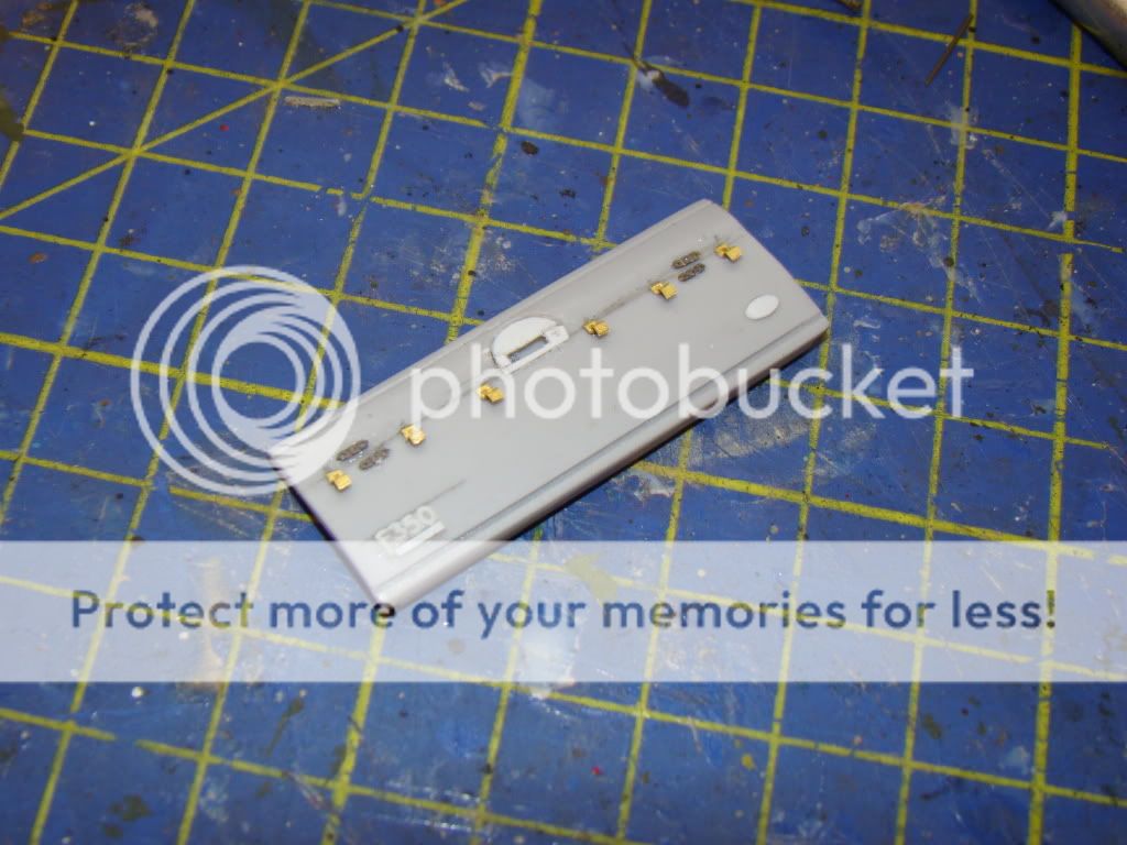

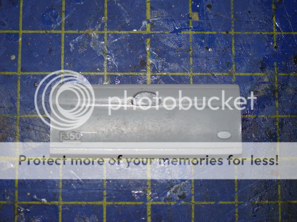

I got back to work today detailing the rear pickup bed door.
Using a tiny plastic stencil sheet containing letters & numbers that I got from my bud Aaron Smith I designed the F-350 moulded badge seen on the rear door.
you can see from the photo above that I also added the ford badge shape to the right hand side of the door too. This is sprayed over with the body color on the Irish SRV.
I continued on cutting and bending some small PE I had and used it to detail the tie-down hooks that run horizontally along the back door.
I also rebuilt the the rear handle for the back door in the centre.
Here is the newly refurbished door attached to the rear pick up bed.
