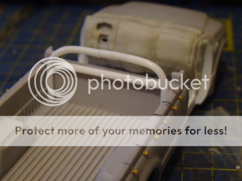

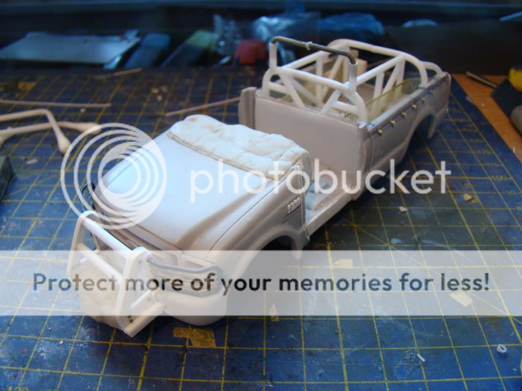

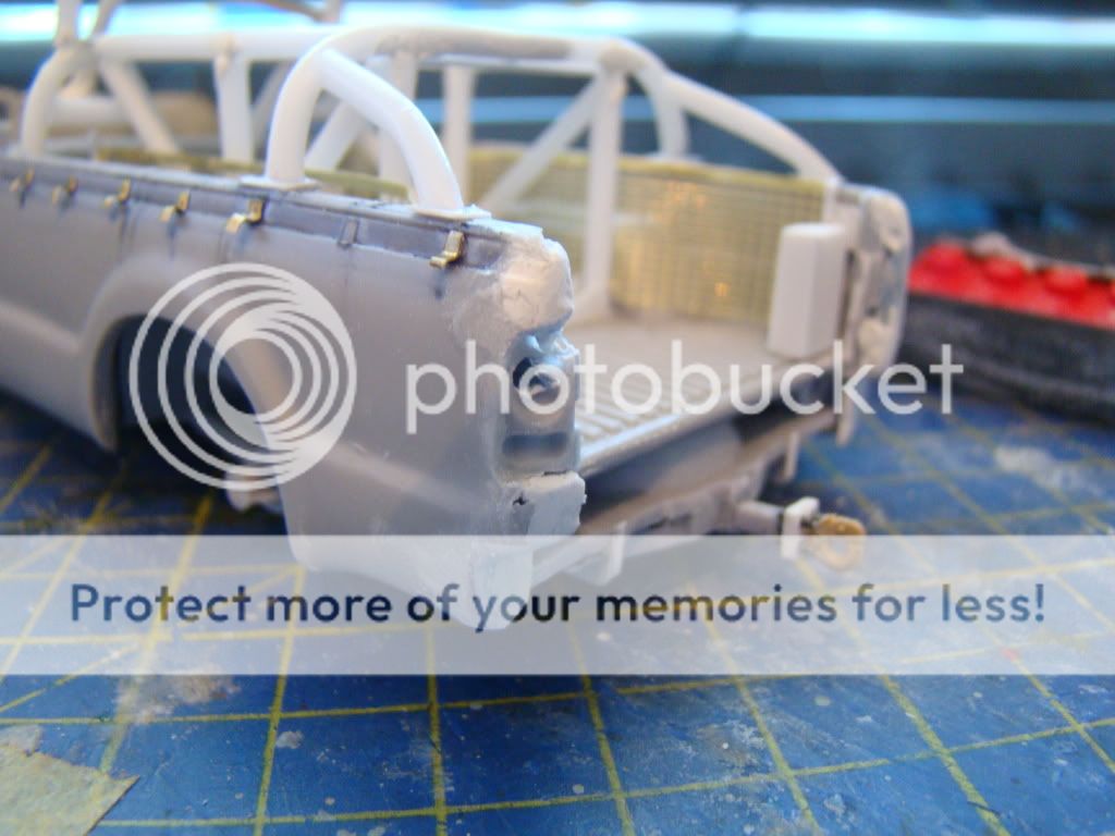

Just a quick update guys as I have to run!

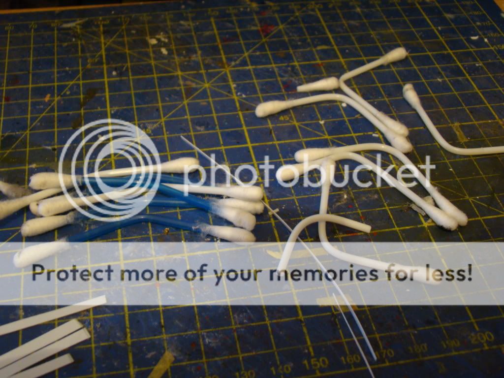

I didn't get to spend as much time as I wanted to on the Ford yesterday but I made some headway on the rear Ricardo Roll Cage.
I used some cotton bud sticks for the frame. Bending them carefully over a hot candle!
Its painstaking work, and I've alot of filling and sanding to do but its coming on ok

Ah...cotton buds- now there's something I never thought of. I would've been melting sprue's all over the shop! Looking good Roy- and that pic from Chad is class.

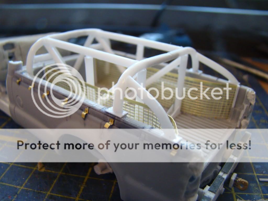

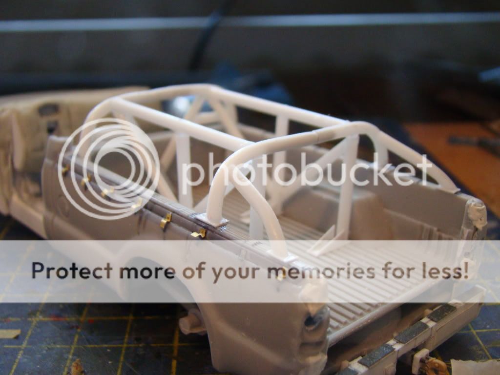

Frank: Welcome aboard and thanks for the support! The Roll cage was a little trickier than i first thought, considering the hours I've put in I'm pretty happy with the results so far but I have alot of cleaning up to do here later.
Karl: Thanks again mate, yeah the aul cotton buds worked wonders! I managed to destroy two for every one that I managed to bend with heat though. Whatever detergant or anti-septic these things are coated in does not work well with glue, poly or super!
Gino: good to see you back man, cheers for the kudos!!
Alan: Howya bud, well to be honest I'm going to go with the camo netting over the roll cage, as you can see its not finished yet but nearly there. When its all tidy I'll apply the netting. (should cover up some discrepencies too)
In regard to the figs I hav'nt really made my mind up yet, I'll attach two pictures below to give you an idea of some of the choices available to me, I'm sure I'll stick a steyr in somewhere but I'll also go with something different seeing as its SF.

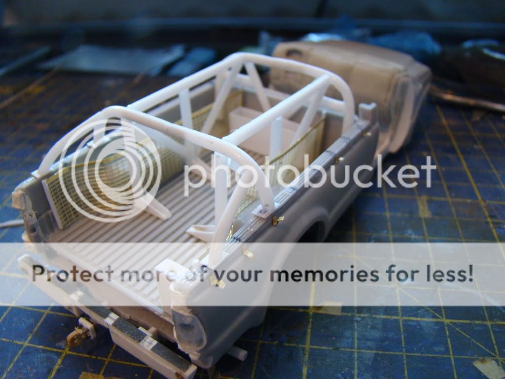

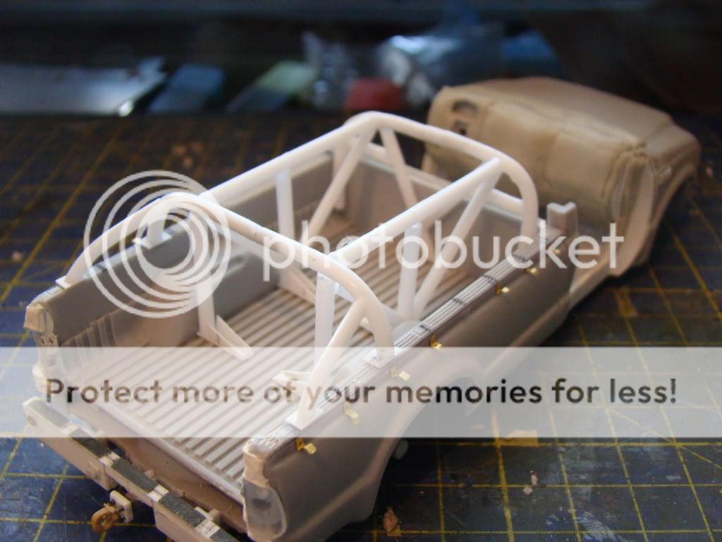

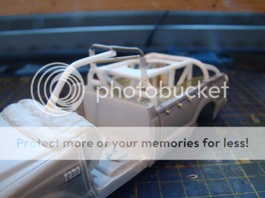

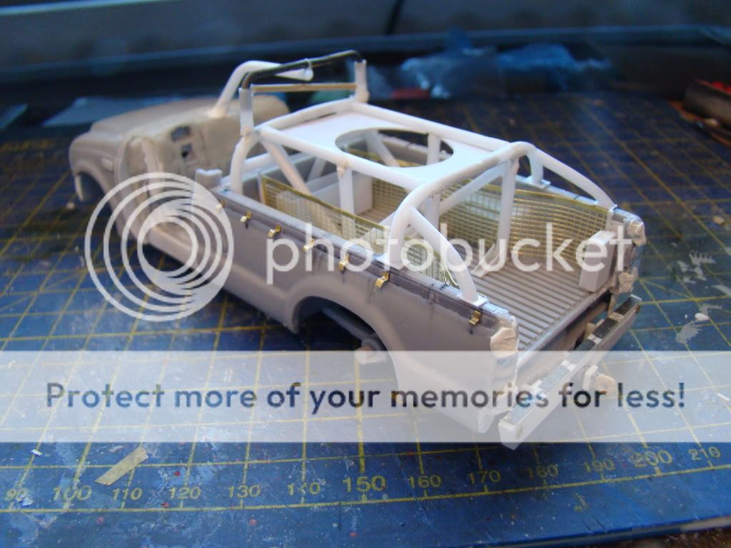

Today I got some more work done on the rear bed.
I built up more of the roll cage.
I added the netting that aligns each side of the rear bed too.
Just at the top centre of the rear bed you'll see I built the large storage box, this usually houses parts belonging to the mounted main weapon, like a spare barrel for the 12.7mm. I also imagine the spare barrel for the GPMG might be stored here too within a short distance of the mount on the passanger side of the cab.
The little white box at the rear of the pick up bed (just right of where the door will be) is a scratched battery box for the Sincgars. (i'll be adding a Baby Sincgar to the main cab later in the build)
Anyway here is where she is at now,

Shaping up, shaping up! The roll cage looks awesome- it gives the Ford a much more menacing presence I think.
What tyres are you using Roy, the kit ones or aftermarket?

Karl: cheers bud! Good question by the way! This little area has been bothering me.. The wheels and the Tyres in the kit are totally different from what I need!! There are no aftermarket bits for this so Plan A, I'll have to try convert the wheel or try something else (I have a plan B, not gonna speak to soon but might have an easier option..)

OK guys here's the update!

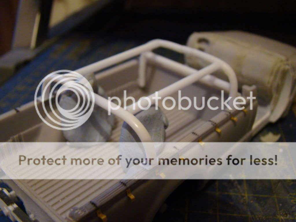

Firstly I did some more work on the Roll Cage earlier today

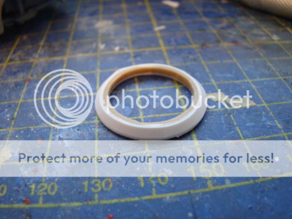

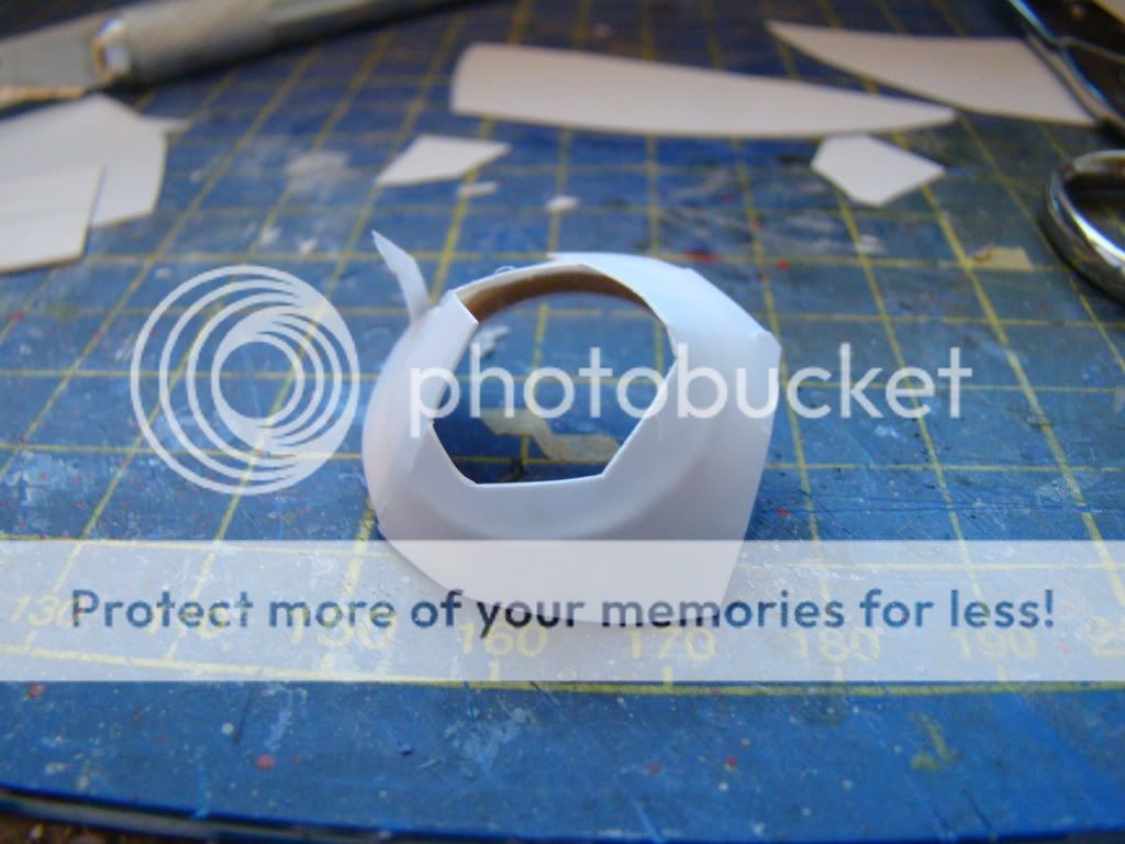

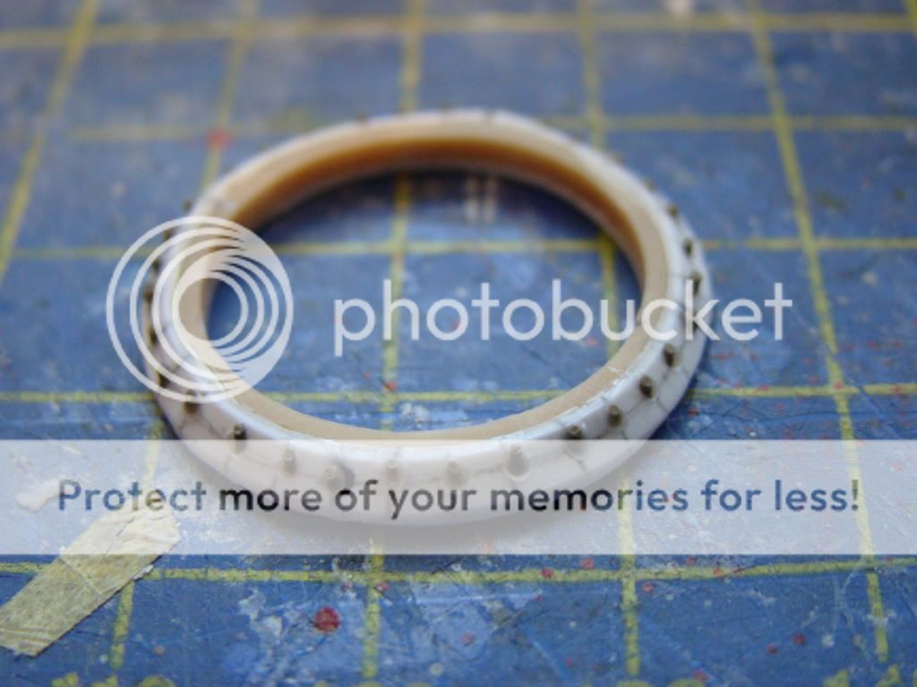

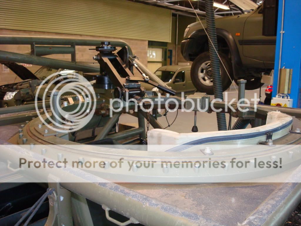

Secondly I took off the rear bumper (fender) to get in at those little tight areas that needed the attention of some filler and sanding! I had some square looking areas that i needed to round off so got I that out of the way.

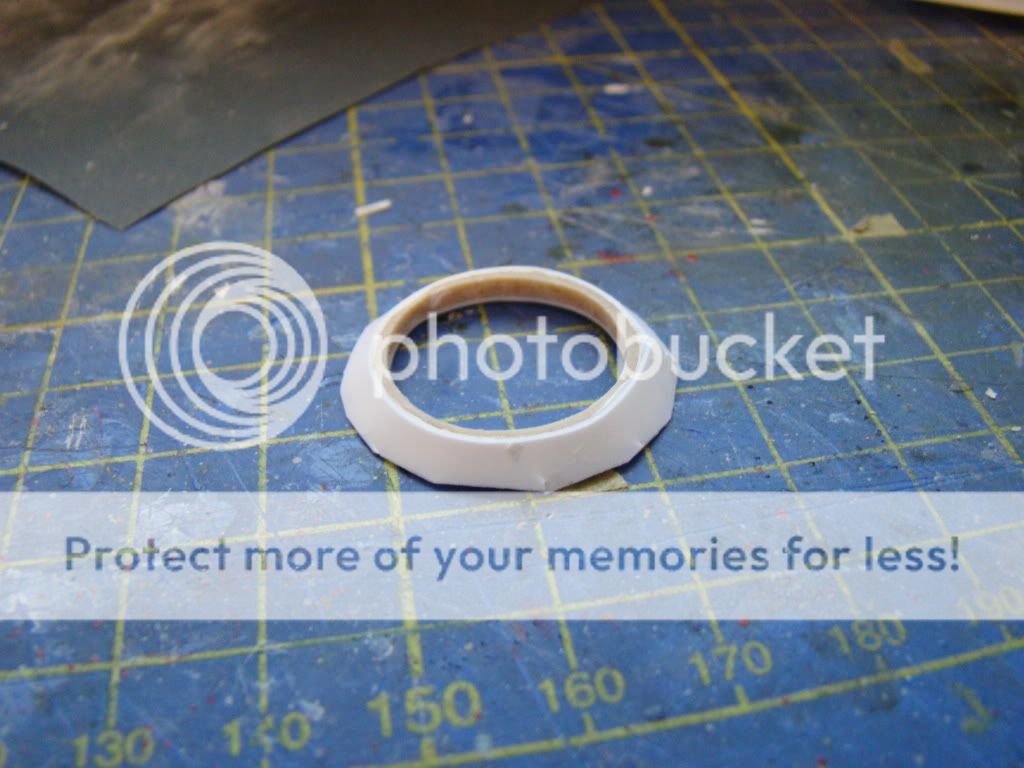

Next I decided I'd build the crew ring mount on the top of the roll cage. I began By measuring out the exact size ring I'd need, the results eleminated everything in my spares box so i had to scratch built one.
Lucky for me the inner circle of the ring I was going to have to scratch is just a little smaller than the standard plastic inner ring used on Tamiya Humvee roof turrets. (The bit used in between the the roof hatch and the internal roof ring)
So begining with this Humvee piece I began building the ring mount seen below in this photo

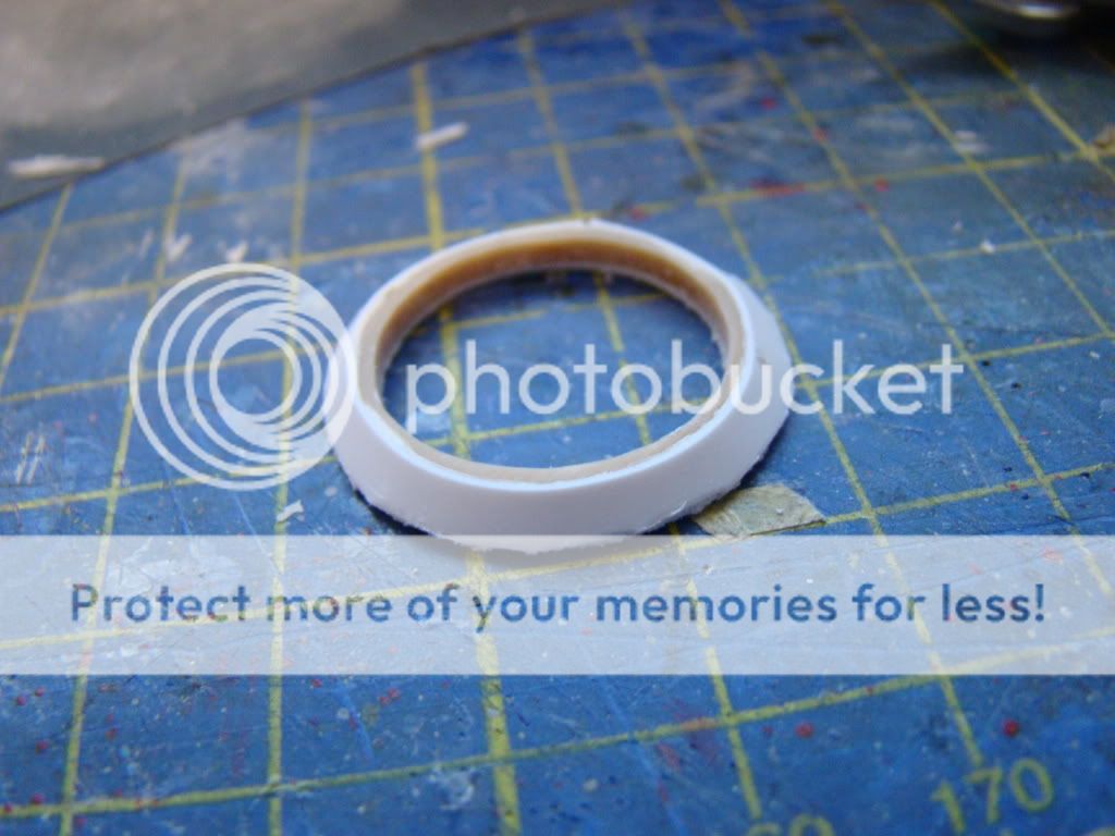

I began by scratching a base for the humvee ring using plastic card.
This ring section would be a little bigger than my spare humvee ring allowing me to build up the wall and surface properly.
First I used some filler, then when it dried I applied the outter skin of the ring using more plastic card (seen here in a cone shape)
Next I cleaned off the cone shape leaving the ring to take shape a little
..a bit more sanding and cleaning later
..and another bit of sanding and cleaning later I'm left with the general shape..

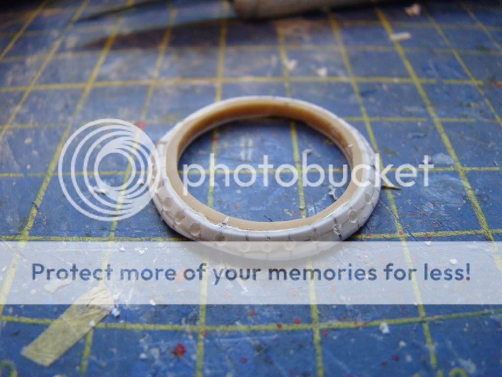

Next I measured out the bolt marks that you can see running along the ring mount in the photo and I drilled little holes around the outer circle
Lastly I added some stretched sprue to each hole. leveling out the heads of each one with sharp cutters to illustrate the bolts.
it looks messy because of the pen and pencil marks but I was happy with the result and it should look better when primed!
There was a very slight fit issue mounting the ring onto the roll cage but a bit of sanding here and there managed to allow the ring mount sit comfortably in its cradle.
I have to come back to this later to detail the ring mount but thats enough for one day

You bent the Qtipes rods with a lighter ??
