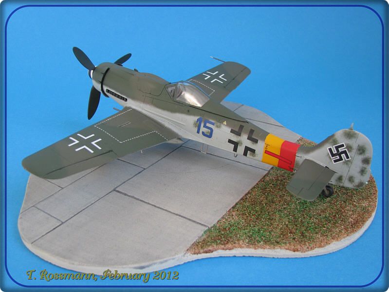

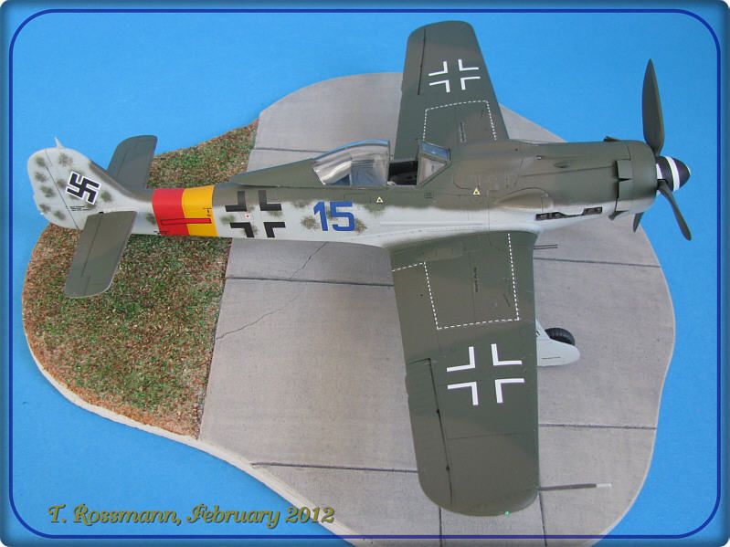

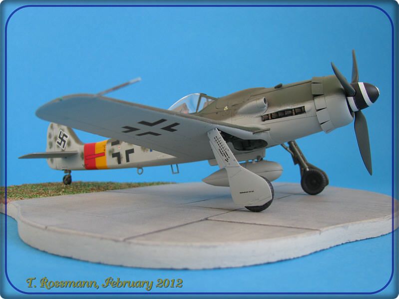

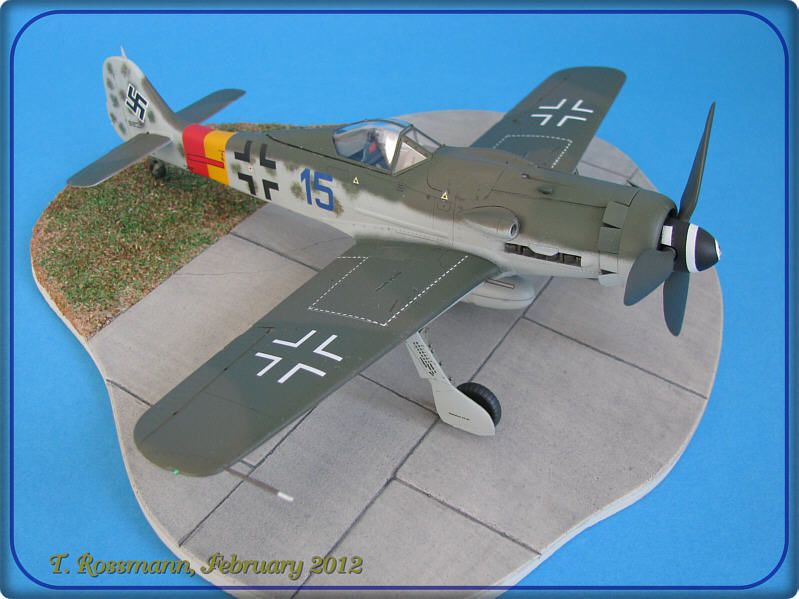

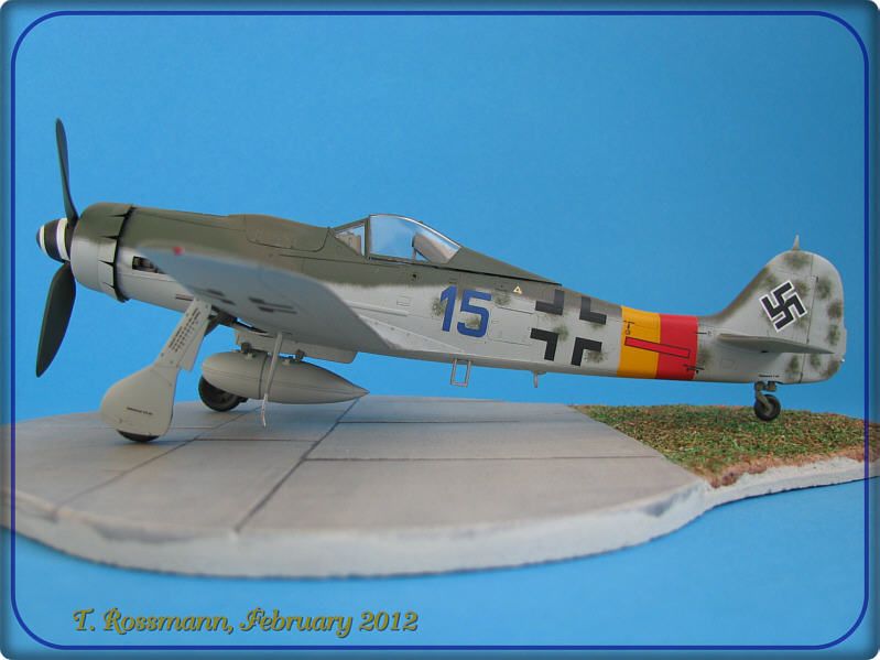

Well folks, the first Germans have arrived here ....
Maybe a few of you follow the "Würger" Campaign for which I've built these 2 beauties.

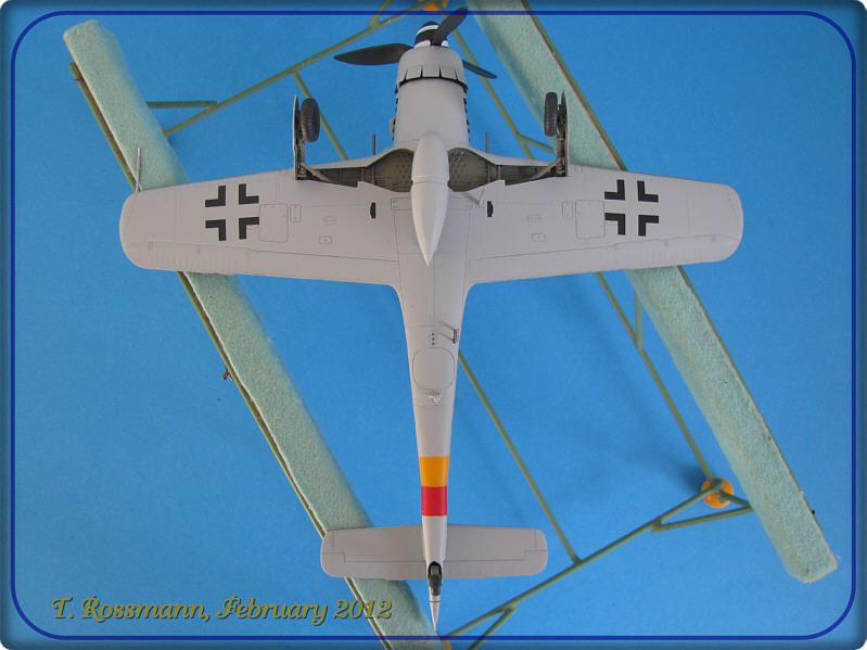

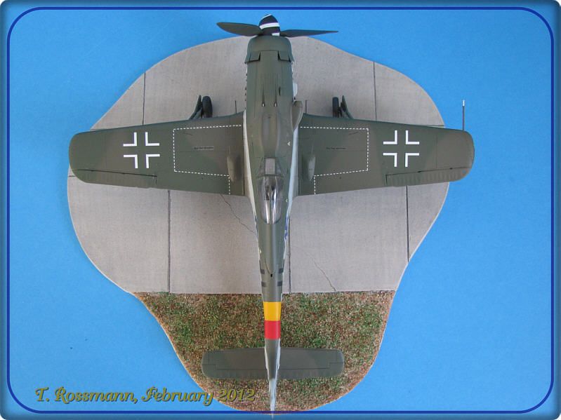

First I want to show you my new Fw 190 D-9 from Tamiya in 1/48 (of course .... )
Kurt Tank called the "Dora 9" just a compromise on the way to the Ta 152. The "Langnasen Dora" was powered by a Jumo 213 engine with about 1700 hp. Originally that was a bomber engine, also used in the Ju 88. That's why many pilots first thought, the D-9 would be slow and a lame duck. But they learned better .... As we know today, the D-9 was one of the best fighter aircrafts in the German Luftwaffe, which at least equals all allied fighters like Spitfire and Mustang. The armament consisted of two 20 mm MG 151 in the wings and two 13 mm MG 131 in the fuselage.
Tamiya offers 3 decal versions and I've chosen the one on the box from 4./JG 301 in 1945 with this colourful fuselage band. Building the kit is no problem at all. Everything fits together perfect and no filler is needed. Just a bit of sanding, that's all. But somehow the canopy doesn't fit properly since I've opened it. Sorry for that.
But this lady gave me a really hard job with the paint. For the first time I used Testors paints and airbrushed RLM 76 but that came off again with the tape .... So I took Gunze's RLM 76 and everything went fine. Next colour was RLM 81 Brownviolet and for the first time my ever faithful Agama paint let me down and made a mess when it left a grey shade on the kit which looked like dust. I've never seen this before .... Overspraying didn't help so here I picked Gunze again and everything was fine. Finally, when everything was finished and the masks were taken from the canopy, there she stood in all her beauty, my new Focke-Wulf 190! When I took the model away from the workbench to store it on the shelf, I banged my ellbow on the stool and the brandnew model fell about 1,50 meter on the floor .... I must have been shocked for a minute or so when I finally looked for the damage. Puh! Lucky me! Nothing serious happened, because the kit fell on the landing gear. Only the fragile Morane antenna broke off and one main wheel got loose. Repairs took 5 minutes.
As I mentioned, I mostly used Gunze on this bird. RLM 76 is H 417, RLM 81 is H 421 and RLM 83 (Dark Green not Light Green!) is H 423. The yellow/red fuselage band was painted with Revell 310 und 36. For the canopy I used the Eduard mask EX 005. As always I've built out of box and not weathered.
Happy modelling!

Excellent recovery Torsten! Your bird looks great! Thanks for sharing it with us. Russell

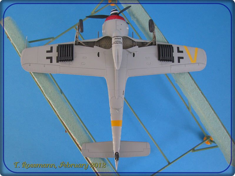

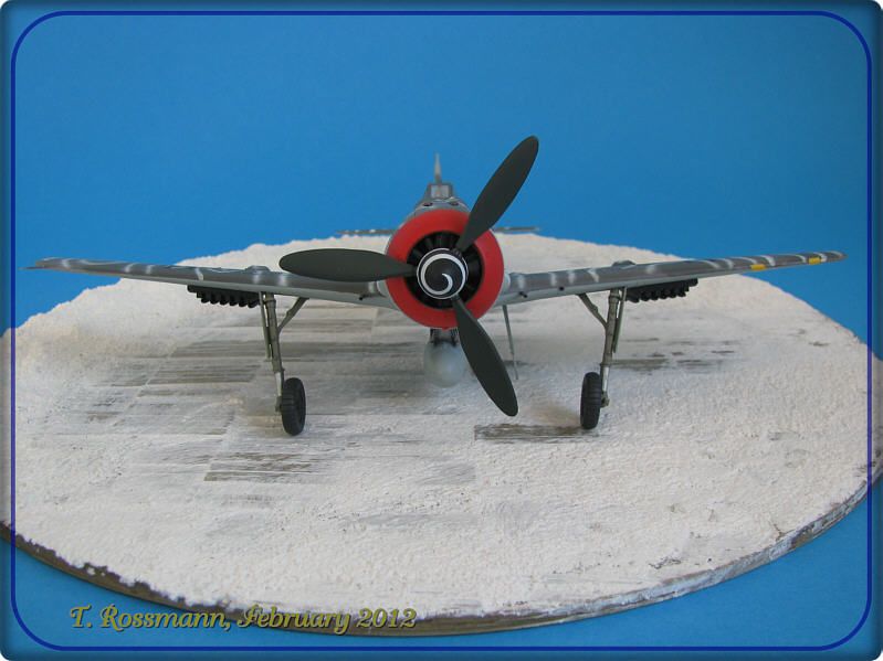

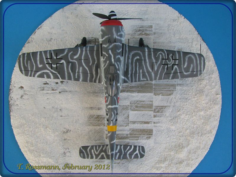

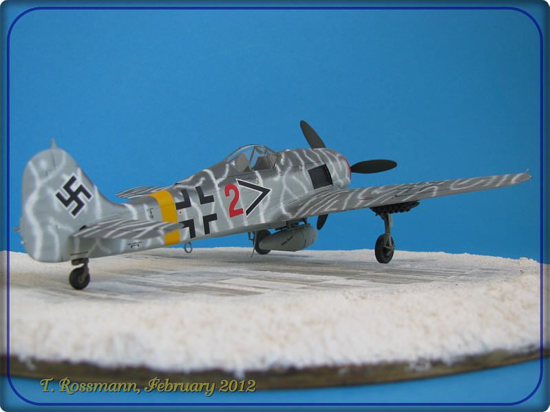

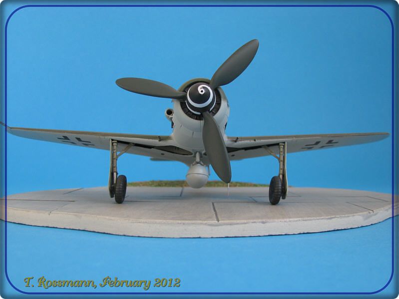

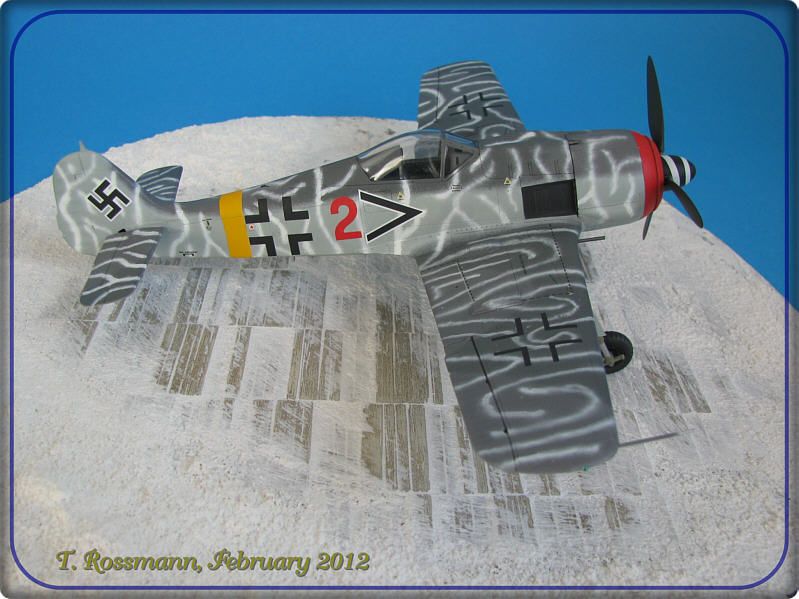

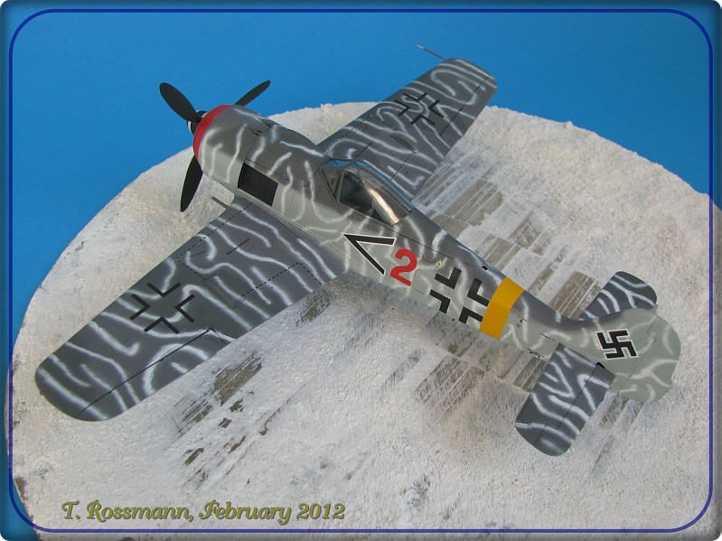

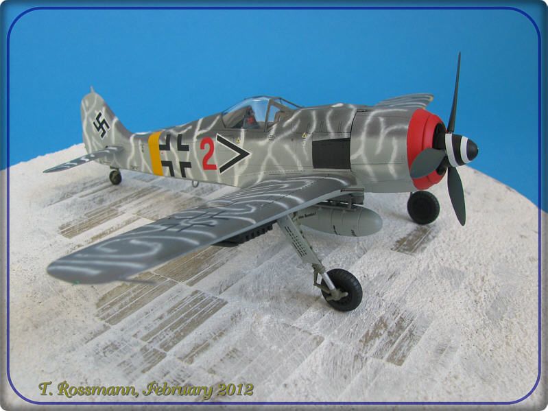

The other half of my first dual combo this year is the Fw 190 F-8, also from Tamiya and in 1/48 again, finished just a day after the D-9.
The "Friedrich" was the fighter bomber version of the fighter, also powered by a BMW 801 with about 1700 hp. The aircraft was more armoured than the fighter and had a stronger landing gear to carry bigger bombs. On the other hand the weapons were reduced to only two MG 151 in the wings and two MG 17 in the fuselage. In the Schlachtgeschwader (fighter bomber wings) it replaced the famous Ju 87 Stuka, which became more and more obsolete.
Tamiya offers 4 decal versions for this kit and I went for this one in winter camouflage from I./SG 2 in Hungary, January 1945. Building it is the same fun as the D-9. Again no problems at all.
Except for the white camo the painting is nothing difficult. For the white lines I used the 0,25 mm needle and painting it took me 3 days .... That was the difficult part. Comparing it with the original photo the lines could be a bit wider but I like them the way they are now.
For the attack armament I've chosen the anti tank rockets "Panzerblitz", as I'm sure there were many T-34 crawling around in Hungary in those days. Note the missing lower part of the landing gear covers. That was quite common in winter time, when the aircrafts were taxiing through the snow. For the colours of RLM 74/75/76 I used Agama again and no problems here this time. Maybe the RLM 81 colour was too old ... Red and Yellow on the fuselage come from Revell again as on the D-9. The canopy was masked with Eduard EX 054. I have another F-8 in my stash and that will be build one day as a SG 2 aircraft with desert camo.

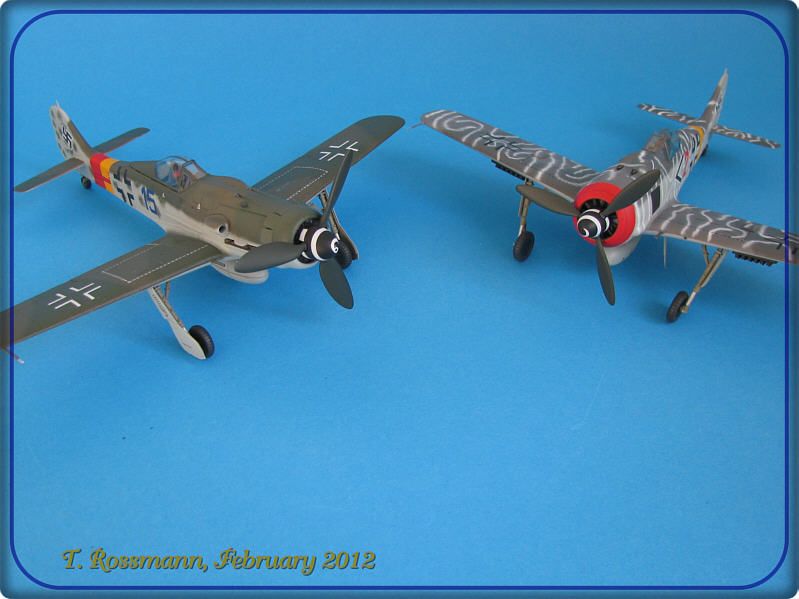

And here are my 2 newbies to my Plastic Air Force together....
I say "Vielen Dank" for looking and hope you enjoyed walking around.
Happy modelling!

Russell, thanks for your comment. Yes, I'm really satisfied with my builds after all these troubles and glad, that the crash landing didn't do much damage to my "Dora". But here I see how "strong" I build my models .....

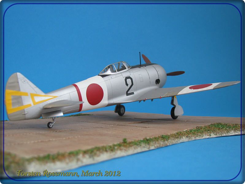

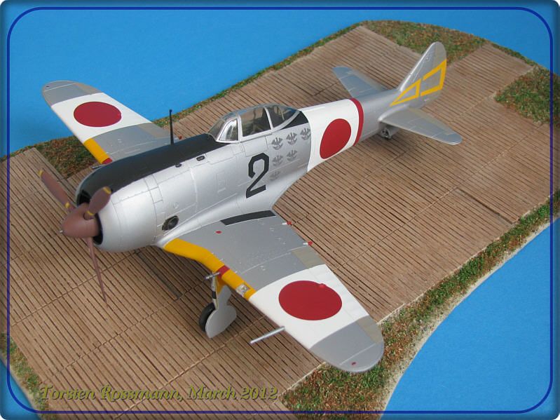

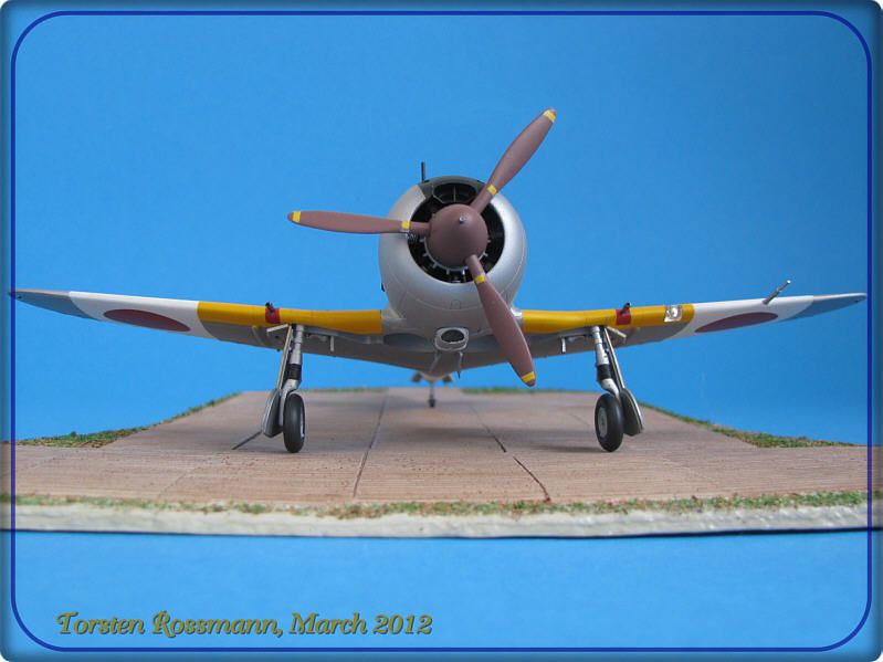

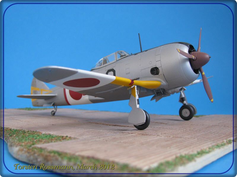

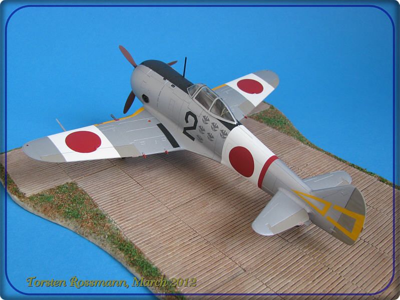

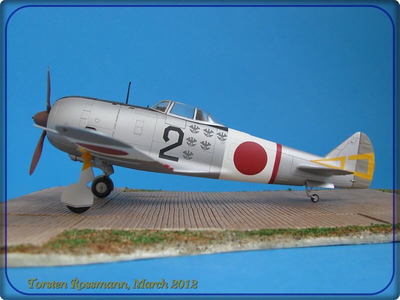

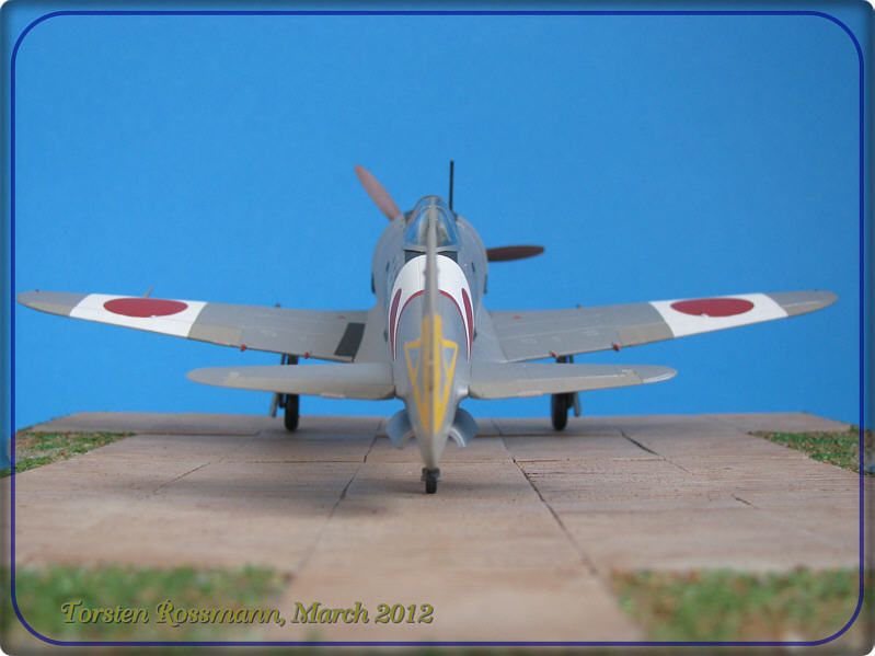

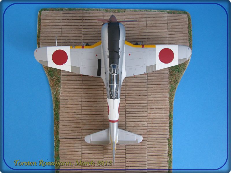

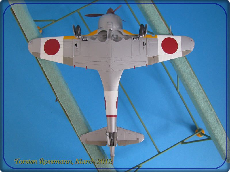

Hi folks!
Working on my new dual combo I had to concentrate on one kit first because I wanted to show it on an expo last weekend. And I finished right in time. And now I can show you my new Nakajima Ki-44 "Shoki" from Hasegawa in 1/48.
The Shoki (or "Tojo" as her allied code name was) was more or less developed simultaniously to the Ki-43 Hayabusa ("Oscar"). The wing loading of the new aircraft was high and landing speed was fast so that at first only pilots with more than 1000 flying hours were allowed to fly the Shoki. It was powered by a Nakajima Ha-109 14 cylinder radial piston engine with 1520 hp which gave the aircraft a speed of 605 km/h at 5200 meters. The maximum service ceiling was 11200 meters. The armament consisted of two 7,7 mm MG in the fuselage and two 12,7 mm MG in the wings. Later during the home defense some Ki-44 were equipped with two 40 mm canons in the wings ....
I have build an aircraft of the 70. Sentai, flown by 2Lt Makoto Ogawa in 1945. And here I can show you at least a picture of the pilot (source Osprey Publishing). Ogawa was born in 1917 and the top ace of his unit. He shot down seven B-29 and was awarded the Bukosho on 9. July 1945. In the final days of the war he added two Mustangs to his tally. Ogawa survived the war and became a businessman in Tokyo. It was not often that Japanese pilots painted kill marks on their aircrafts but Ogawa was one of them.
The kit is an older one from Hasegawa and no longer in their standard progam but every now and then they throw it on the market again as a "limited edition". The fitting is still very good, only at the famous wings/fuselage areas is some little filler needed. A bit of sanding does the rest. It's no difficult kit. The decals are taken from Eagle Strike's "Shokis of the IJAAF Part 1" sheet. Some nice versions on that one!
The whole kit is painted completly with Revell paints this time. As I had so much bad luck on my Fw 190 D-9 recently (you might remember), I used White 5 as a primer. Black is No. 302, Grey (for the fabric covered parts of the rudders)is No. 75, White is No. 301, Yellow (for the leading wing edges) is No. 310, Aluminium (for the wheel wells) is No. 99, Silver is No. 90, Dark Red (for the fuselage band) is No. 331 and the interior was painted with No. 362. Oh, and the propeller is painted with No. 83.
After two Thunderbolts in 2008 this only my third silver bird. And I have 3 more Shokis in my stash .....
I say "domo arigato" for watching and hope you enjoyed my little walk around. As always, comments and questions are welcome.
Happy modelling!

Hi Torsten.
I just picked up on your thread. Beautiful group of models and wonderful subjects. It seems you like the new look and aren't big on weathering. Still, your giving outstanding effort. Very nice, indeed.

Guy, thanks for your kind words about my models! You're right, I like them clean, factory fresh with a dozen kill marks on the rudder, so to say .... I'm not really a fan of weathering. You sure can increase the value of a model with that in a few minutes. But on the other hand you can spoil the work of weeks or months within seconds if you do too much weathering. I probably might not like my models afterwards. Instead I leave them to "natural weathering". Just put it on the shelf and wait for the dust to fall .....

Torsten! Wow! What a great looking Shoki! Super work. Thanks for sharing. Russell

Russell, thanks for your compliment about my Shoki. Yes, she's also looking fine to me.
Thanks for showing us your little Ki-44. Are the cowling flaps open there? That's not possible on the 1/48 kit. She needs to be cleaned up a bit, right? Standing in a sand .... err .... dust storm. Well, that's what I call "natural weathering".

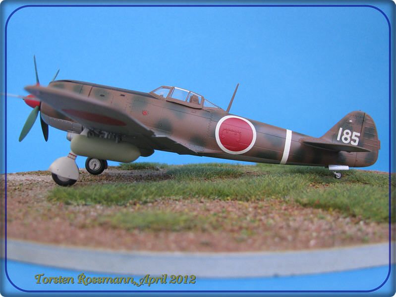

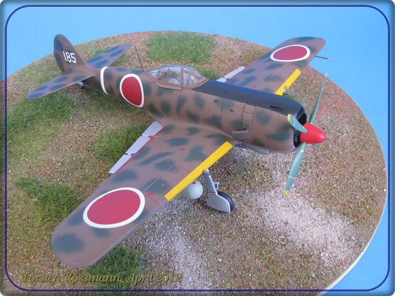

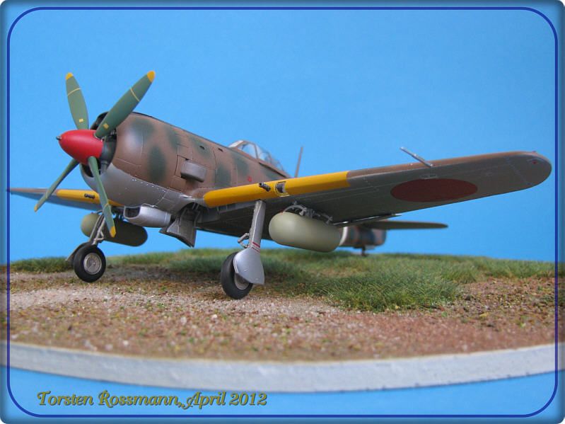

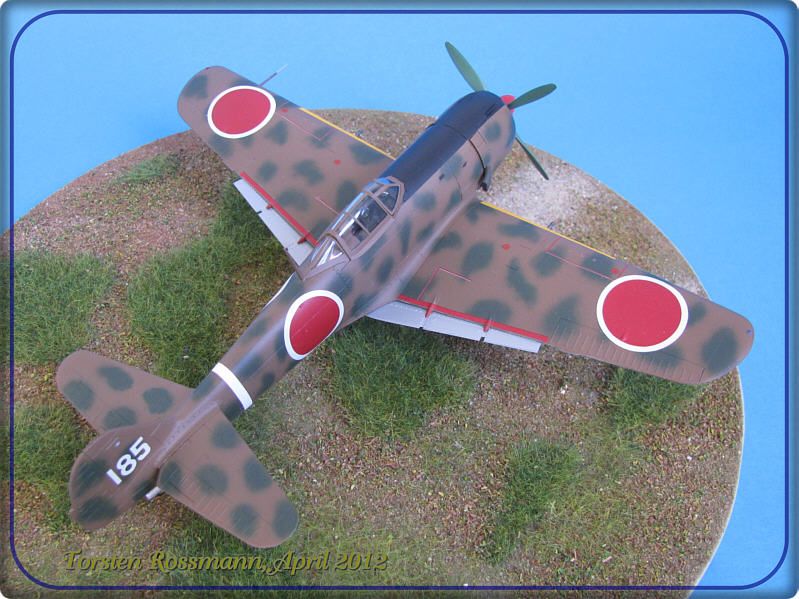

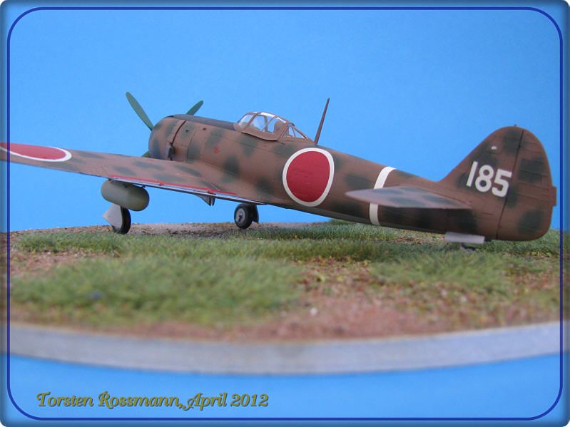

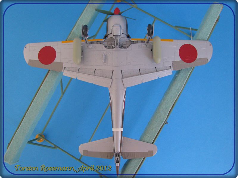

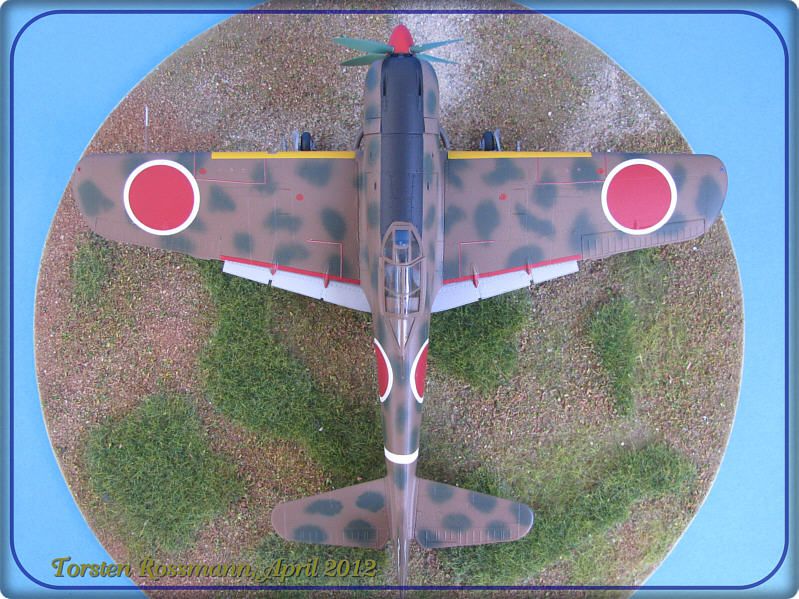

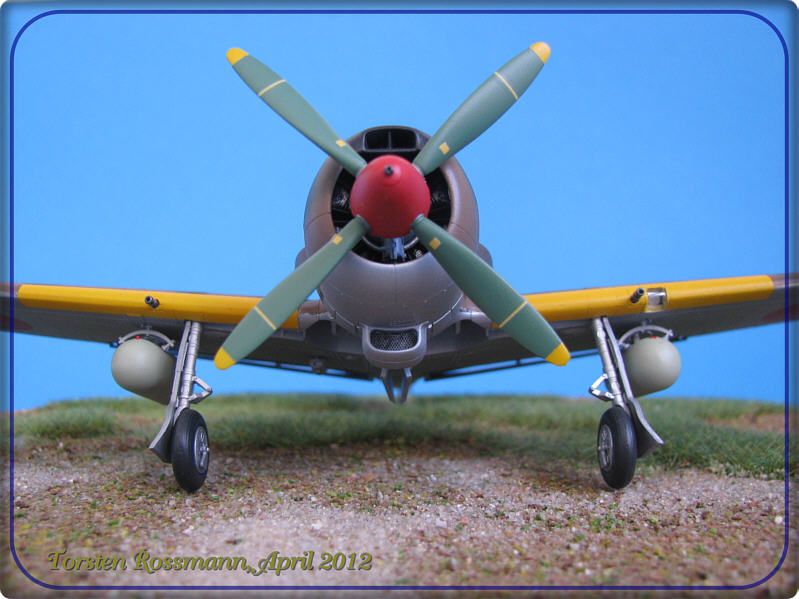

Finally yesterday I had time to take pictures of my latest model and now I can show you my new Nakajima Ki-84 Hayate from Hasegawa in 1/48. I started it simultaniously with the Shoki but I had to concentrate on one model for the expo early in March.
The Ki-84 was another famed aircraft in the Nakajima fighter line beginning with the Ki-27, Ki-43 and Ki-44. It had excellent speed, manoeuvrability, fire power and defensive armor. The engine, a Nakajima Ha 45, had 2000 hp and gave the aircraft a speed of over 600 km/h at 6500 meters. The "Frank", as her allied code name was, was used in every possible role, as fighter, as fighter bomber and even as dive bomber. The armament consisted of two 12,7 mm guns in the fuselage and two 20 mm cannons in the wings. The Hayate was the third-most produced Japanese fighter behind the A6M Zero and the Ki-43 Hayabusa with approximatly 3500 aircraft produced. Sadly only a handfull survived until today. The USA tested the Hayate and said it was the best Japanese fighter aircraft of the war.
I have build an aircraft of the 22. Sentai, flown by Major Iwasaki Jyozo in China, September 1944. Haven't found any informations about this guy yet ....
The kit is another great one from Hasegawa, which came out in 2007 as a limited edition. This aircraft is a pre-production one as you can see from the unusual big exhaust stacks. It is highly detailed - especially the cockpit - and has no fitting issues. It's really a fun build, which I highly recommend.
As with the Ki-44 here again I mostly used Revell paints. First came White 5 as a primer on it. Silver for the underside is No. 90, Aluminium for the wheel wells is No. 99, Brown for the upperside is No. 381, Black for the anti glare panel is No. 302, Red for the spinner is No. 36 and Yellow is again No. 310. The green mottling is made with thinned IJA Green from Tamiya and the external fuel tanks are painted in IJA Grey Green again from Tamiya. A bit strange to me looks the propeller which is H 319 Light Green from Gunze. But maybe the Hayates had this colour. For the canopy I used the Eduard mask EX 060. The decals look a bit thick on the paper but when they are on the model they become veeeery thin. No softener is needed as they might be destroyed. Like all my models this one is also not weathered, but I'm sure you know that already.
The first expo for this beauty will be on the Easter weekend at the Technical Museum in Speyer in southwest Germany. There's no better place to show your models sitting between all the originals.
I thank you for looking and hope you enjoyed my little trip around. I have two more Ki-84 in my stash, so there are more to come. As always, comments are welcome.
Happy modelling!

Torsten, super fantastic looking "Frank"! One of my favorite Japanese aircraft for sure. I love the camoflauge job you did on it. Russell

Russell, that camouflage was quite easy. I just thinned the IJA Green with 50 % Isopropanol (normally only 25%), adjusted low pressure on my compressor and used my medium needle (0,35 mm). For everything else I mostly use my big needle (0,50 mm).
