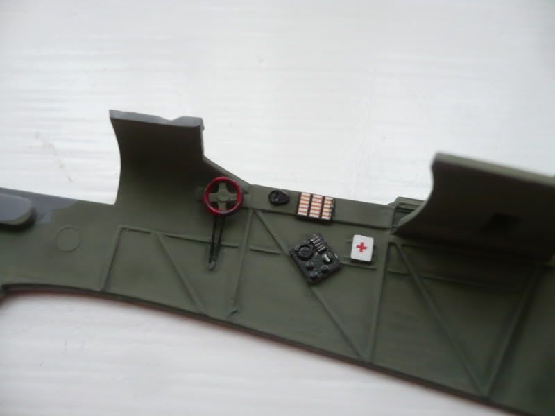

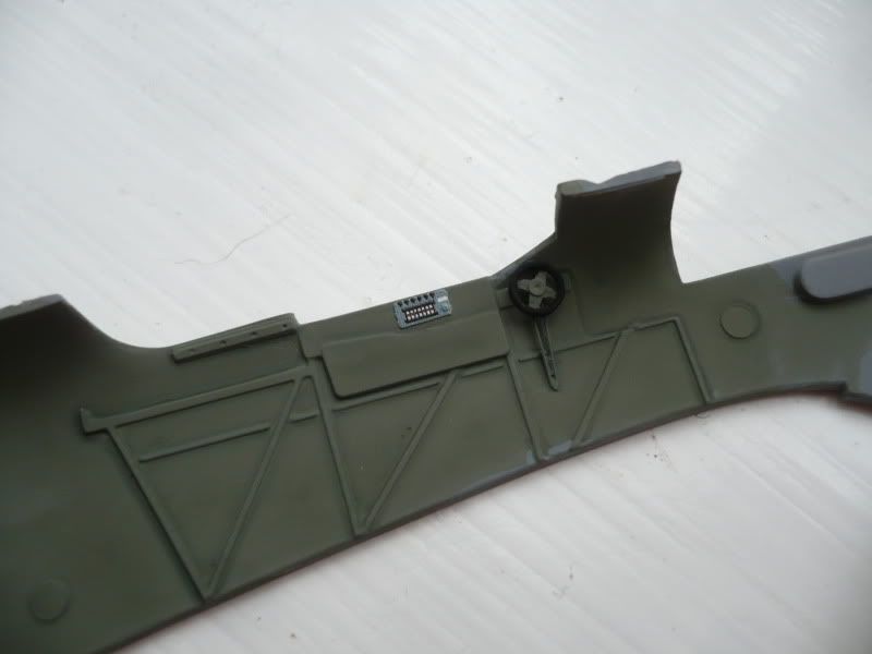

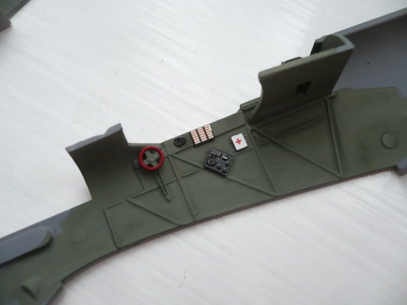

Im enjoying this one, the office is coming together nicely..
KitMaker: 6,715 posts
AeroScale: 6,011 posts
Posted: Monday, July 16, 2012 - 03:53 AM UTC
It's a really wonderful build. I think the only thing "wrong" with it is that Eduard made the oleo struts extended as if it was flying rather than sitting on the ground. IIRC you need to shorten them by a couple mm to make it sit correctly.

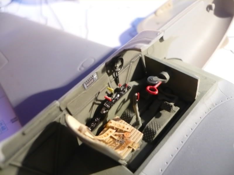

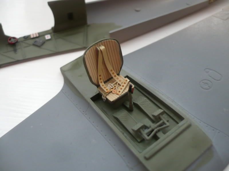

A small update, seatbelts, cushion done, and i glossed the ( trim wheel)

Posted: Thursday, July 19, 2012 - 04:12 AM UTC
Hello, James!
Very good work so far. Like the effect on the "red wheel" (sorry, don't the correct technical term). Could you share some details about pilot's seat cushion?

Dimitar, Thankyou! I am not sure on the term either or what it's for!, i think it may be a trim wheel. ?? the seat top half is the kit plastic and the bottom half is the kit etch. Painted with Lifecolour ral8020 lightbraun and now washed with ochre. ! I hope that is the information you wanted!

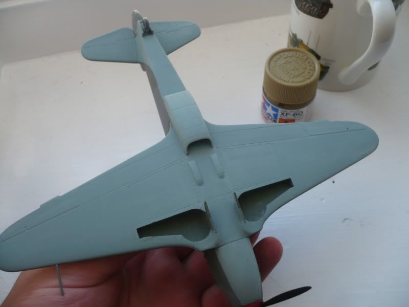

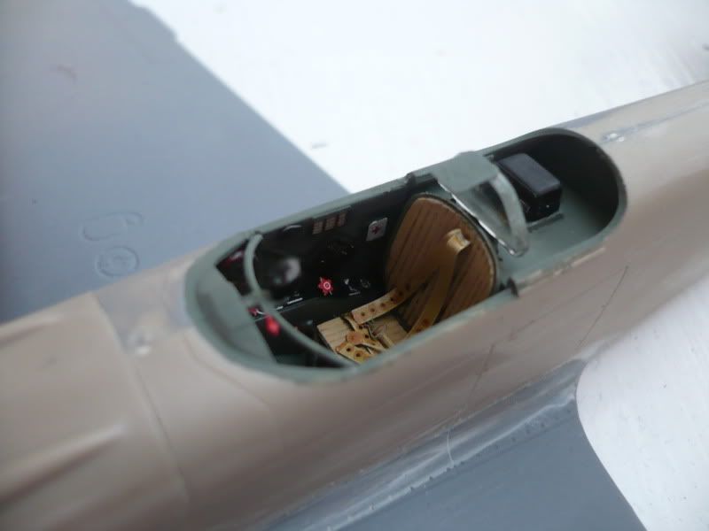

a small update here!!

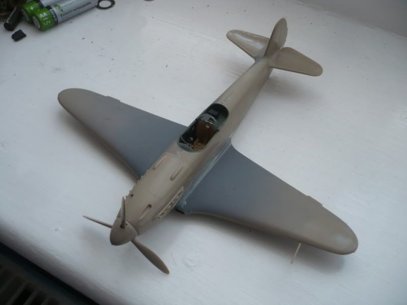

so its all sealed up now1

Looks good James!

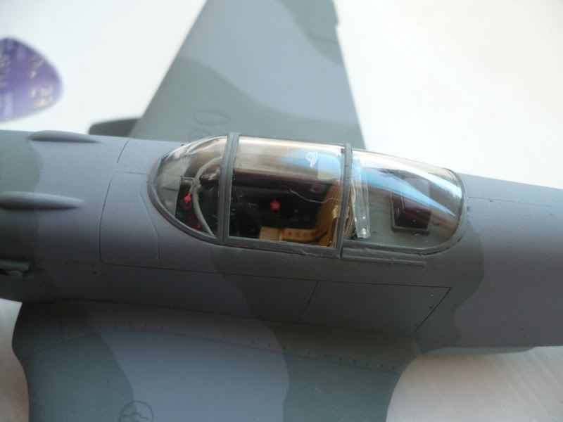

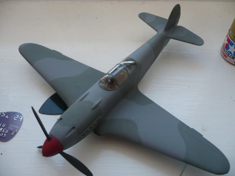

SOOO.... canopy on, masked perfect. sprayed it. and for some reason there is a BLOB of something in there.....; not happy with that, BUT im happy with how its coming along.
Posted: Wednesday, July 25, 2012 - 04:24 AM UTC
It's Gremlins. They infest models as well as real aircraft. Is it possible to carefully pop the canopy off and remove the blob?

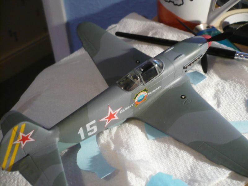

That paint job looks fantastic. Which markings do you have in mind for it? I couldn't resist the red nose.
Note how mine sits too nose-up? That's those overly long oleo stuts. I found out about the problem too late

Looks good james that random blob looks like peice of adhesive from masking tape or maybe an errant drop of canopy cement. Don't know if you use the the testor's stuff or not. I my self use 3M Tacky Glue. Chuck recomended it for PE and found it works great for canopies and windows.
I am curious about the interior colour as I could have sworn russian had a light blue interior, but not an expert. The RLM 02 looks good though. The wheels on the sidewalls are trim wheels. They are used in flight to adjust the elevators and aerolons to adjust level flight characteristics of the aircraft. So if you're trying to fly straight and level and the nose keeps climbing up you adjust the trim tabs on the evelator with the wheel and and it should make the aircraft hold the pitch for level flight.

i sorted the struts, I hope they are level!!!
Steve, thanks! I knwo nothing of Russian Ac, so the RLM was better than the " clear yellow" the instructions suggested.!!!!
i never used to use canopy glue, but bout the revell stuff. as i get on with contacta quite well, although this seems a little blobby...

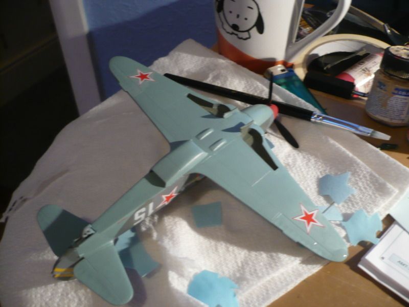

AeroScale: 369 posts
Posted: Thursday, July 26, 2012 - 08:20 AM UTC
the markings are almost complete... they need a lot of setting solution and i think my brush painted satin coat will not cover them up well
what colour should i use for chips? a darker grey?
also what sections werent metal!
J
Posted: Thursday, July 26, 2012 - 11:15 AM UTC
The wings and engine cowling panels were metal. I'm pretty sure the rest of the fuselage was plywood.
Dimitar
Sofiya, Bulgaria
Joined: November 08, 2011
KitMaker: 414 posts
AeroScale: 126 posts
Posted: Friday, July 27, 2012 - 03:49 AM UTC
The wings and engine cowling panels were metal...
Nope. It was s wooden wonder. The wartime Yak-3 is made of plywood except for engine cowling and the panels below the canopy. It was Yak-3 VK-107A with the metal wings. Even after the war has ended the remaining Yak-3 VK-105 kept their wooden wings, although changed every two years of service - and the service itself ended in 1952.

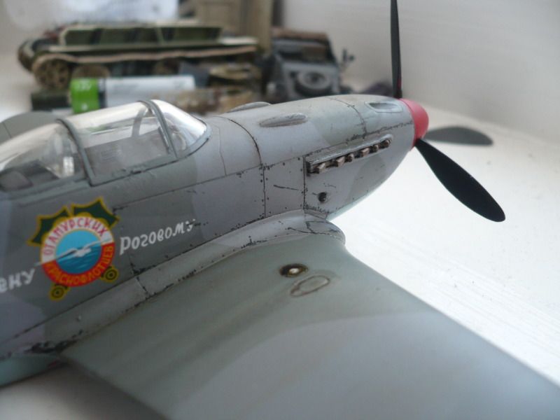

thanks for the info guys, i'll only chip items with rivets!!
weathrting WIP

You hit the right spots! Nice chipping, pretty aggressive, the way I like it! Looks like a well worn airplane.
