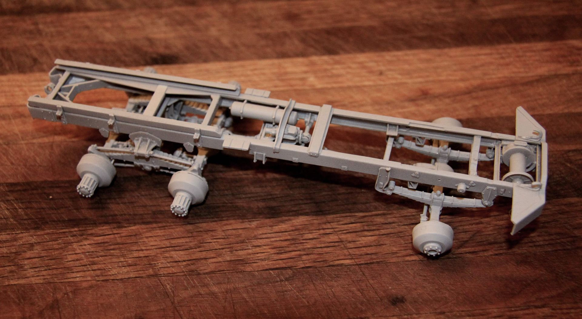

Another hiccup with the engine assembly: No locator pins of any kind between the clutch housing and the engine block. If I guessed wrong the engine is not going to set level in the frame mounts!
I figure I can shore up or cut down the engine mounting blocks to make it sit correctly in the frame but I would rather the model would give me some clue towards getting it right in the first place.

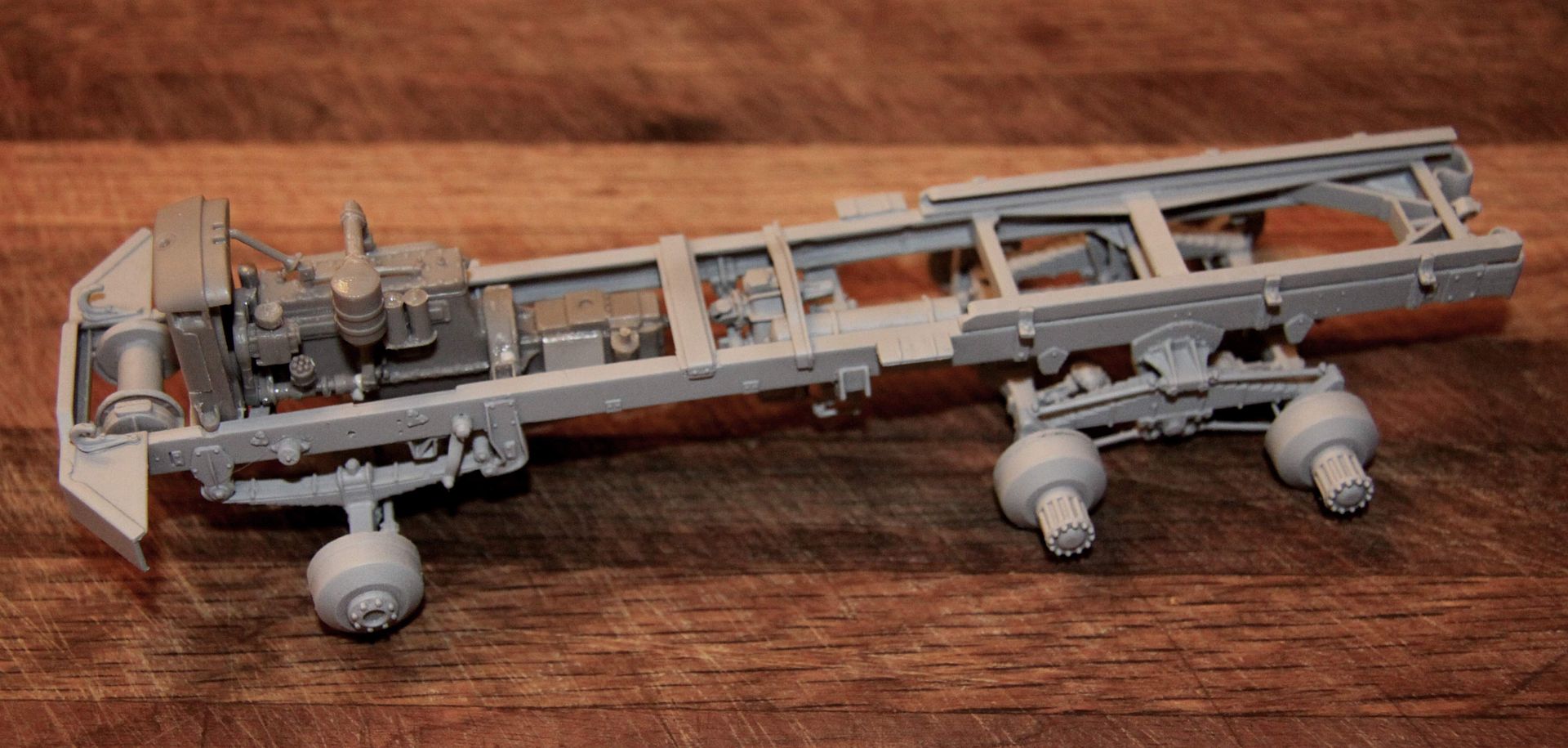

OK the wrecker builds up into a beautifully detailed kit, I totally admit this, but . . .
It is a pain to build!
Something that has not been mentioned before is the formulation of the plastic used to mold the kit. Rather a brittle mix. The very large sprue gates often leave almost unavoidable craters in the edges of the parts (even while taking the greatest of care) and the hard plastic is very difficult/impossible to smooth out in these areas even with my best files. This is a totally new problem I have never encountered before.
I assume the brittle plastic was used to produce a more "chrisp" result of molding detail however even the Tamiya solvent recommended by Mirror seems to barely attack this plastic! I have lost track of how many two part assemblies I have put together and let dry overnight only to come back the next day and have these same parts fall apart in my hands as I try to do my finish clean up before adding them to the model.
And yes, I am coating both parts with the solvent then waiting a moment (for the plastic in theory to soften) and then clamping them together while they dry overnight.
Last night the sidewalls of the load box again fell apart - for the second time - as I tried to clean them up for final assembly.
I am sure I will be accused of being inexperienced but I have been modeling non-stop since the late 1950's and this is just not the case!
But again - to finally have a model of the Diamond T wrecker the results are worth the pain.
Just know in advance that glue wise, this kit goes together more like a white metal model than anything you have ever experienced in plastic.
Building this model you need to be ready, because you are in for a long, hard pull!

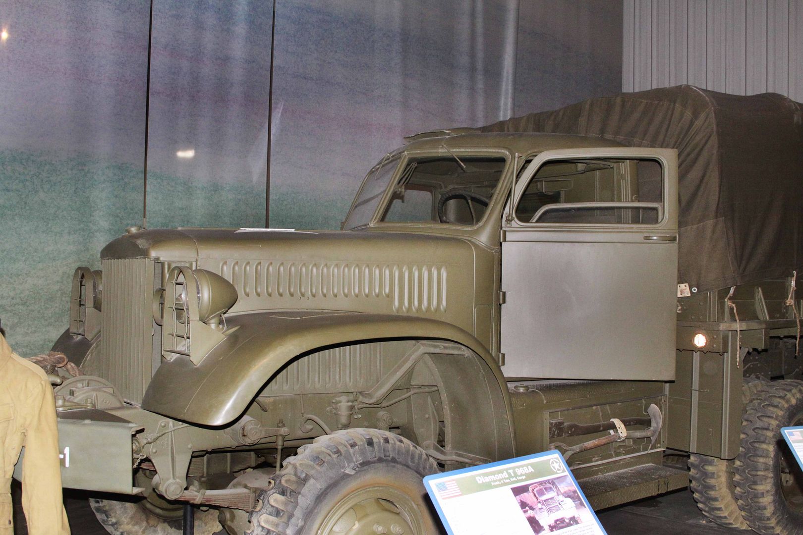

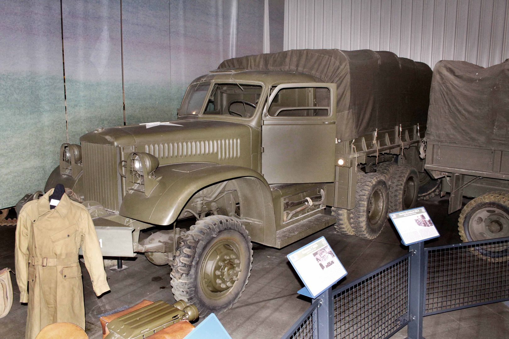

4 ton Diamond T cargo truck as seen at the Victory Museum, Auburn, IN.
(All photos Mike Koenig)
Interesting; Note the framed side window glass but no wing windows on the door glass. I guess with four cab ventilators they figured they didn't need wing windows.

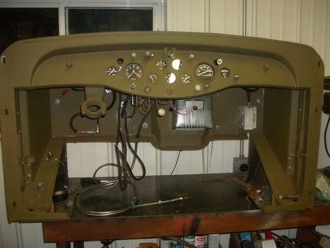

Posted: Saturday, June 28, 2014 - 02:55 AM UTC
Interesting detail photo on the Diamond T found online. (Source unknown)

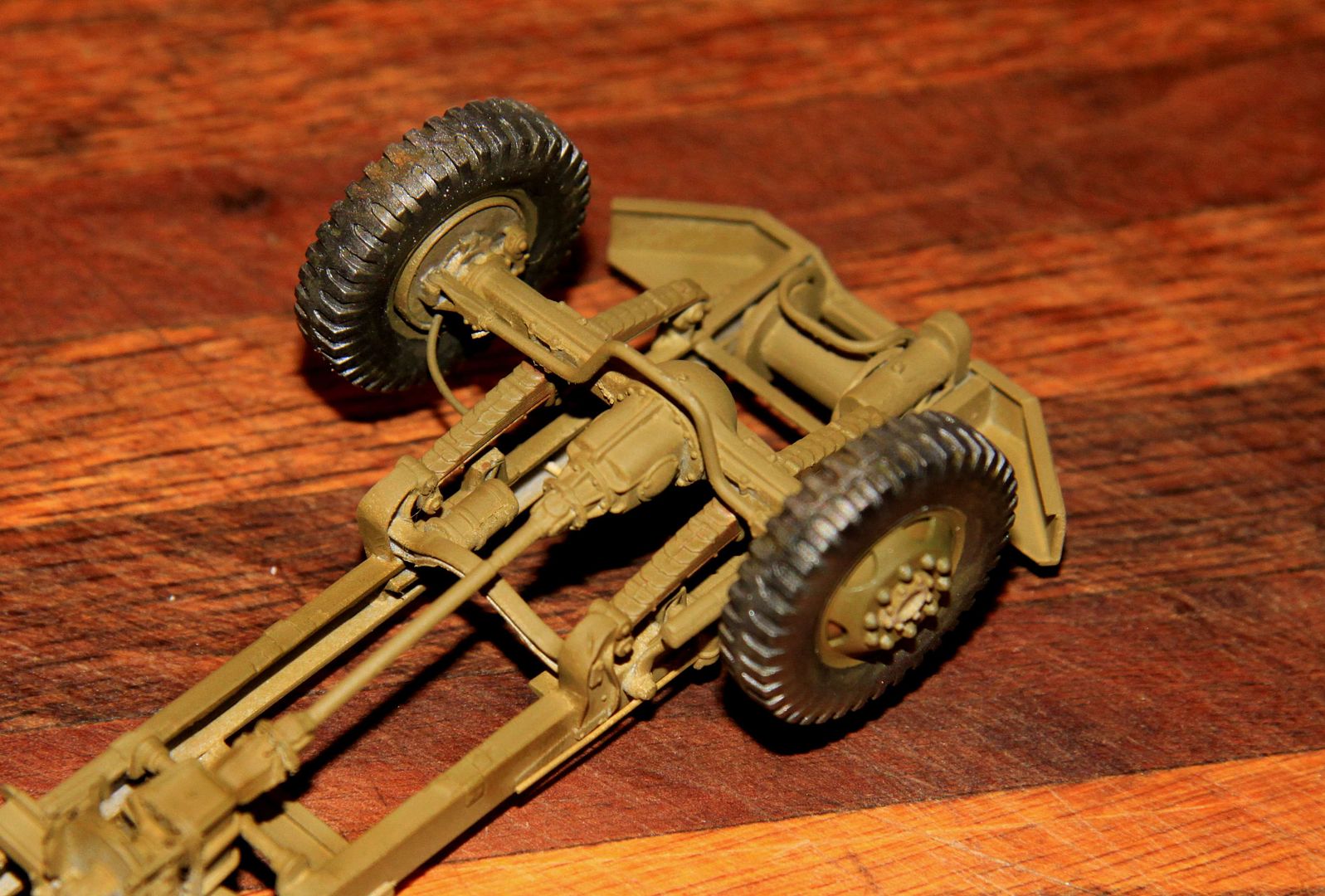

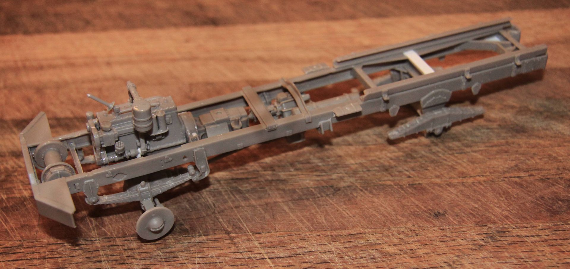

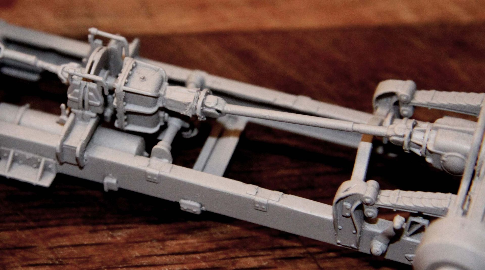

Emergency brake and transfer case assembly.
KitMaker: 9,112 posts
AeroScale: 374 posts
Posted: Sunday, June 29, 2014 - 01:10 PM UTC
Beautiful engineering.

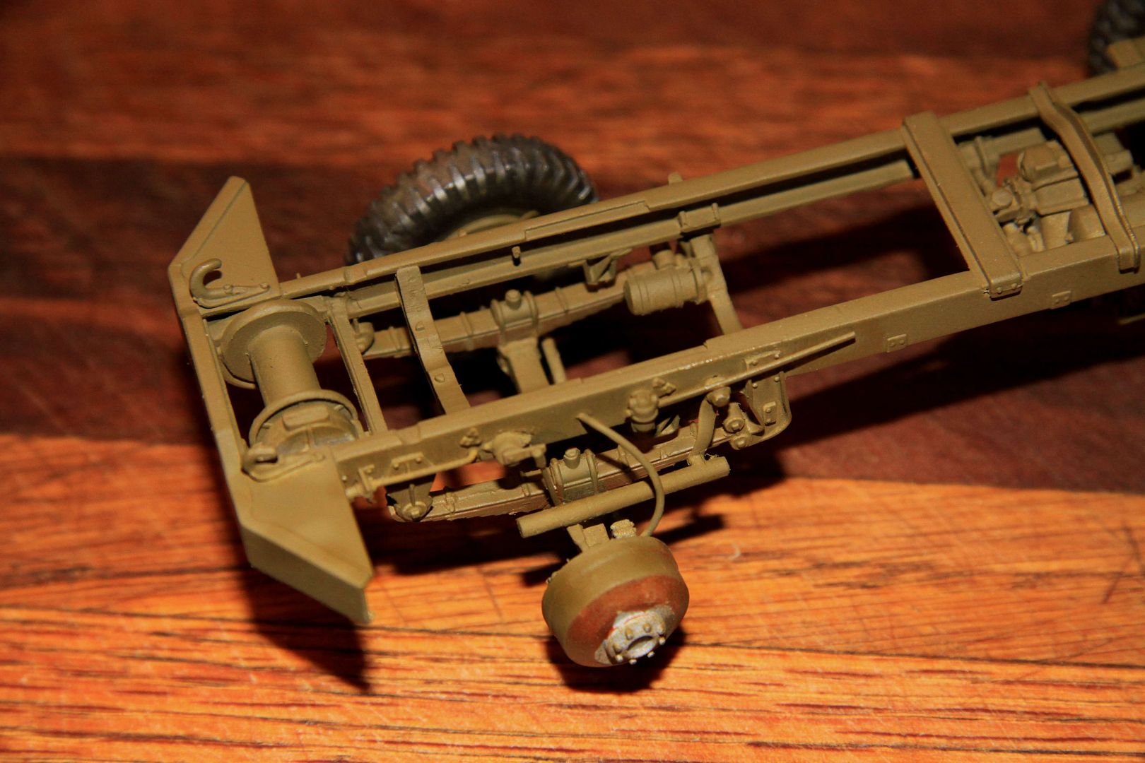

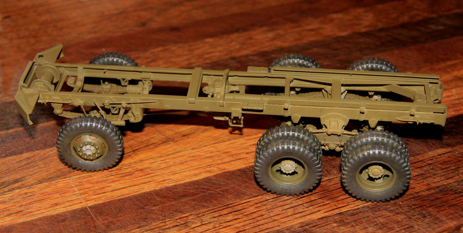

Inital coat of paint on the frame - almost don't want to finish the rest of the vehicle, the frame is so well engineered and detailed I hate to hide it!
I did fine a few extra details to add: the brake hoses to the front wheel drums, the fuel line from the gas tank to the fuel filter and the air lines to all four air brake "Glad Hand" connectors.
Also added the lower flange to the bottom edge of the front bumper.

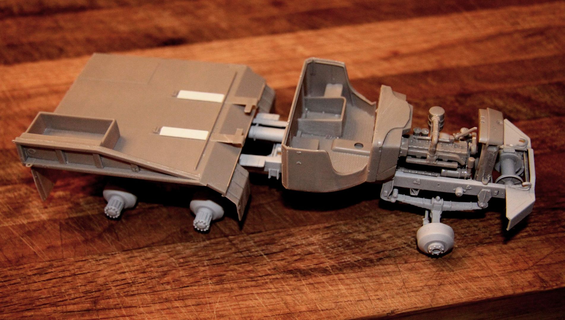

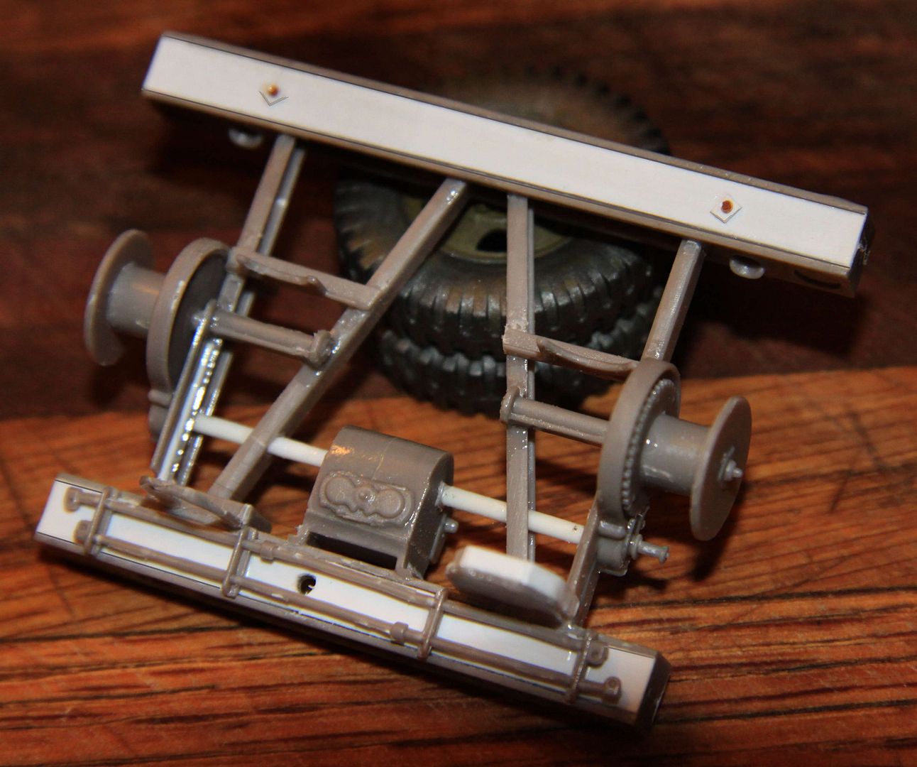

Progress on the main Holmes supplied truss for the Diamond T wrecker:
The white plastic is to cover up the very visible horizontal seams in the top and bottom "I" beams. These seams should not be present on the model.
Much more detail yet to add.
