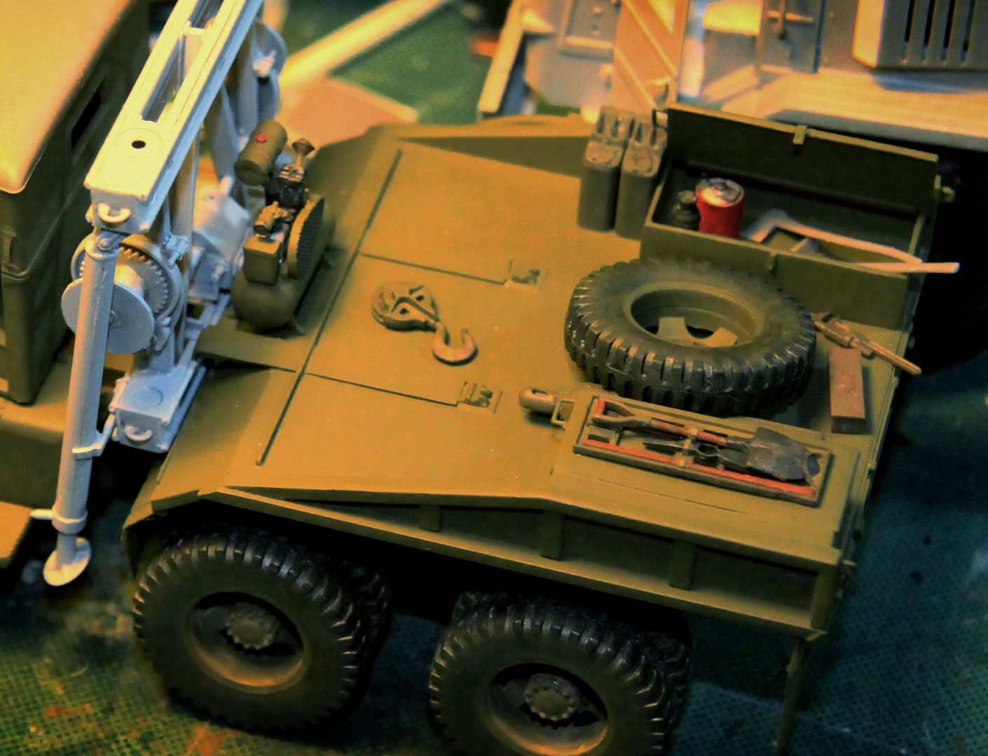

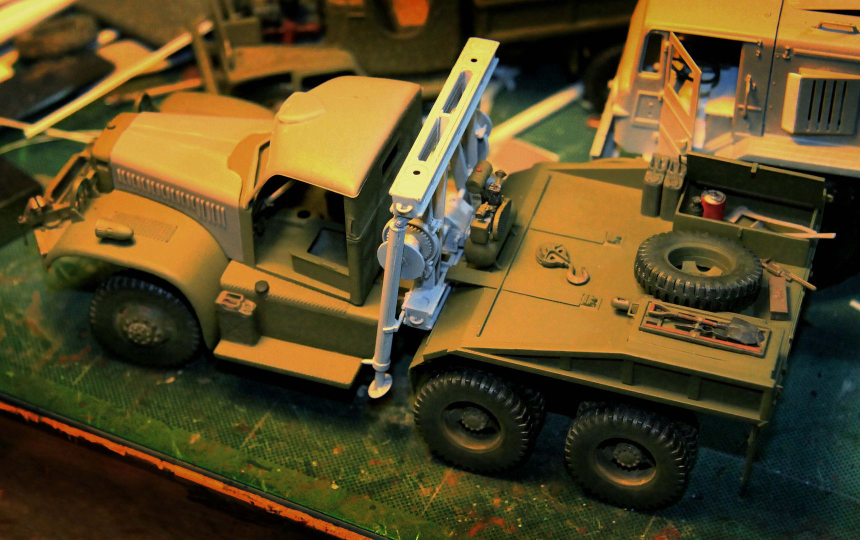

A little bit more work accomplished last night:

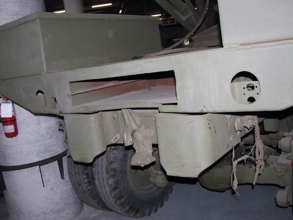

Interesting angle on some detail reference for the load bed:

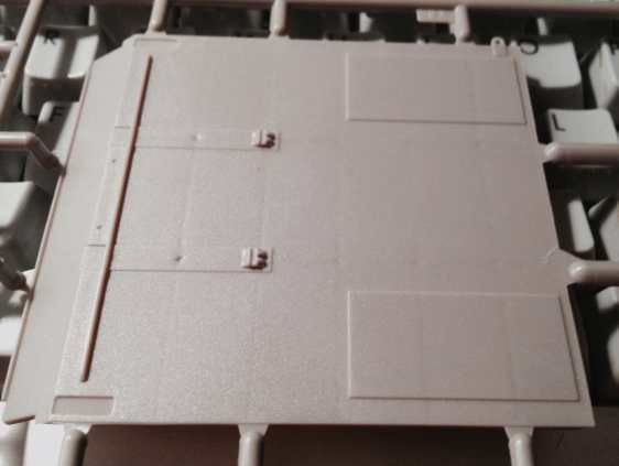

I want to comment on a criticism that has popped up several times regarding sink marks on the Diamond T wrecker. The inference is that there are a lot of sink marks on the kit when in reality there is only one piece that suffers this problem but it is in a highly visible location so the problem needs be dealt with during construction.
The flat rear load deck of the wrecker has a number of sink marks due to the underside of the deck having some heavy support ribs molded into it as one single large part.
Photo by Brian Crowley
The marks in the main part of the deck are minor and can be easily taken care of with some judicious sanding block work and a final coat of matte OD paint to cover any flaws. (Of course you WILL want to add additional tools, etc. which will cover the area even more!)

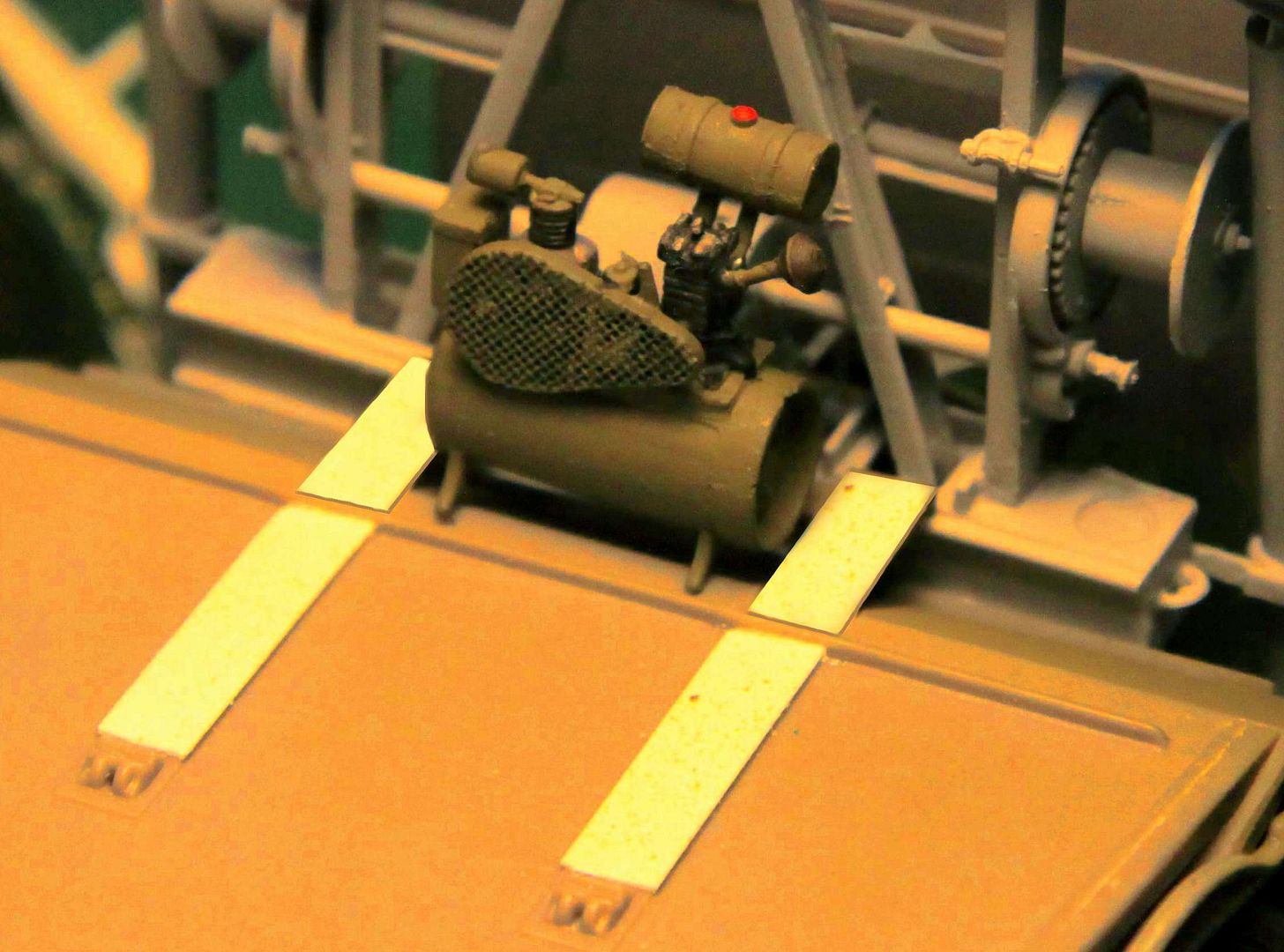

However the two most major sink marks are in the two nearly flush metal beams set in the deck right under the inverted A frame of the boom structure. These can easily be taken care of with the addition of some thin Evergreen stock. The strip stock will cover up the sink marks and also add some additional 3D quality to the deck floor.
Problem solved with very little additional work!
