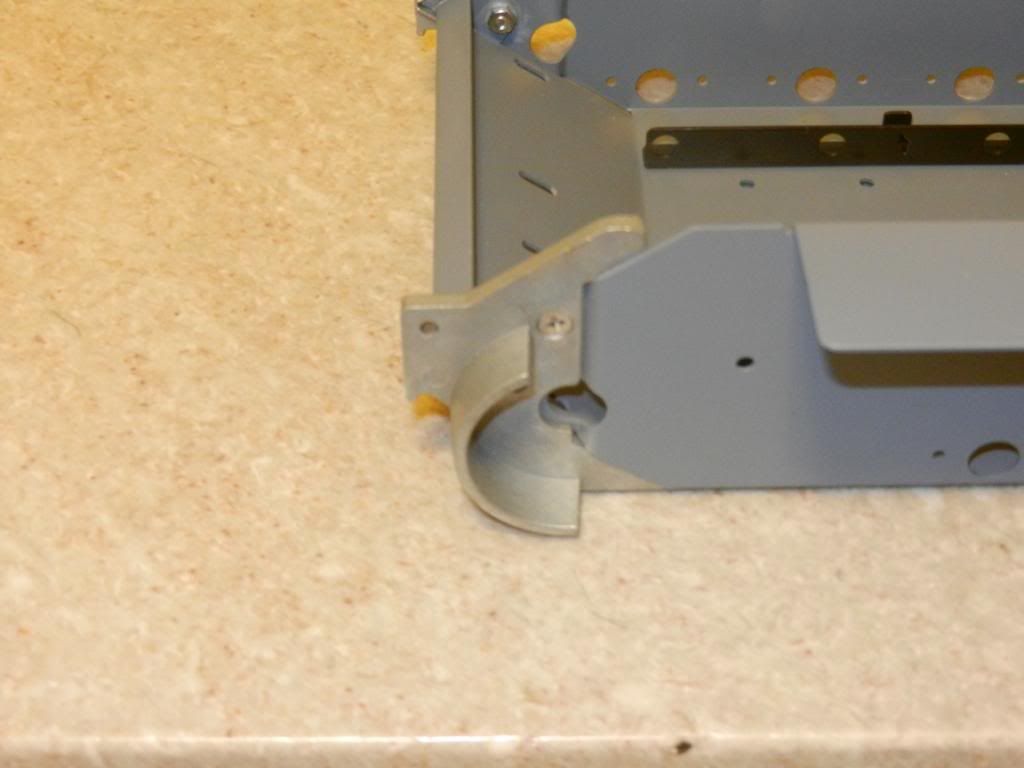

I'm just getting started on my first RC tank, the Tamiya Panther G in 1/16 scale. I thought I'd start up a log just in case anyone else was contemplating this kit and wanted to see how it went together.
I'm not planning a lot of detail work on this since it will be bashing around outdoors come spring, but there will be some add-ons where they make sense.

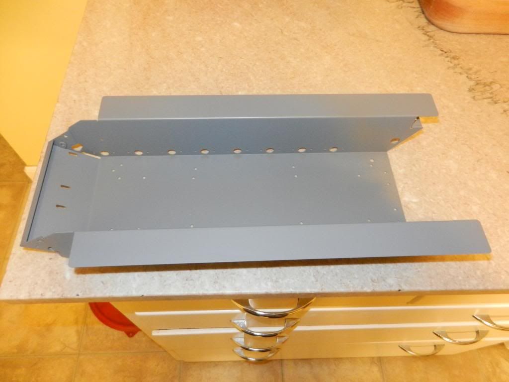

Starting off, I painted the bare chassis with a gray metal primer after giving it a wash. The rear looks light because I stopped in order to get the next two pieces installed.

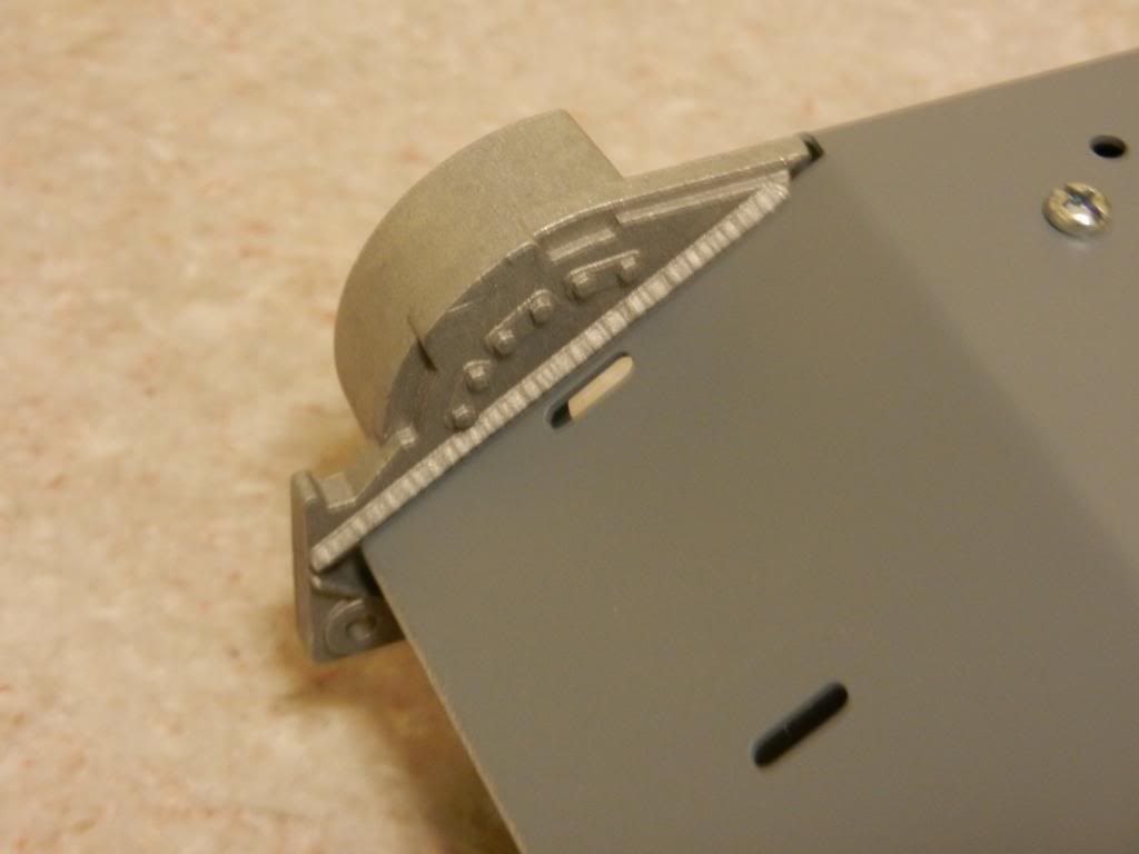

In the next two shots, you can see the first add-on - a pair of Impact Upgrades sprocket wheel guides. These add some rigidity to the front of the hull and add some weld bead detail and a nice texture.
Finally, I installed the torsion bar stays before I realized that the vertical tabs need to be cut off for the Impact torsion bar system, so more on that next time!
