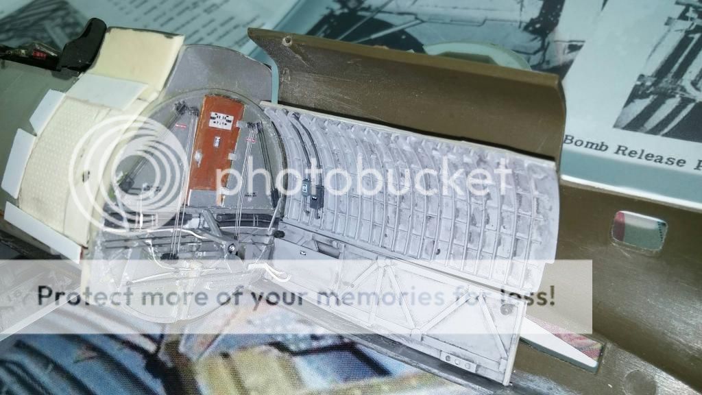

BOMB BAY SIDE BULKHEADS UNDERWAY
There is a lot to be annoyed about in this pic
which shows the first efforts to integtrate the side bulkheads into the kit. I will tone down some of the black wash, which is excessive. Only the forward part of the lower side bulkhead is actually glued in. When I finish work on the upper part, wires, cables, etc. I will glue that it too, forward. Gluing the after parts in must await careful positioning of the rear bulkhead.
I am EXTREMELY conscious of the lash-up nature of this build. The hassles of trying to integrate all these aftermarket components and scratch built assemblies into a fuselage shell that doesn't always cooperate means that I have to really think about what I'm doing, step by step. Right now all I see is a mess. Who knows whether it will look OK when I'm done? What a nightmare!
One positive note: on the top of the catwalk I added a railroad lens for the light. Looks better than the dried white glue that was there.

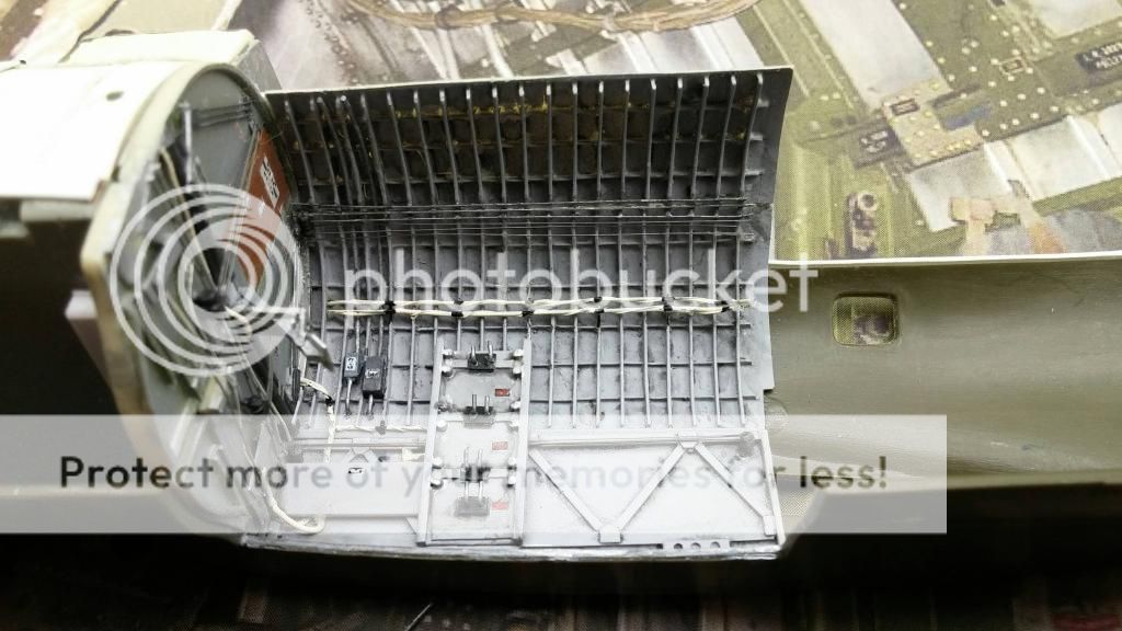

Posted: Sunday, December 07, 2014 - 06:44 AM UTC

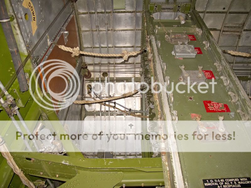

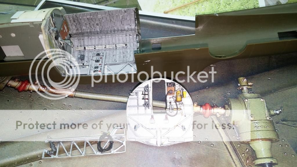

BOMB BAY - AT A SNAIL'S PACE

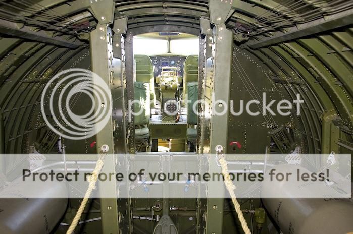

OK, so I glued the stbd sidewall in up to the ceiling and started detailing around the electrical junction panel stbd. lower left, forward.
The knurled effect of the white wiring from the fwd. blkd. comes from twisting small wire around a larger strand and then painting it the cream white I'm using. Definitely created the impression of multiple strands.
I will string some electrical wire fore and aft 2/3 the way up the bulkhead as you can see in the below two "real thing" pics.
With agonizing [well, that's too strong, say "frustrating"] slowness the details are beginning to come together here.
Below you can see the stbd bulkhead with the outer bomb rack placed. Note control cables running behind it fore and aft. Obviously the bomb rack needs to be weathered and there are wires and other do-dads to add, maybe.
One thing I point out in these resin parts from the Czech "Detail Model" house where I got the bomb bay is the annoying resin beads that appear frequently in the corners and that have to be cut out with a #11 blade. It's easy to overlook some, as I did here. It is no exaggeration to say that I have probably popped out 150 of these buggers from the bomb-bay set so far, especially in the side bulkheads.
I suspect that the bomb bay is the dirtiest space I have made in the build so far. I am going to try and make the radio room cleaner, though still worn looking.
As "Bartles & Jaymes" would say lo those many years ago: "Thank you for your support."

Posted: Monday, December 08, 2014 - 12:36 AM UTC
Brian,
The continued cabling really adds to the overall effect. The ref pics continue to help neophytes like me understand what and how you're doing.
I try to look closely at your work pics, but I missed those nubs. Just thought that they were large weld marks.

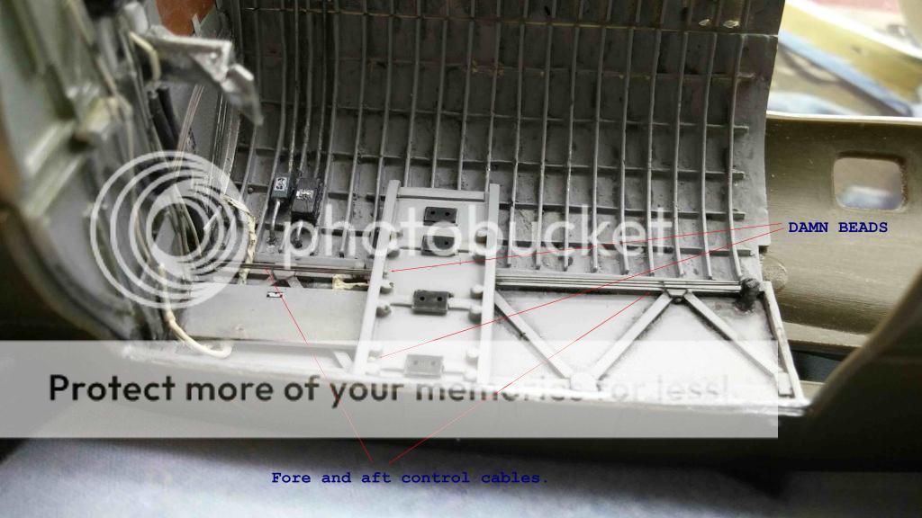

Posted: Saturday, December 13, 2014 - 04:12 AM UTC
STILL AT A SNAIL's PACE
But at least I'm working on it. Here is some additional wiring to the back of the stbd. outer bomb rack and the rack itself glued in, with some extra details added.
I will do more work on this tonight and tomorrow, including a clean up of the bomb rack weathering (a bit); completion of fore and aft wiring on the stbd. bulkhead and installation of fore and aft control cables in the ceiling. I also expect to put a spotlight in the ceiling. Finally, I will complete the stbd front bulkhead by installing the right side bomb bay door opening mechanism.

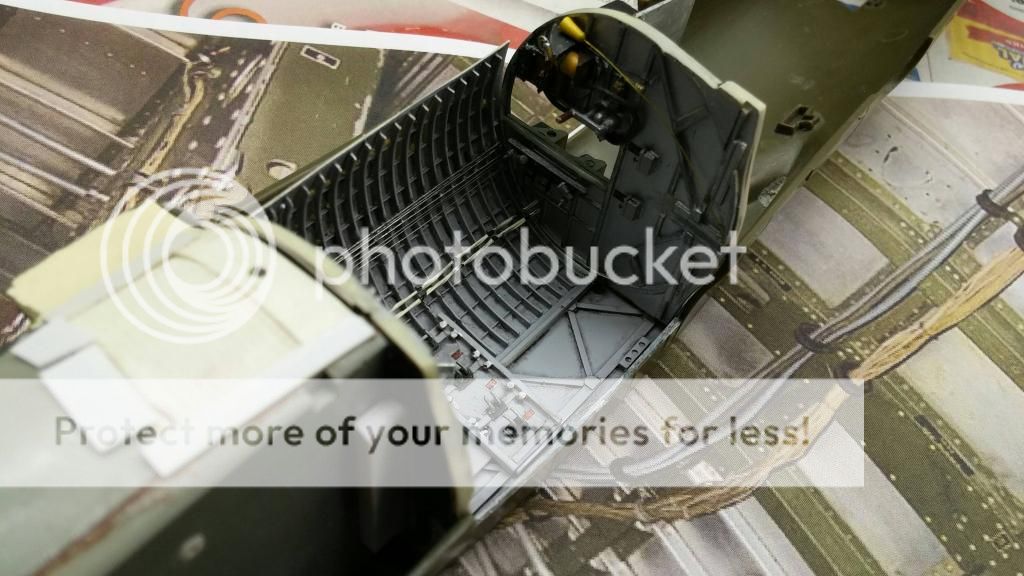

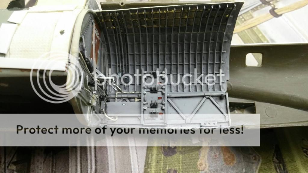

Posted: Wednesday, December 17, 2014 - 09:12 AM UTC

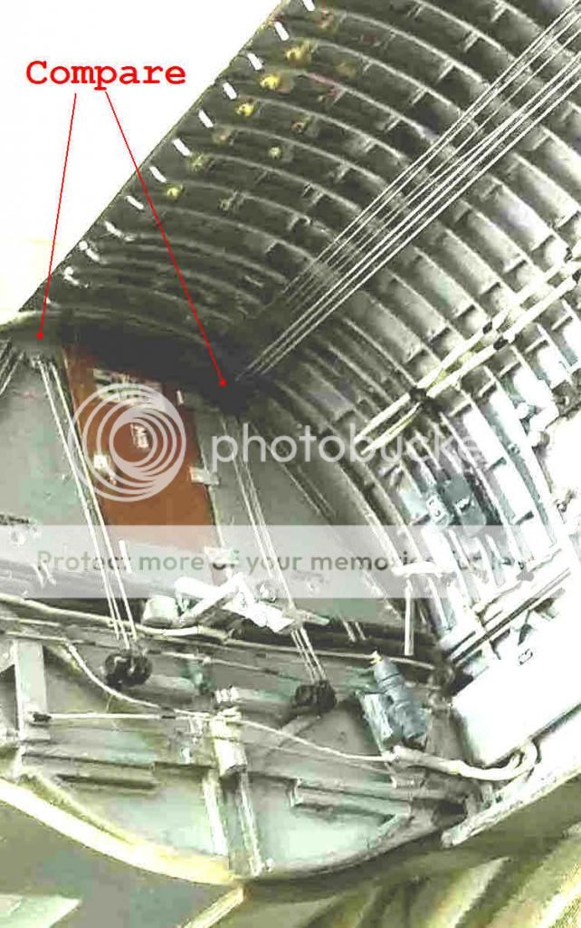

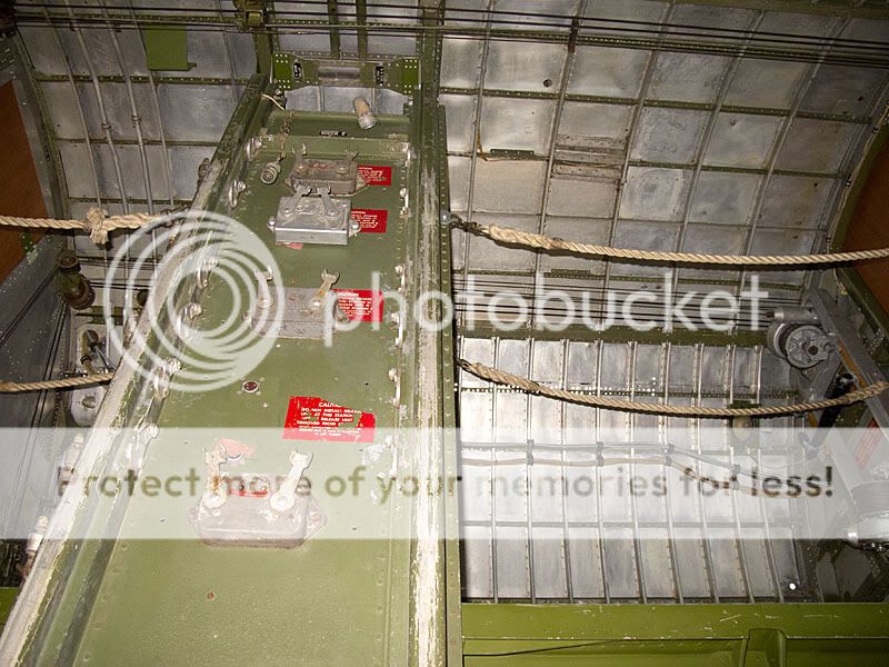

MORE BOMB BAY WIRES AND CABLES
I think I am close to finished with the starboard side wiring and cabling of the bomb bay.
The loose ends of the white wires aft will have to be fit into a couple of holes I drilled into the after bulkhead.
As for the control cables in the ceiling, I show them warts and all.
They proved to be a real pain to install. I used two diameters of wire, because that is what appears in the real thing, but getting them to align was a fiddly nightmare. See above.
I take some consolation from the fact that they do not align perfectly in the real thing
But, I will probably continue poking around with a #11 blade to "clean them up" a bit and I think I'm going to paint them a darker hue. At this point they are close to being "good enough," especially given their limited visibility in the model, and it is time to move on. Just a bit more messing with these, I hope!
I have to do a double-check to see if anything else needs to be added to the rear bulkhead. If not, it's almost time to do THIS:
though before I do I will install something to represent the ball screw actuators
at least in the starboard bulkheads fore and aft. Since the transmissions for these actuators rest under the catwalk fore and aft I will save the actual connecting rods for later, when the catwalk is installed. That's going to prove tricky.

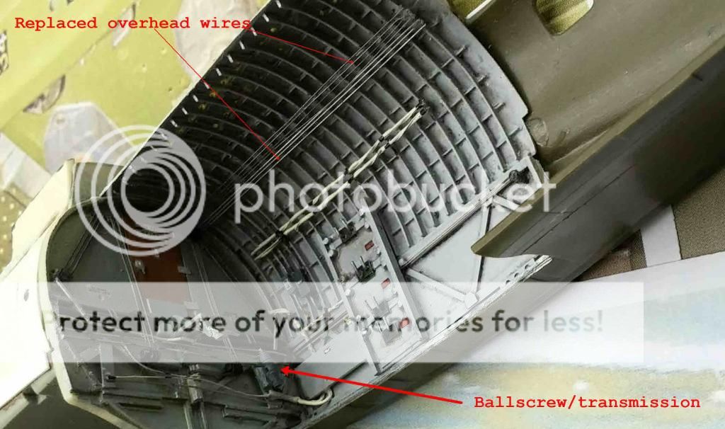

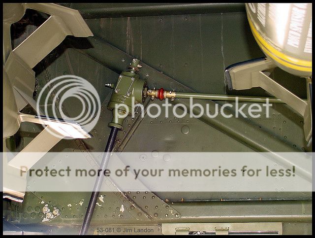

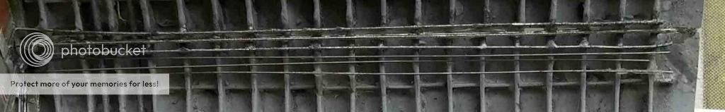

Posted: Sunday, December 21, 2014 - 06:36 AM UTC
WHY IS HE SHOWING THE SAME DAMN STUFF?
First, I ripped out the overhead bomb-bay cables, and reinstalled them, with cable pulleys at the top. Then, after a lot of measuring and messing around, I installed my first simulated ballscrew transmission in the forward bulkhead. See below:
This is SLOW going folks. Real Once in a Lifetime "You may ask yourself, 'Well, how did I get here?'" and "You may say to yourself, 'My God, What Have I Done?!'" stuff.
Anyway, here is a shot showing the control cable pully location before and after. You can't see much except that there IS something that was added. I should have better shots of it later.
I have to repeat the ballscrew/transmission installations aft on both sides, then I may be in a position to glue the after bulkhead in. After that I will probably put in overhead spotlights aft and then the catwalk.
Then I will have the fun of repeating all this on the port side!

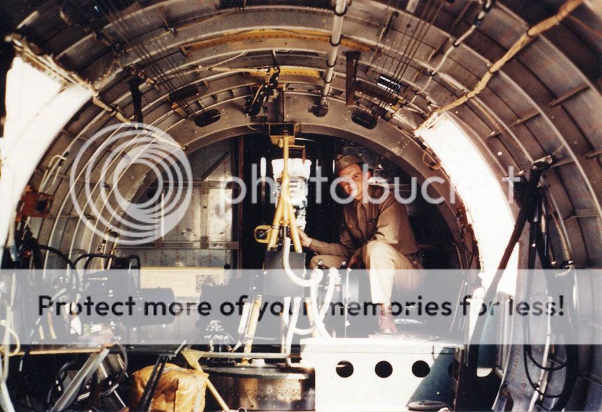

As to the H2X, here's what it looked like inside where the ball turret was. A pretty rare pic.

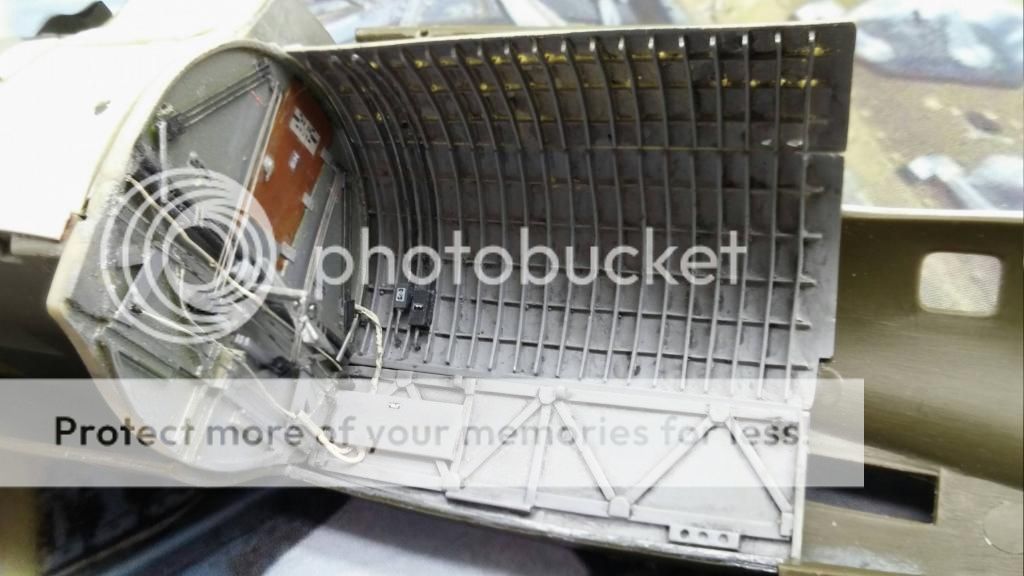

Posted: Friday, December 26, 2014 - 12:37 AM UTC
ALMOST READY FOR SOMETHING BIG
This shows the after bomb-bay bulkhead with ball screw transmissions attached. I cut down the "version" used in the prior post to make them look more like the real thing, as you can see, comparing my grey "thingee" to the real transmission painted green off to the right.
After a bit more cleanup, and installing a scratchbuilt fuel transfer pump (another plastic thingee, really) under the forward catwalk step, I really will be in a position to glue that after bulkhead in and install the catwalk. THAT will be a milestone in this build.
