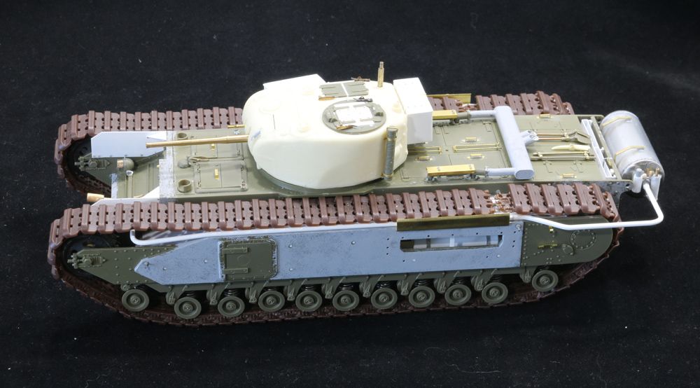

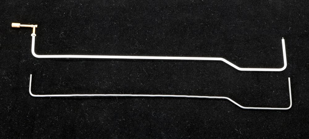

Posted: Monday, February 08, 2016 - 11:45 AM UTC
Another option is plastic coated steel wire. Comes in various sizes and is easy to bend. Used this material for a recent Churchill build to recreate the external fuel pipe.
After making a template using lead wire, I copied the shape with the plastic coated wire...
