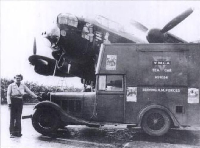

This is the only picture i've found to date of ME554's nose. Sadly it is a better reference for the van carrying refreshments ! (which in itself is a valuable bit of historical interest)
Helped by an small anecdote at the end of Iveson's book, you can make out the captain on the right and Eric holding a bomb on the left (asking 'Now?') as suggested by his stripy shirt as shown in this strip. (don't ask me what the context is!!!!)
I'm unsure what it is between the characters. Looks more like text to me but could be mission markings.

Hey, thanks for posting the pic of the real thing. Yes, you have quite a challenge here reconstructing the nose art. "Now" above Eric is as good a guess as any. At for the middle, looks like script in red on top followed by three rows of bombs.
I would approach the nose art like an antiquarian trying to make educated guesses about the missing parts of a Roman mosaic. Past a certain point, who's going to say your interpretation is wrong?
I also like the ground vehicle. In my B-17 build, I find myself increasingly attracted to the ground support vehicles as separate historic objects too.
