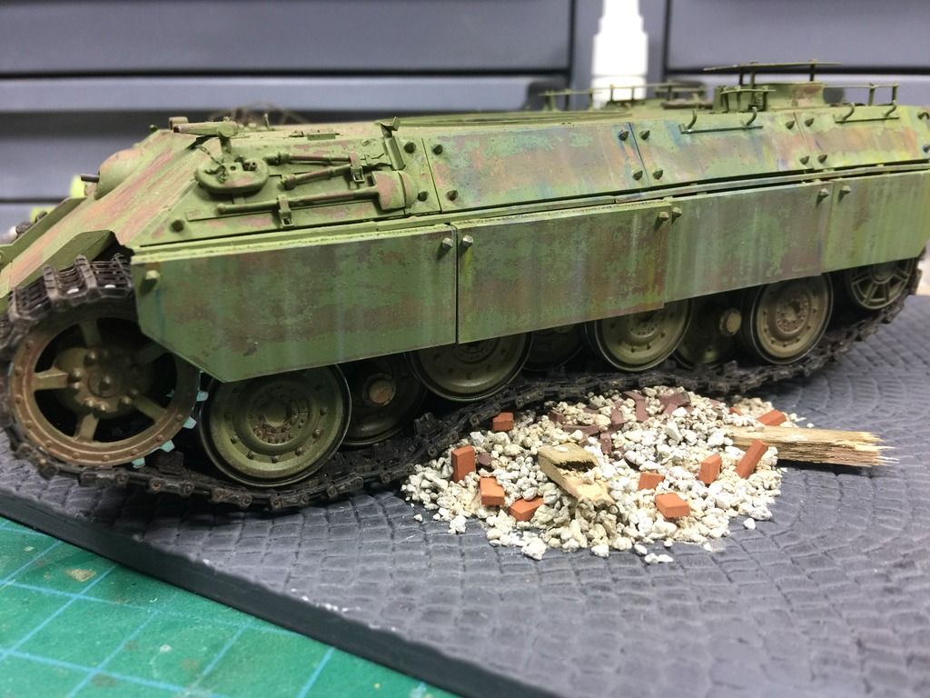

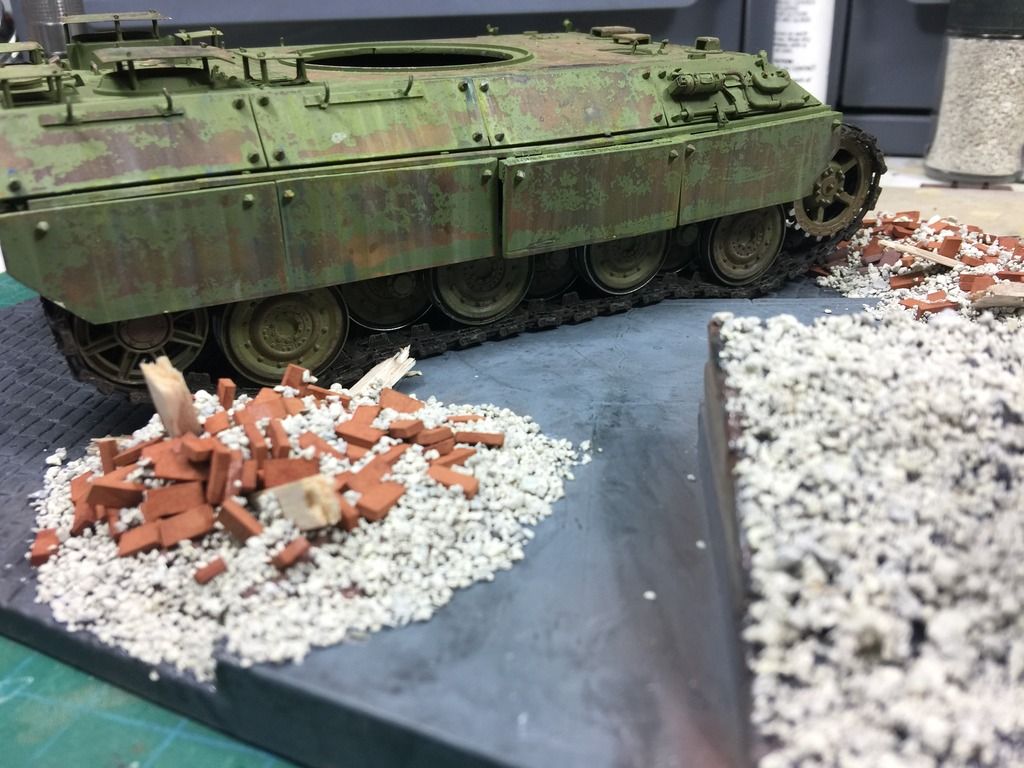

Finally got some time to work on the articulated suspension and groundwork started. Because of the articulated suspension and the fixed heavy armored skirts, the groundwork has to be done first to make sure the suspension matches it. Once that's done, the tracks can be fitted, then the upper hull attached to the lower. The sidewalk side of the suspension was done first. The swing arms lock in to the lower hull with a pin to keep them all level. Turns out, placing the swing arms on top of the pins makes them the right height to be level on the sidewalk. Once those were set. I figured out where I wanted the debris pile the other side was to be on to go and cut the pins off the affected swing arm points completely and leveled them to the pile while leaving the front and some of the rear swing arms in the stock, pinned position.
The groundwork is a "clay" made by Crayola called "Model Magic". It's a soft, non sticky (not so much) modelling clay like substance that is supposed to air dry in 72 hours but it was still soft after a week. Some of the bricks were made with this stuff while others were from a batch I got off eBay from Russia. Those turned out to be some type of pressed paper. The wood is just snapped up bits of balsa that'll get painted when done and the little chunks of debris is cat litter glued down with watered down white glue. The broken brick panel was made from a bit of Styrofoam. I saw the technique on a YouTube terrain makers channel. The two piles without the cat litter were just set up. Once they're dry, they'll get the litter treatment as will the rest of the road and sidewalk. The litter is still a bit damp in the picture but I also mixed a little Tamiya Buff in the glue mix to see how the color would look when dry.

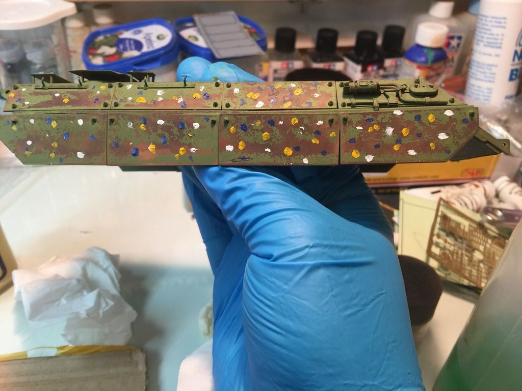

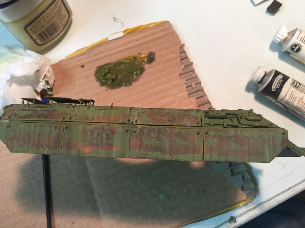

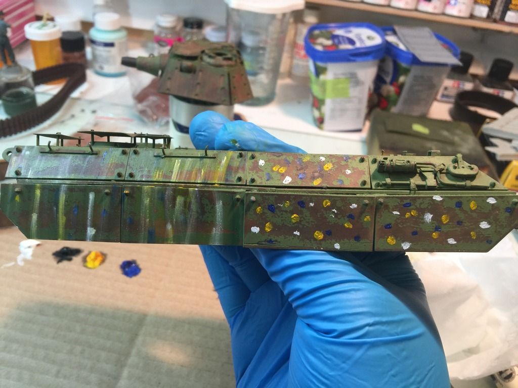

Moving on, Did dot filtering on the hull sides using white, yellow, blue and green artist oils and a wide flat brush dampened with paint thinner. Just drag it down and off until I got the effect I wanted. When dry, I'll seal and then do the same with a rust dot filter.

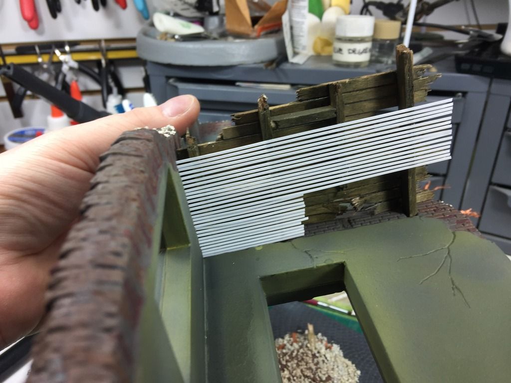

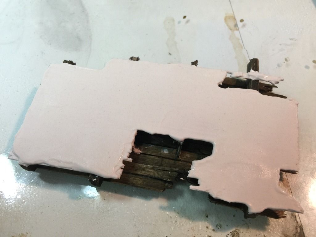

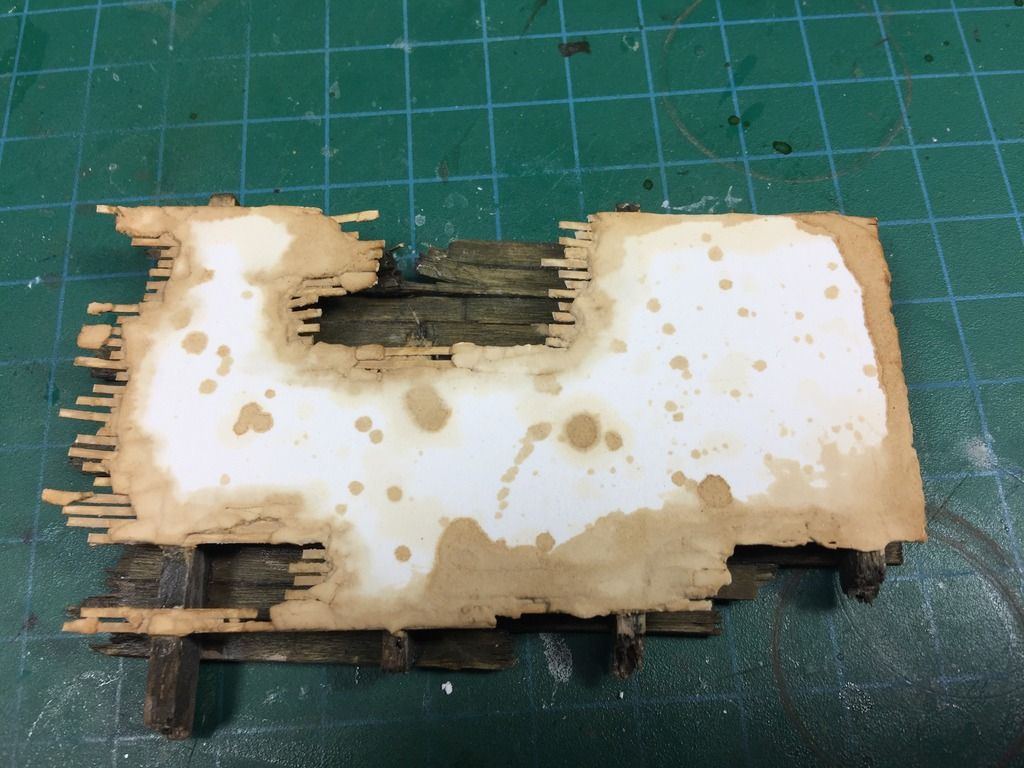

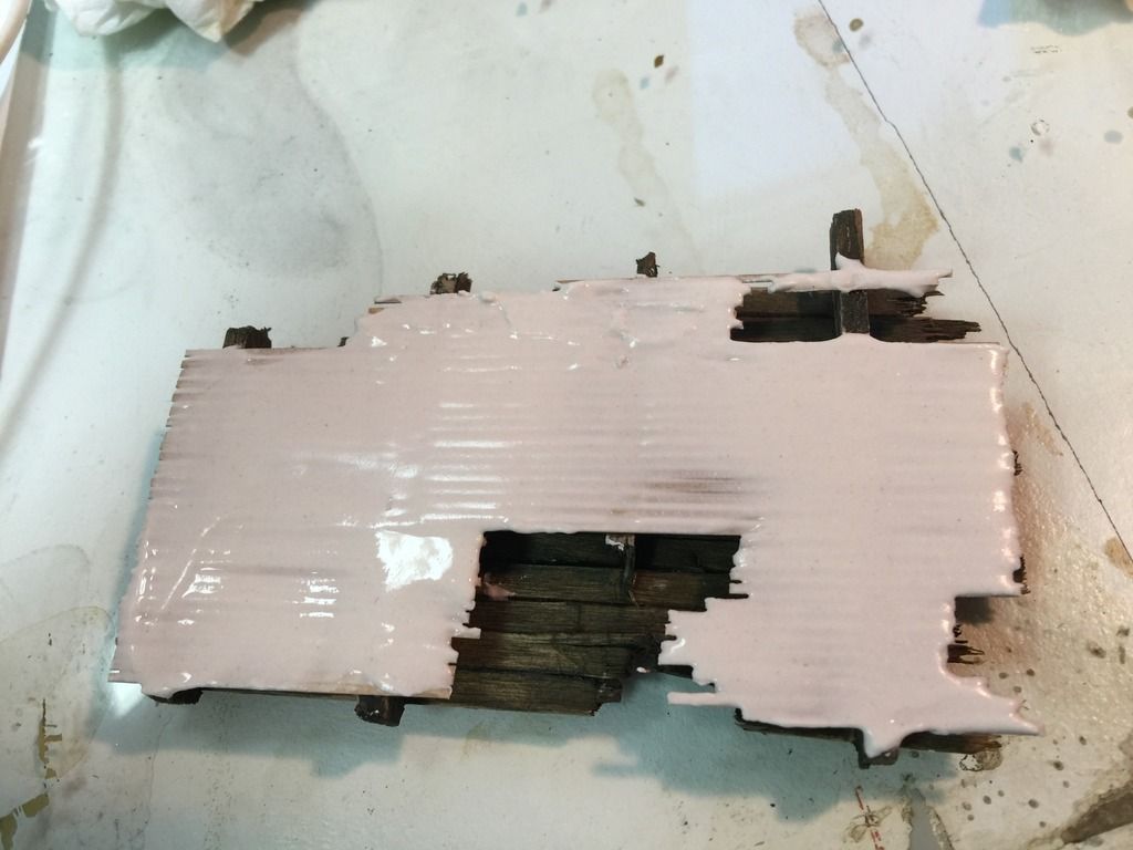

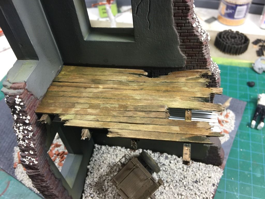

Going to the Miniart ruin. I scratch built a floor from balsa wood and Popsicle sticks. Painted with an array of Vallejo Environmental Effects. Then figured it was missing something. A ceiling! Added old school lathe & plaster starting with some Evergreen 0.10 x 0.40 strip for the lathe, glued on with CA. Once done, I painted quickly with Tamiya XF-57 Buff. Once that was dry, I put a thin coat of drywall mud, let that dry and put on a second coat. Once all that had set up over night, I lightly sanded the dried mud, "damaged" the exposed sections with tweezers, pliers, fingers, etc., to get the effect I wanted. Finally, staining it with various concentrations of tea and coffee.
