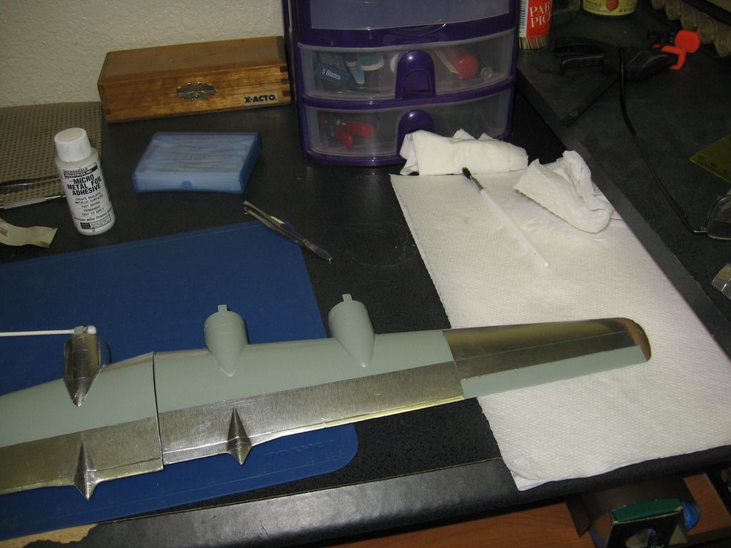

Your foiling really is coming along. I was just wondering how well all those sub assemblies will fit together after the foiling is complete. What happens if you end up with the usual gaps we all face?
BigfootV
Joined: December 24, 2005
KitMaker: 1,624 posts
AeroScale: 385 posts
Posted: Saturday, November 19, 2016 - 08:24 AM UTC
Hello Joel,
Thanks.

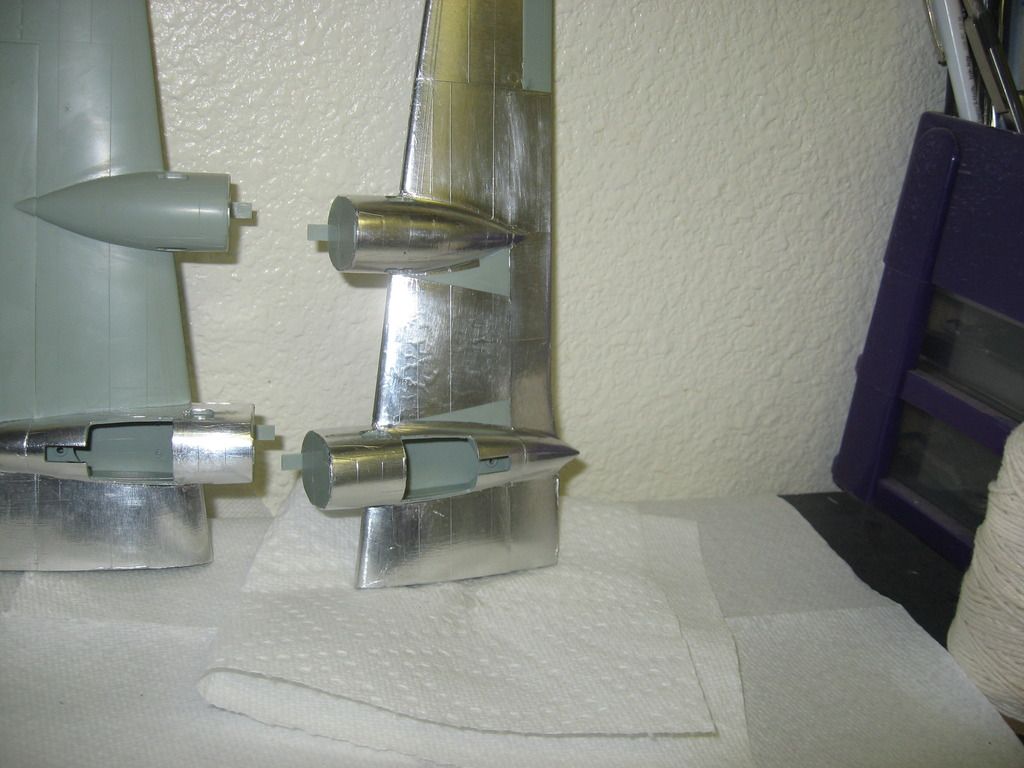

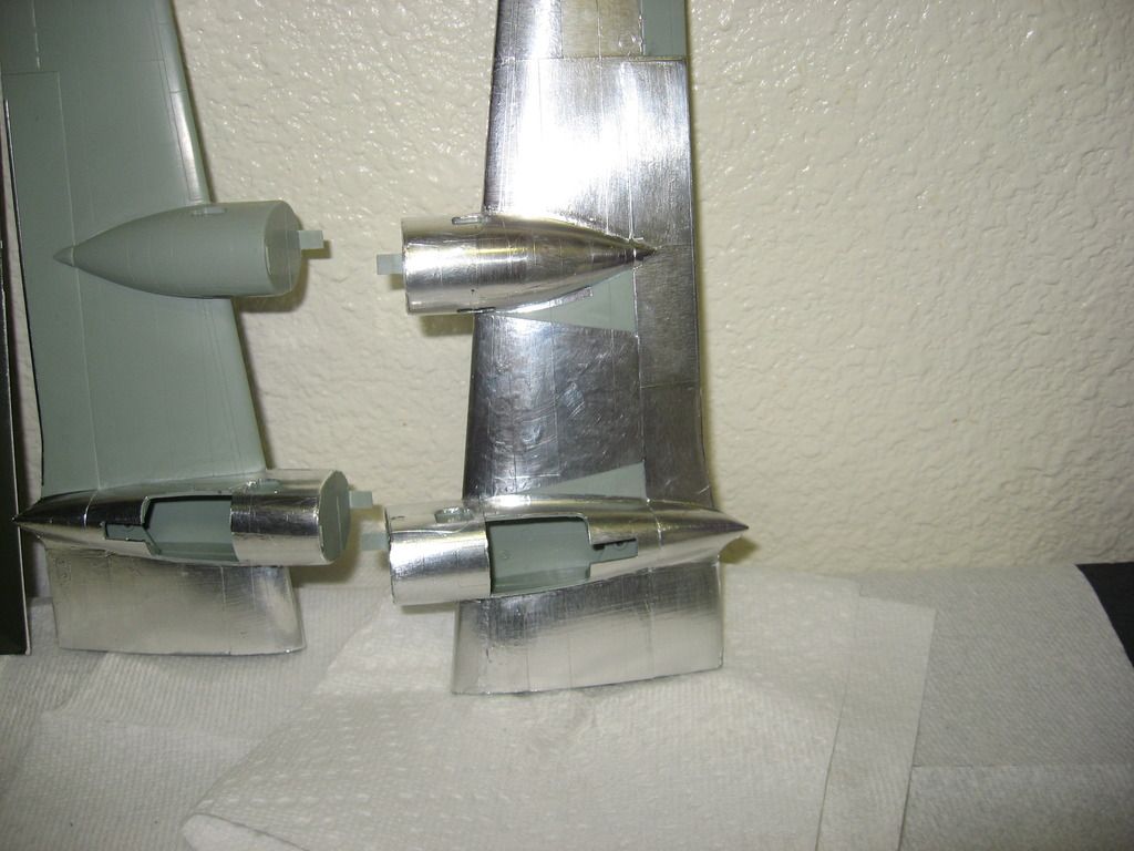

Good question. I've already run into gap issues between the nacelles and the wing when foiling those areas. The cowling faces are my biggest challenge to foil currently since I've not glued them to the nacelles yet.
I'm hoping for some good luck when putting everything together and not have any major issues with gaps in the wing root area.
See ya in the funnies..........

Hello Joel,
Thanks.
Brian,
I would not hope for that with this kit-- I've built it before, so you may have a gaps at the wing/fuselage join, bottom/rear of the engine nacelles, and there will be a seam the length of the fuselage and the cockpit glazing. My recommendation is to foil all the parts up to those points, join, fill, and then continue foiling. I usually assemble the main airframe components (wings, stabilizers, nacelles and fuselage) before I start foiling, but with a large kit like this it can be done seperately too.
VR, Russ

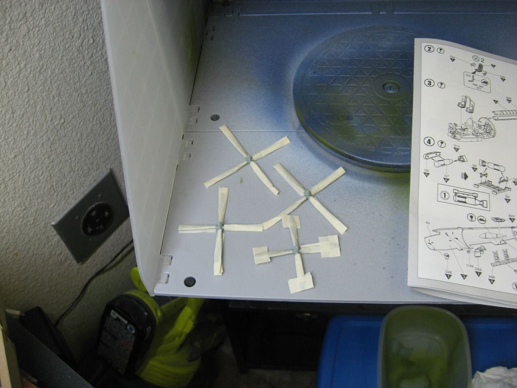

Thanks for the advise. I had planned doing that once I get there. Today has been paint day. The new compressor is very quiet and the airbrushes work way better.
I'll get back to foiling once the interior is all painted up and fuselage is together.

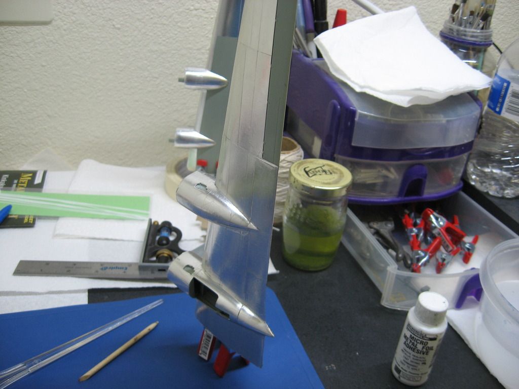

I've got both upper wing surfaces done and one out of four nacelles have been foiled up. I may have to scratch build the green house wind screen. I'm going to see if I can save it first.

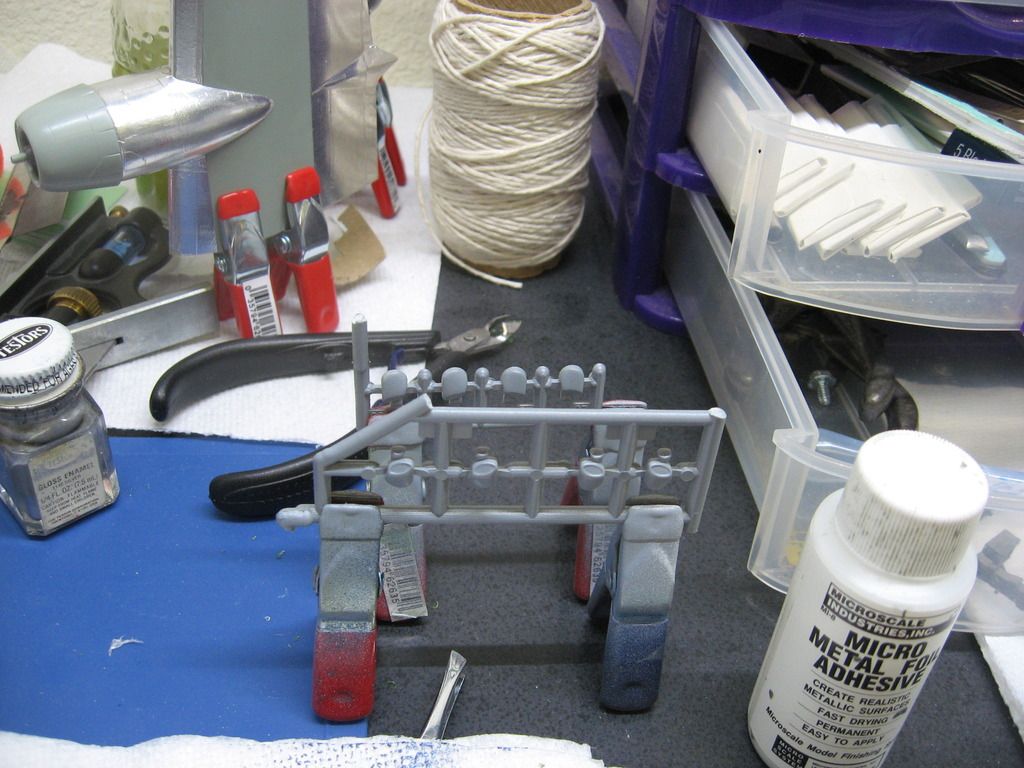

Posted: Friday, November 25, 2016 - 09:23 AM UTC
I meant to post these with the last progress post.
Hope everyone had a safe and fulling Thanksgiving! I had to make a LHS run today to get more thinner, I run out using it to clean off my '57 Chevy body after I hit it with a rattle can that ran on me.
I also pick up some Alclad II, Airframe Alum. to run some tests on before I hit the plane with it.
Anyways, interior painting will continue this weekend.

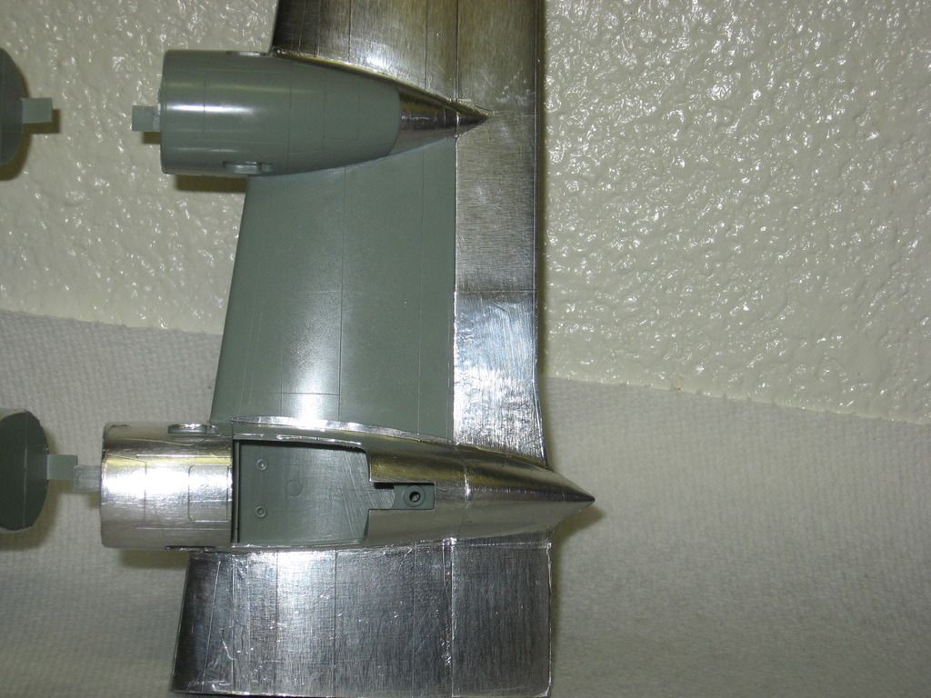

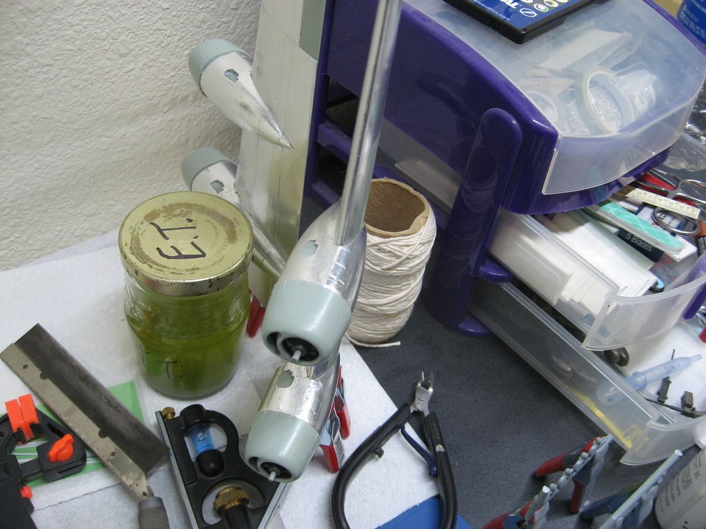

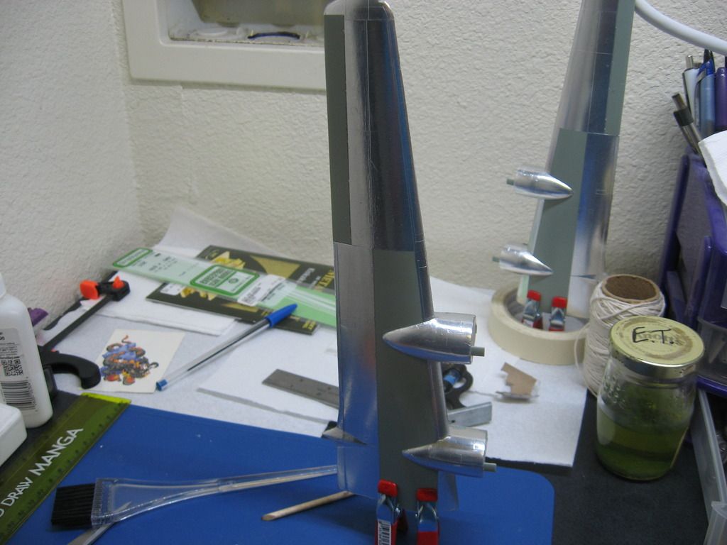

Posted: Friday, December 02, 2016 - 09:19 PM UTC
Hey gang,

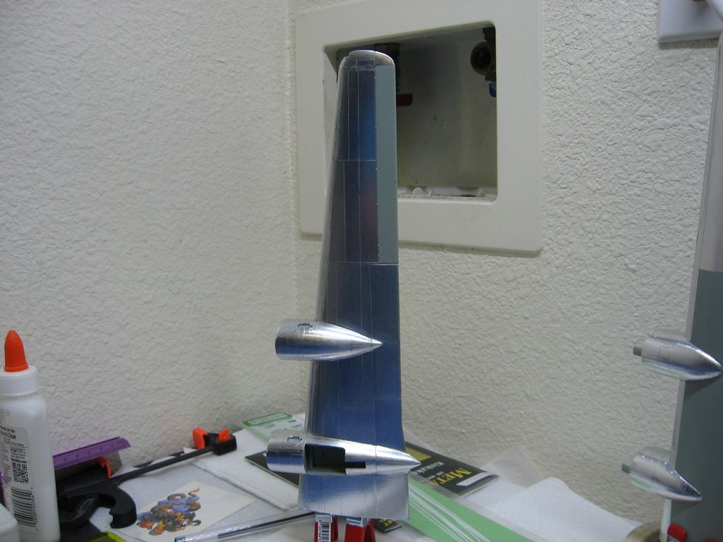

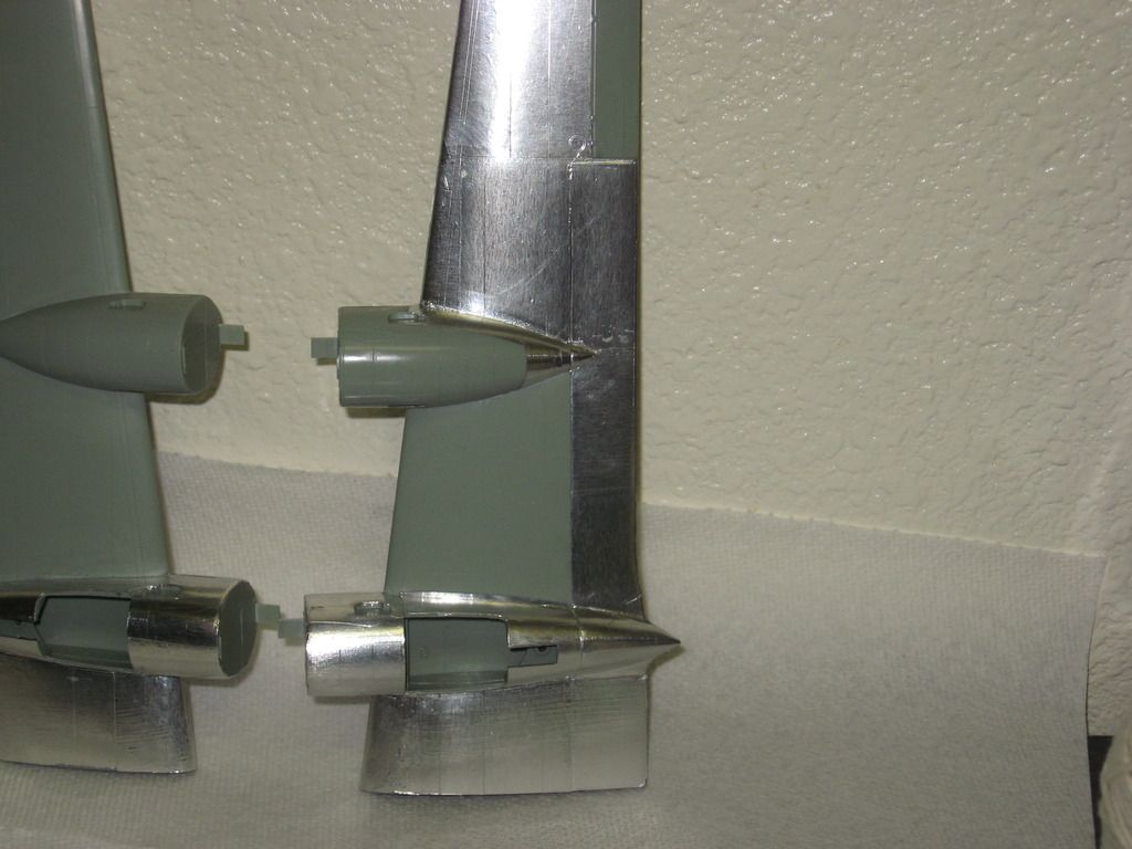

My perfectionist side has been forcing me to re-foil some of the wing areas. Wing tips have been re-foiled and I've been re-foiling the edges so they don't look so ragged. The underside of the wings are getting there.
See ya in the funnies...........

Posted: Friday, December 02, 2016 - 09:27 PM UTC
Brian,
It's coming along very nicely. As I said earlier-- foiling is its own reward, and sometimes we perfect the technique over time and with patience-- so far though, those wings and nacelles are looking really good! Keep it up!

Posted: Saturday, December 03, 2016 - 12:17 AM UTC
Thanks Russ,

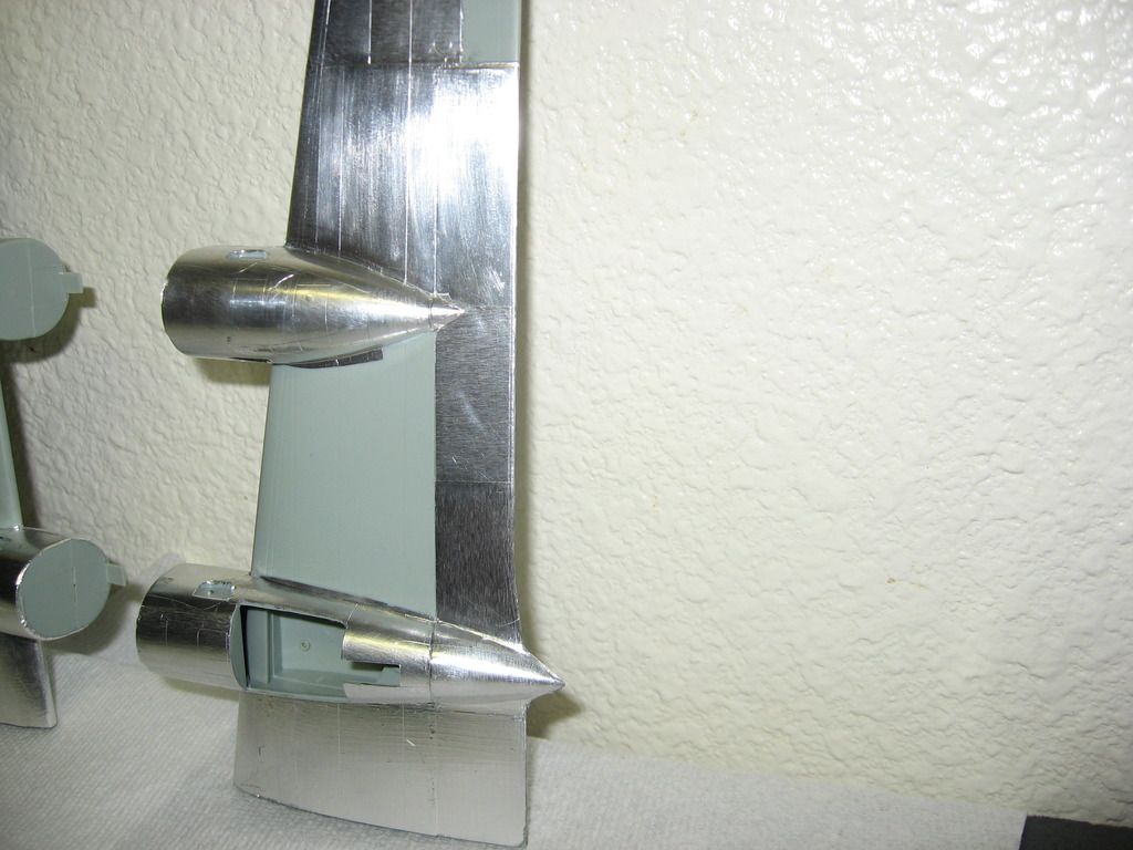

The underside of the nacelles are looking pretty rough when you get close-up. Overall, I'm not doing too bad. A few hiccups here and there. Foiling compound angles.......

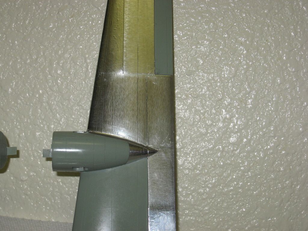

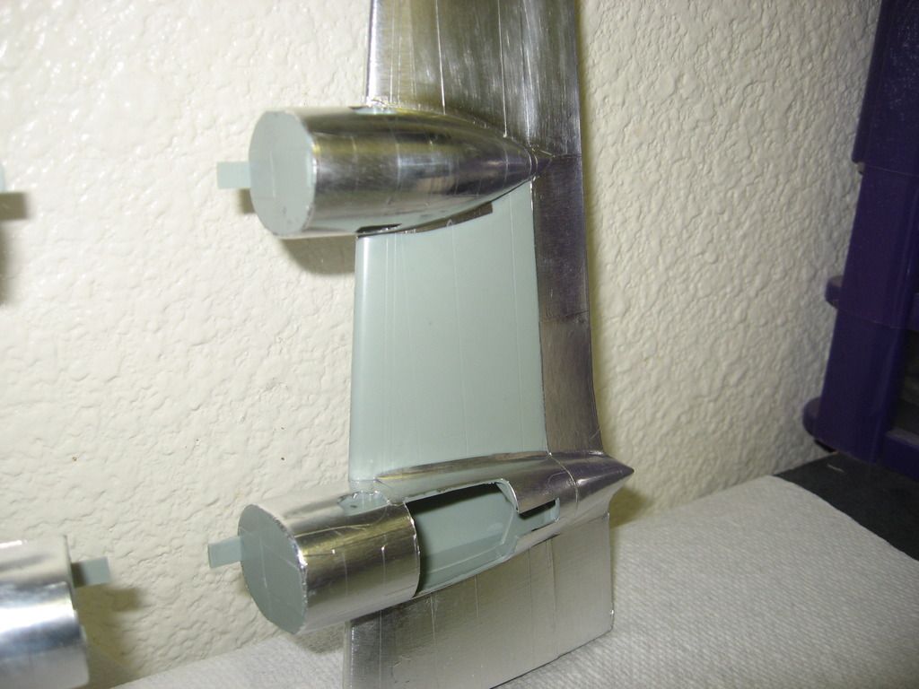

Posted: Monday, December 05, 2016 - 09:53 PM UTC
Bit of an update:
Underside of nacelle after about 3 attempts.
Note the bubbling, that has been removed since photo was taken. Area has been cleaned for re-foiling.

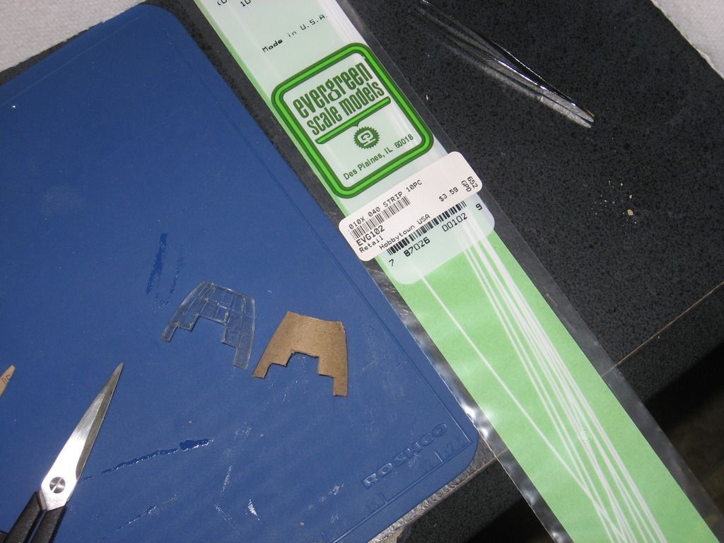

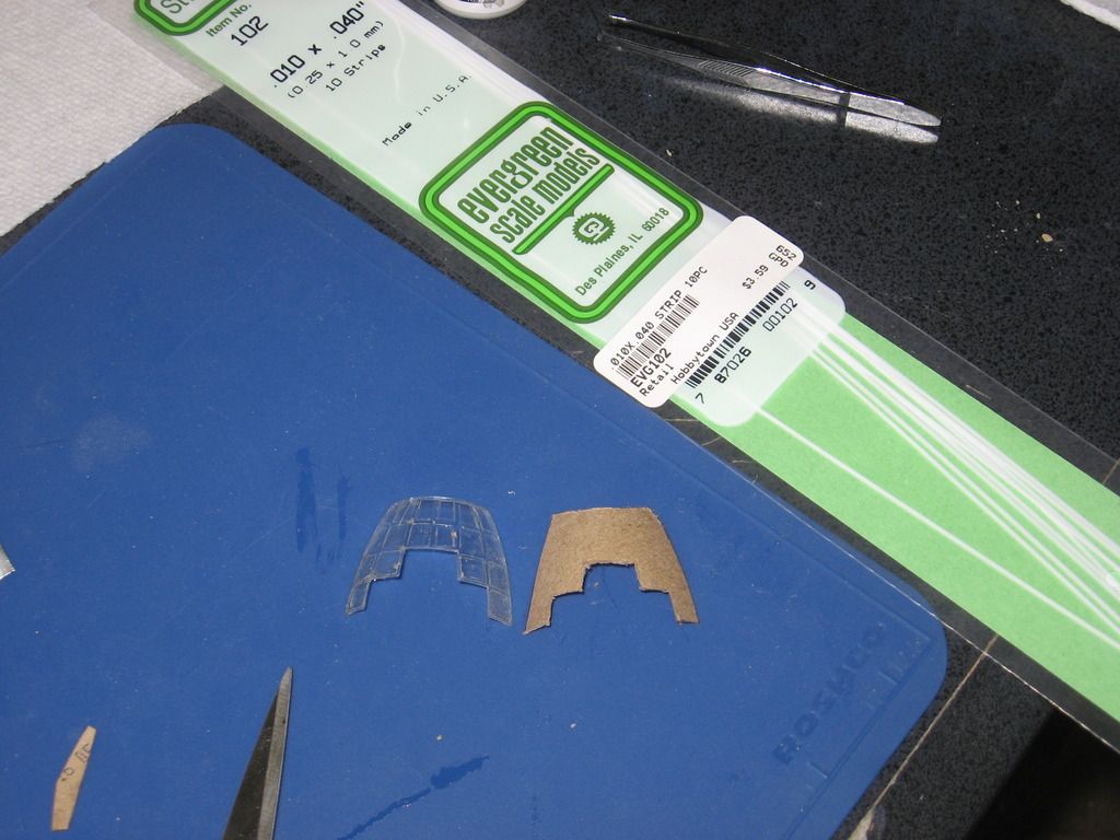

Now, a few updates back I'd said something about the windscreen and that I might have to scratch build it. Well.......
The template is from a toilet paper roll.
I picked up the strips on the last LHS run.

The foiling looks like it's coming along nicely, but I'm not totally clear on why you feel the need to scratch-build the canopy-- that looks like it's going to be a bear with the compound curves in the perspex. If it's too thick could it be sanded and then polished back? or perhaps vac-formed?
VR, Russ
BigfootV
Posted: Tuesday, December 06, 2016 - 12:21 AM UTC
Hello Russ,
Thanks. It's slow going.
The canopy has a massive crack in it on the pilot's side that runs right down the middle of the glass on the second row. It's a stress crack. I'd love to vac-form this piece, rigging something up would take longer then the foiling. Space is at a premium around here also. I'm hoping this paint booth I've got coming is as compact as it's advertised.

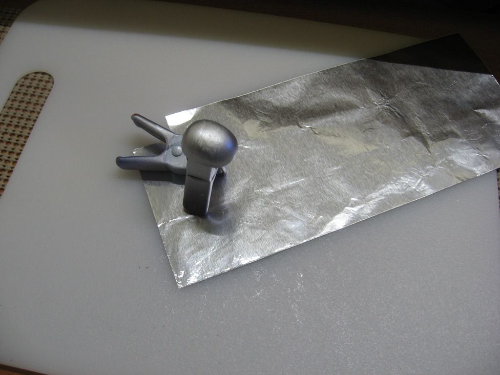

Thanks for the offer. I forgot about the acetate trick. Baking and pastry chef's use it to form complex cakes and stuff.

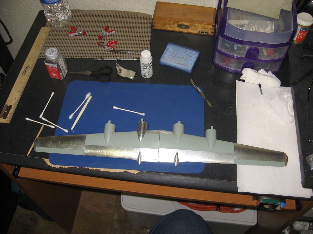

Posted: Saturday, December 10, 2016 - 09:31 PM UTC

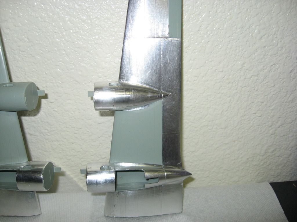

Right wing finally done. Next is BMF areas. Left wing should be done today. I've got one area to re-foil.
Ummm, Brian, you forgot to paint the wheel wells. (Face palm.) DOH!
See ya in the funnies....................

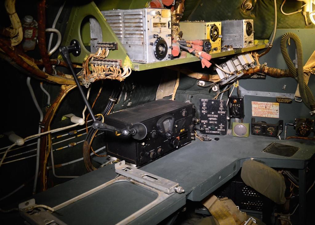

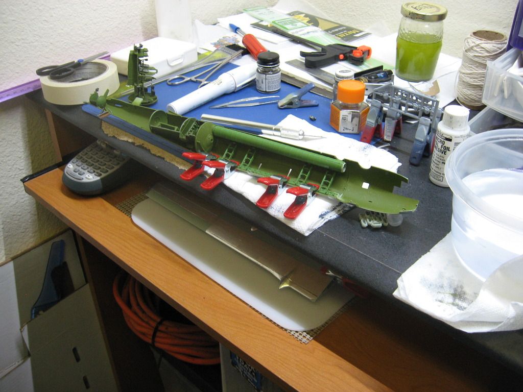

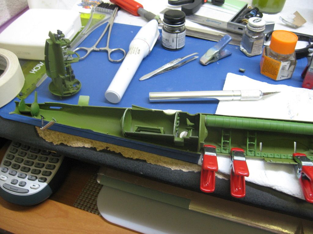

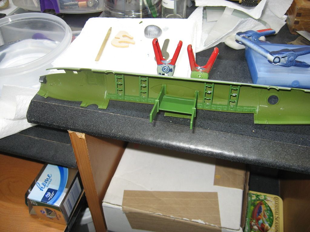

Started putting the interior together and ran into a bit of an issue with the fit. It would seem Academy added something to the radio operators station.
Here's the real radio station in Brockscar....
The part..............
What needs to be removed................
If this box is left on, you wouldn't be able to get the interior to fit against the fuselage when mating the two together.
Granted, if your not doing a cut-away view of the interior, it doesn't need to be correct. However, if you want things to fit, it has to be removed.

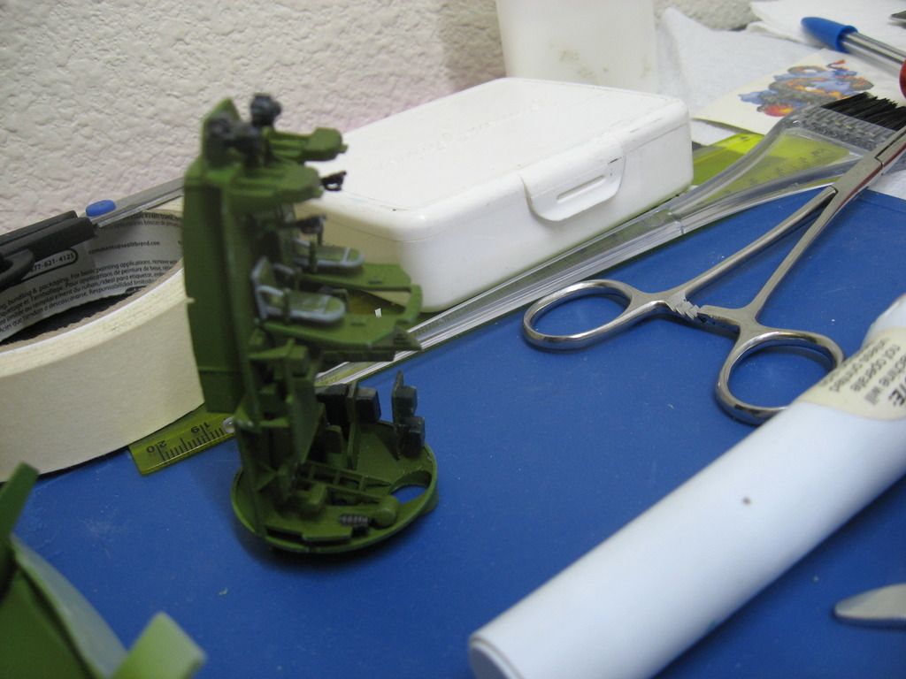

Small update:

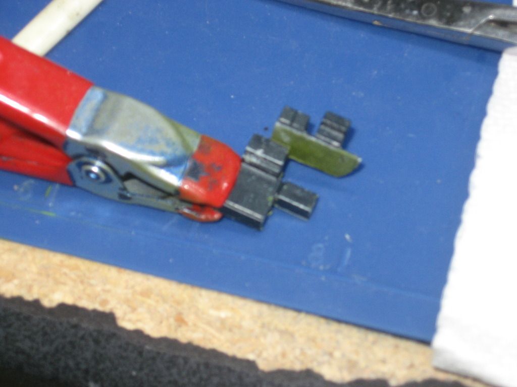

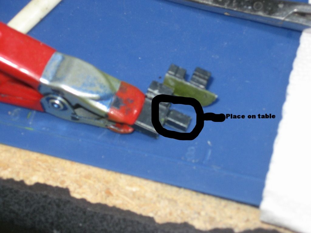

Interior in place. Dry fit exposed some issues with the bomb racks. You'll need to sand down both end so the interior bulk heads fit. Th racks are too long by about a 1/32nd of an inch which makes it hard to get the bulk heads lined up with the other fuselage half. Once you get ready to join the two half's, watch the anti-tail strike gear so the holes line up on the other side. Also, make sure the lower O2 tanks glued in place firmly.Radio's are in the correct position.
Exhaust ports, landing gear and prop tips are ready for paint. Engines mounted.
Next update I should have the fuselage joined together to start foiling.
