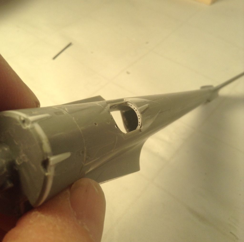

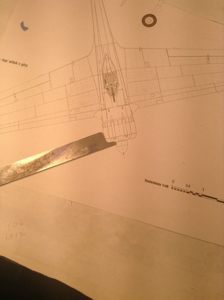

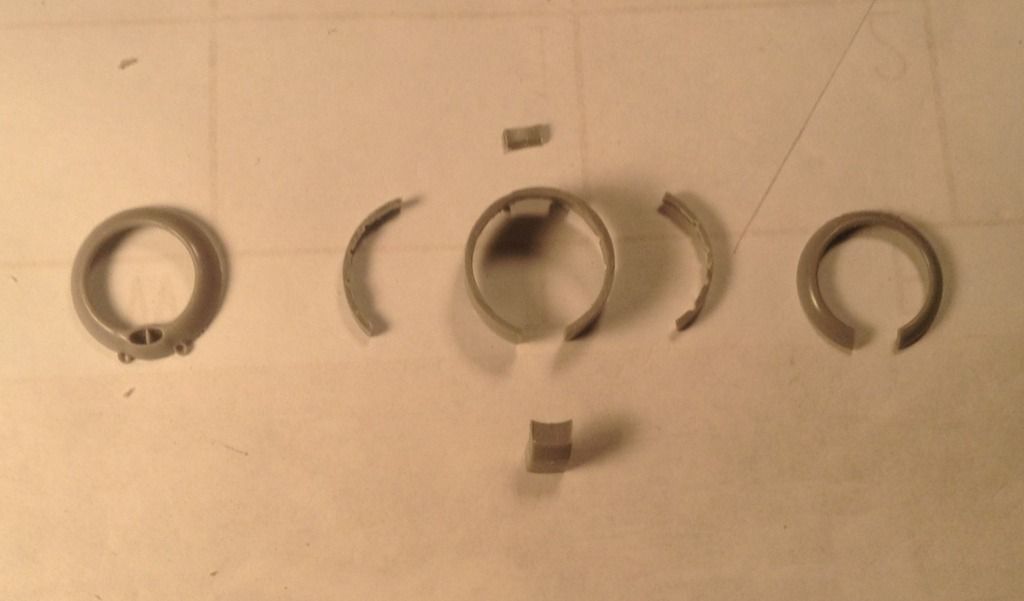

I've begun the cowl improvements by sawing off the gun blisters, cowl flaps,

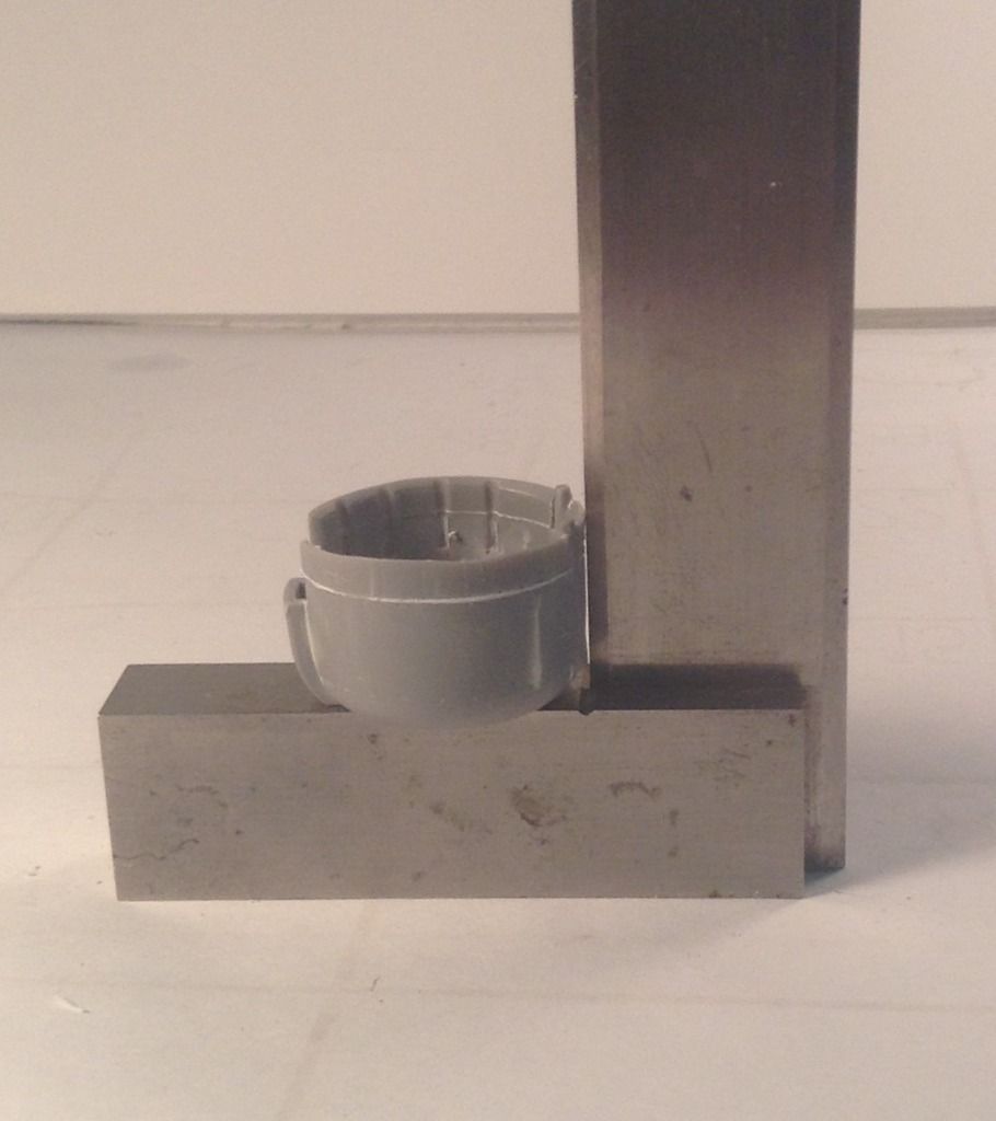

chin scoop and front cowl ring - the cowl ring to the left is the FineMolds Ki II ring inverted .

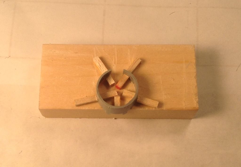

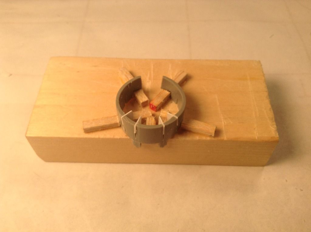

The cowl was then placed on a wood block and cleats glued to the block to maintain the shape at the rear of the cowl-
Next slits were sawn in the cowl partway down along panel lines and under the gun blisters to allow the cowl to expand . Plastic shims were wedged in the slits.
The shims were driven down to expand the cowl until it matched the greater diameter of the FineMolds cowl ring.
Next up will be the preparations for turning a ring from scratch should the FineMolds ring not work out.
Thanks for looking ! Richard

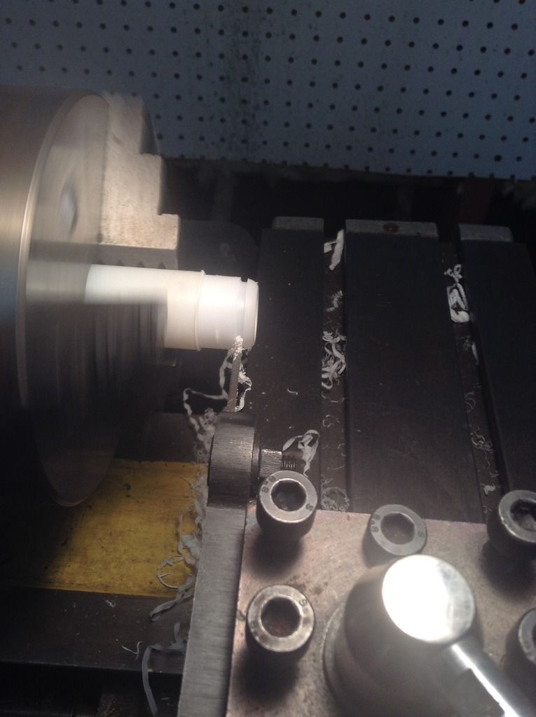

I am likely going to use the FineMolds ring as it looks like it will adequately lessen the pitch along the top of the cowl but I'm going to turn one up to a slightly greater diameter to see which might be the best option.

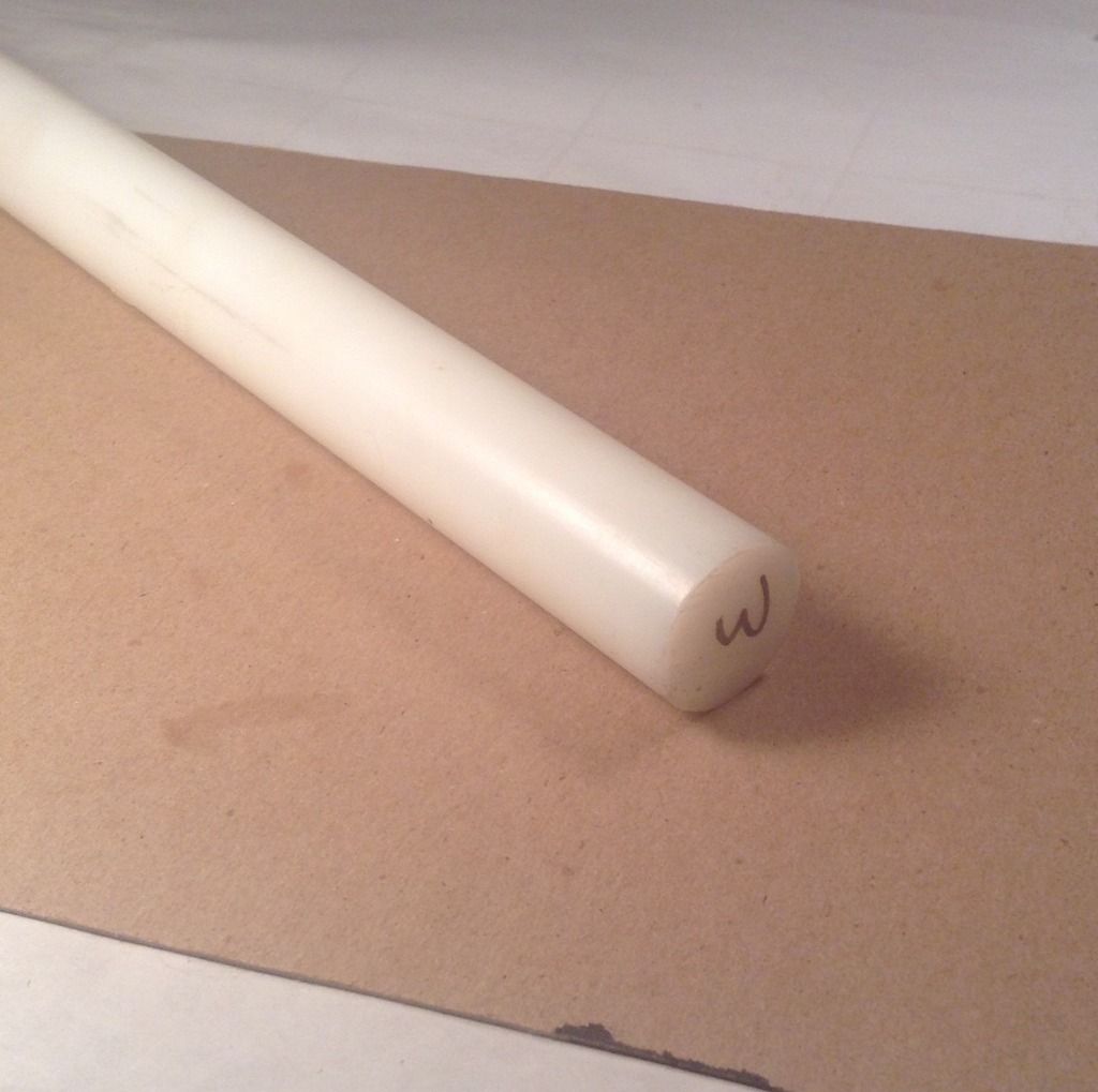

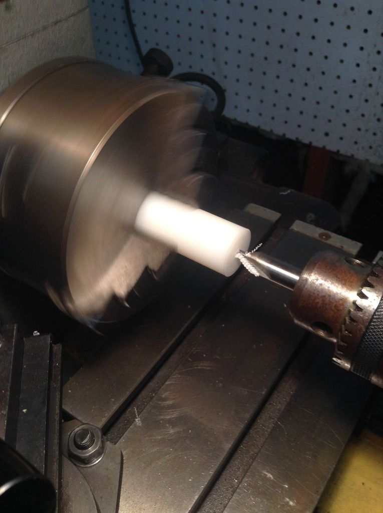

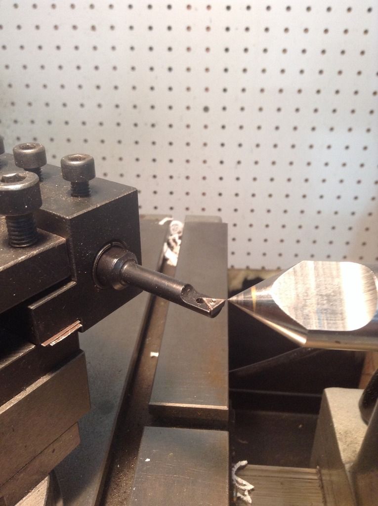

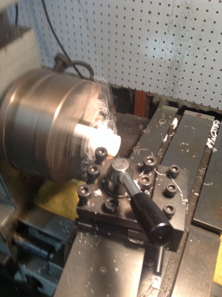

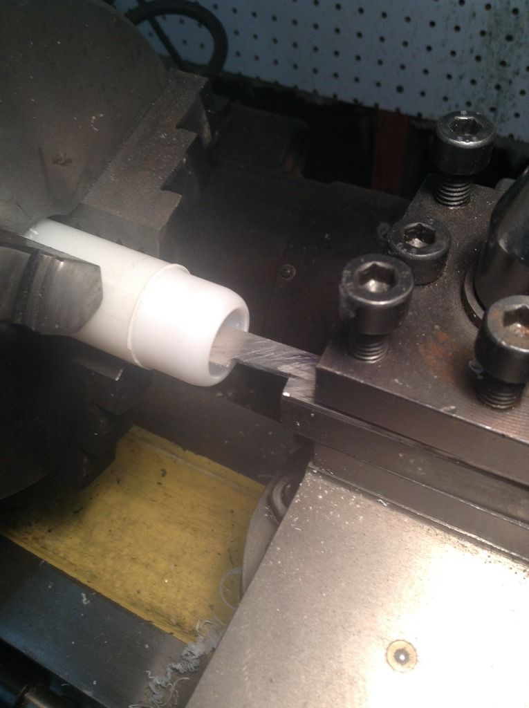

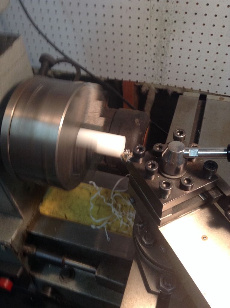

I purchased a piece of 1" dia polystyrene rod from McMaster-Carr . They are an amazing organization- probably hundreds of thousands of items in inventory- tools, supplies, raw materials-pretty much everything in industrial supply. Easy to use website, excellent service- I usually receive my order the following day- and they have never been out of stock on anything I have ever ordered.
I next filed up two profile cutters out of a piece of mild steel bar stock- one for the radius on the outside and another for the profile on the inside-
The rod was then chucked up in the three jaw chuck- once machining has begun it cannot be disturbed or subsequent operations may not be concentric so you must be certain that you have enough working room for the tooling yet have the minimum mount of stock protruding as it will not be supported by the tail stock in this type of work.
I hoped to place an image of the rod chucked in the lathe here but the gremlins have returned . Here then are the order of operations and hopefully the pics will follow.
1. Facing- cutting across perpendicular to the axis of rotation
2. Light turning- truing up the diameter
3. Center drilling - starting a hole in the end of the stock
4. Boring- enlarging the hole in the stock to the diameter of the opening in
the cowl ring - essentially turning from the inside
5. Turning- reducing the outside to the required diameter
6. Profiling - creating the radius on the outside
7. Profiling- creating the profile on the inside
8. Parting- cutting off the workpiece from the stock
I guess I'm lucky the gremlins let me get this far- I'll try again later with some more pics.
Thanks for looking - Richard

Posted: Tuesday, November 29, 2016 - 08:49 AM UTC
it looks like I posted the outside profile cutter pic twice- here is the inside profile cutter-

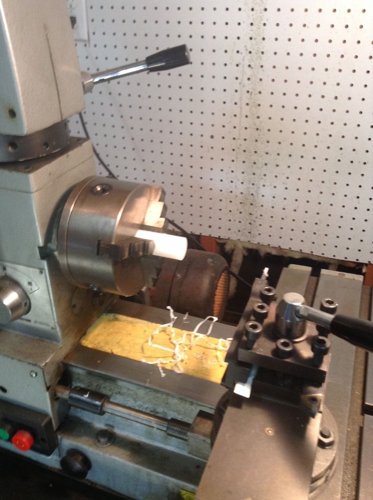

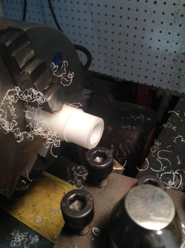

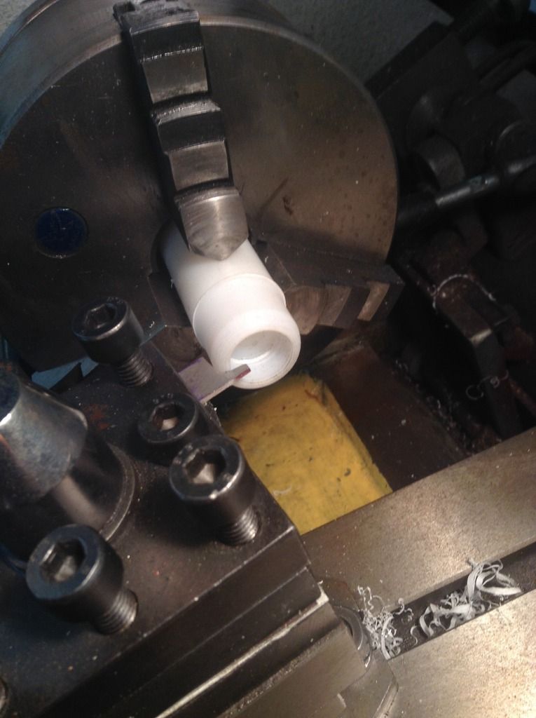

Here is the rod stock in the chuck -
Facing-
Center drilling-

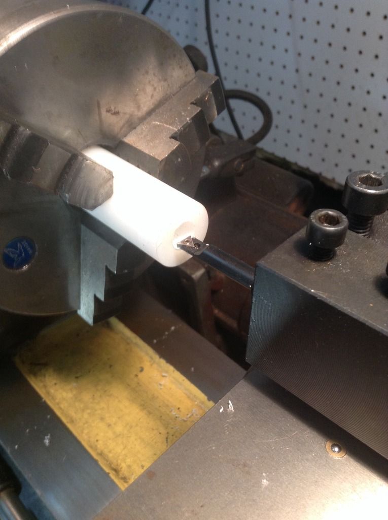

Centering the boring bar-
Boring-
Turning-
Boring and turning complete-
Profiling outside-
Profiling inside-
Parting-

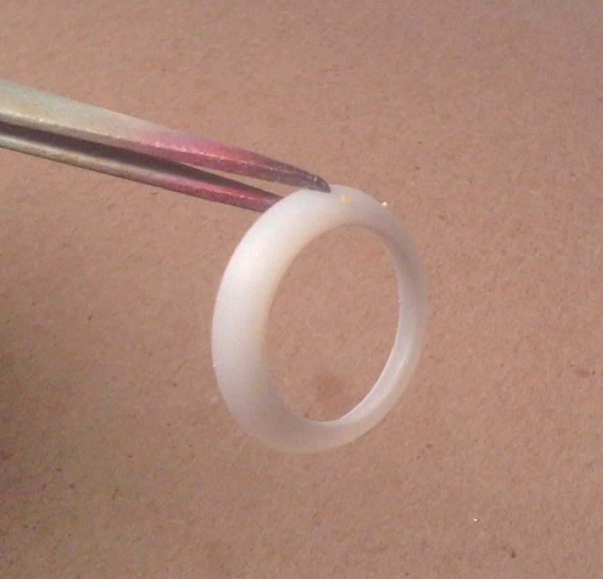

Voila !
so there we have it - a scratch cowl ring . Next up will be choosing which and cementing to the widened cowl-
My apologies for the disjointed presentation- the loading of the photos seems to have a mind of its own - ??????
Thanks for looking in - Richard

The centering of the boring bar and parting images are incorrect-
these are the correct ones-

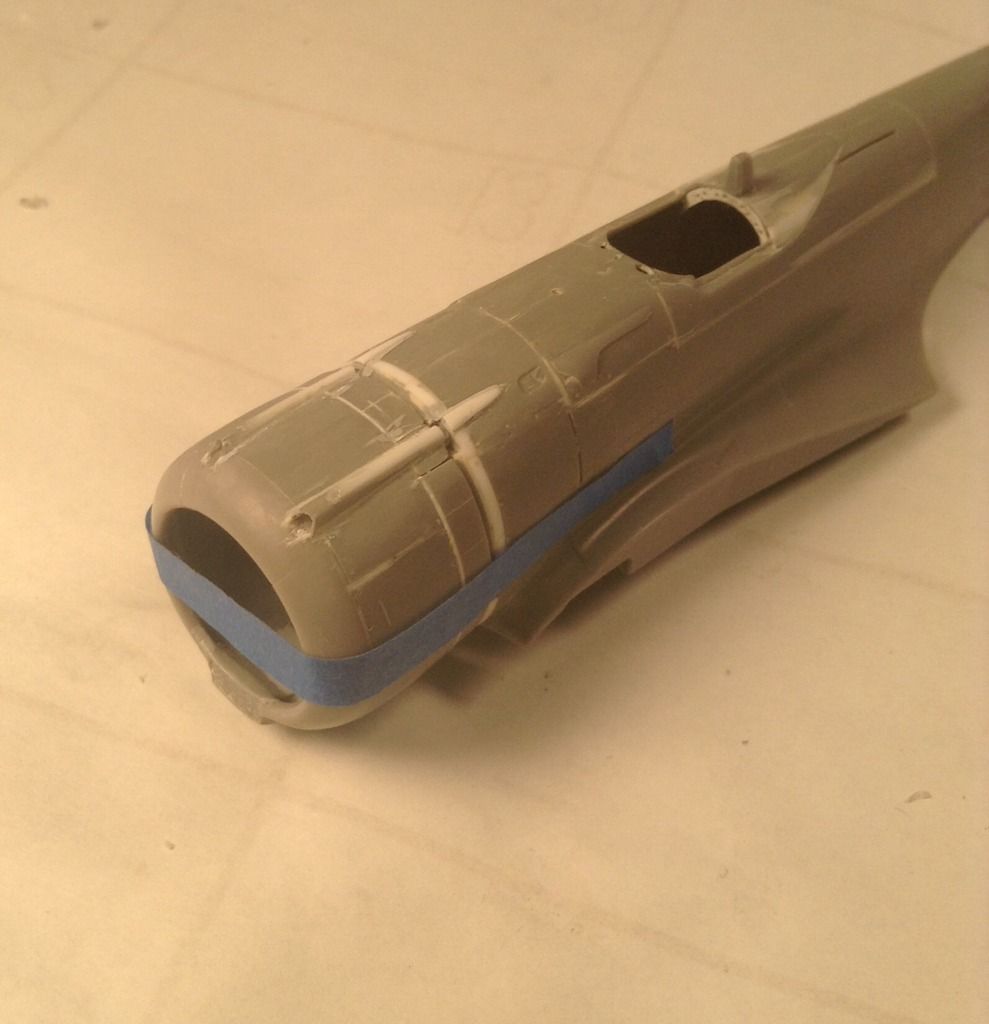

The cowling improvements are largely done. I wound up using the FineMolds cowl ring because its slightly greater diameter was enough to negate the pitch along the spine. I inverted it and cemented it to the expanded cowl in its jig and when cured I cut out the air intake which is now at the bottom:
Here is the cowl all back together with the original Ki 43- I air inlet at the bottom- a little sanding, thinning etc and I'll call it done:
Here we can see the difference along the spine - first the original Hasegawa cowl in unmodified form:
and the modified version:

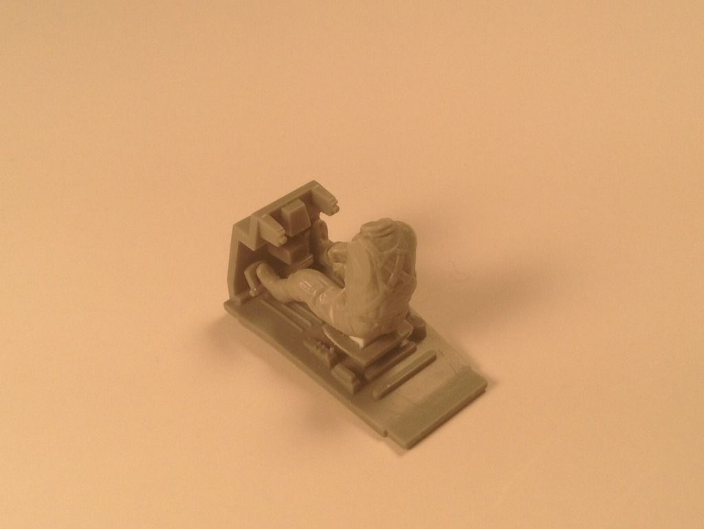

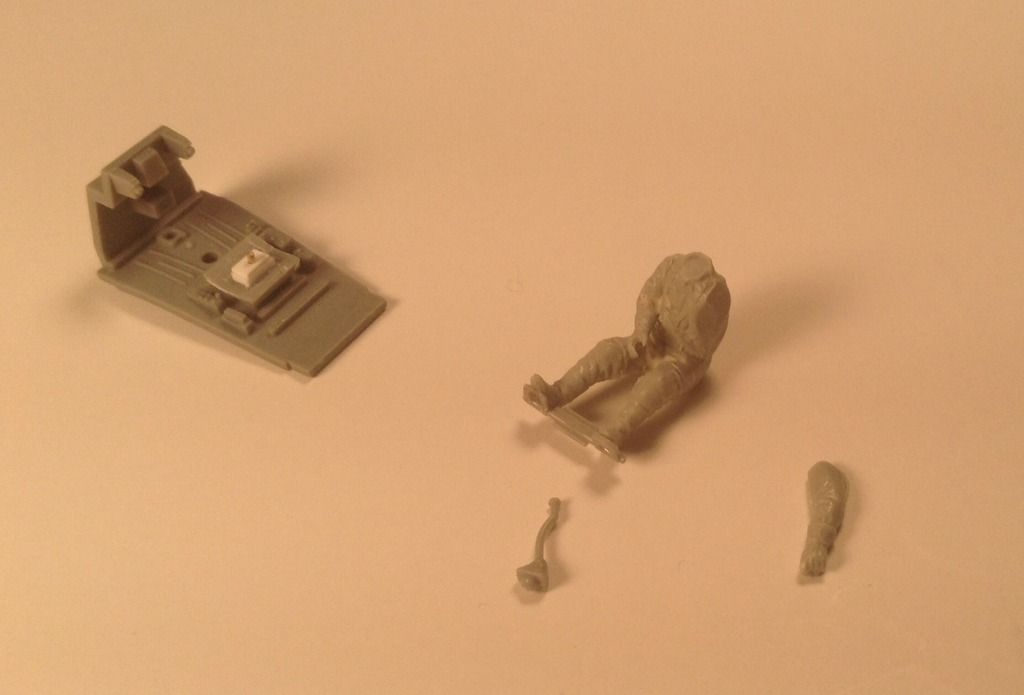

I have decided to try to pose a pilot figure from this set by Modelkasten in the cockpit:
I had to do pelvic and knee surgery and also thin cockpit side walls to get it all to fit:

the modified cowl is outstanding to say the least. I was hoping to see the cowl you turned, but the choice you made does indeed fit perfectly.
the Comparison pics really shows your adjustments.

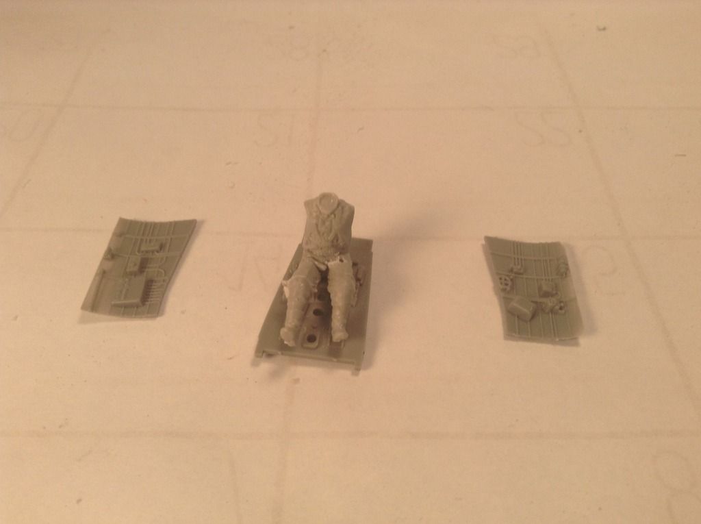

I've been working on fitting/posing the pilot figure a bit - he'll be kicking in a little right rudder and back on the stick to keep the tailwheel planted during the start -
I originally planned to have his left arm raised in a signal fashion but the narrow cockpit opening made that difficult so he will have his arm resting on the fuselage -
This raises some painting issues- I think I am going to have to finish the
interior and legs/right arm/torso and then cement/ putty left arm to fuselage and go back to painting left arm and head after aircraft paint is complete- I'm open to suggestions.

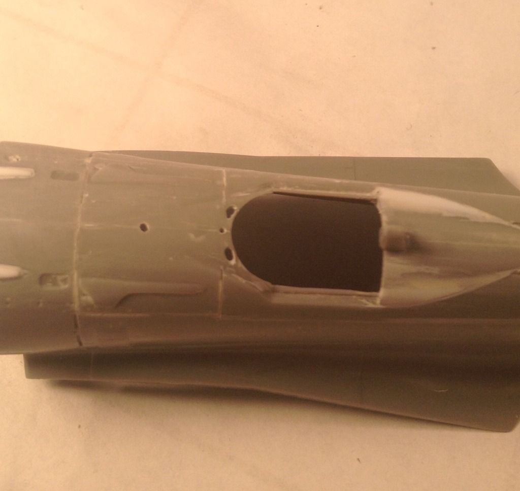

Posted: Thursday, December 15, 2016 - 07:23 AM UTC
Just a brief update - more of a test as my daughter seems to have cured the computer - Ah ! Youth !
I have added the top of the frame at the back of the cockpit - .010 " styrene with lightening holes drilled. Some of this will be seen behind the pilot's shoulders-
I have also thinned the fuselage deck around the cockpit and added the two hand holds behind the windscreen and faired in the recesses flanking the headrest-
I tweaked the gun blisters a bit with strips of styrene, filler and surfacer-
I am also working towards getting some paint on the interior components.
