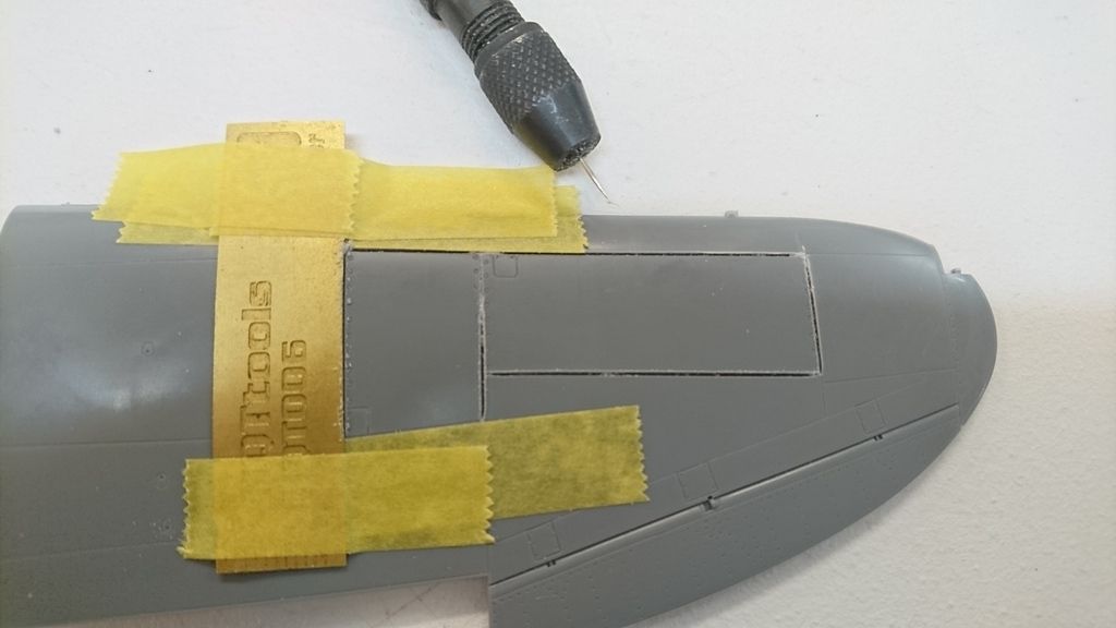

The next subassembly to deal with are the gun and ammo bays, for which i have bought the Aires set. As i don't have experience with cutting panel lines i was reluctant to add the bays as it requires some surgery. I decided only the add the gun and ammo bay to the right or starboard wing, because that saves me a lot of trouble when painting the insignia, which is on the opposite wing.
I first taped a metal ruler next to the panel line and with a sharp needle i made the cuts, which was pretty easy. Finally, each corner was drilled out with a small drill to connect all the cuts.

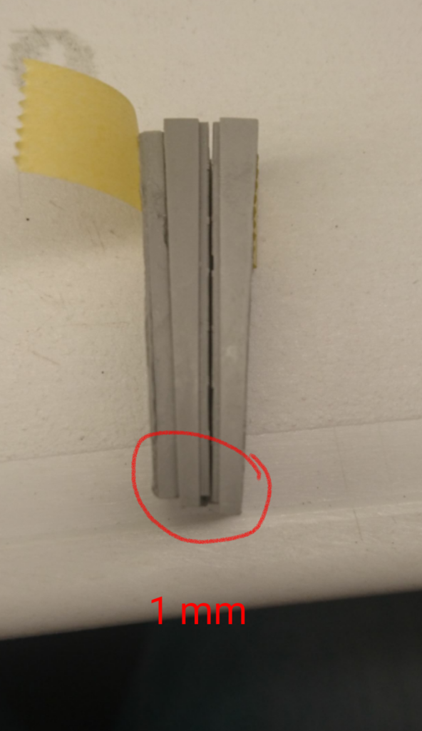

At first, the fit of both bays seemed to be fine, but at closer inspection i noticed that the ammo bay was 1 mm short, leaving a small gap. At closer inspection i also noticed that the cover of the ammo bay is also 1 mm too narrow. The cover for the gun bay seems to be ok. I found out that i was lucky to do only the right wing bays as the left ammo bay is 1 mm shorter than its right wing counter part...
This photo summarizes everything pretty well:
The question is how to deal with this.
I have a few options:
- first of all i will fill the gap between the ammo bay and the wing. That should not be to difficult.
- I can leave the covers off, that hides at least the fact that the covers are too small and also does not attract attention to the fact that the ammo bay is too small.
- I can add the covers and especially glue the cover of the ammo bay exactly in the middle of the bay, leaving half a millimeter on each side. This is rather small and not very obvious.
- Using the original covers from the kit is not an option because i made holes in these to connect the cuts in the corners.
Any thoughts on this are highly appreciated.
