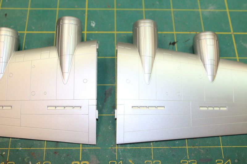

Started with the wings, adding the wheel well components, the intakes and oil cooler faces. The detail is fine for an out of the box kit. They have the oil tank, the interior of the nacelle as it goes around the exhaust is fairly accurate, and the intake going to the carb (not shown in this photo).

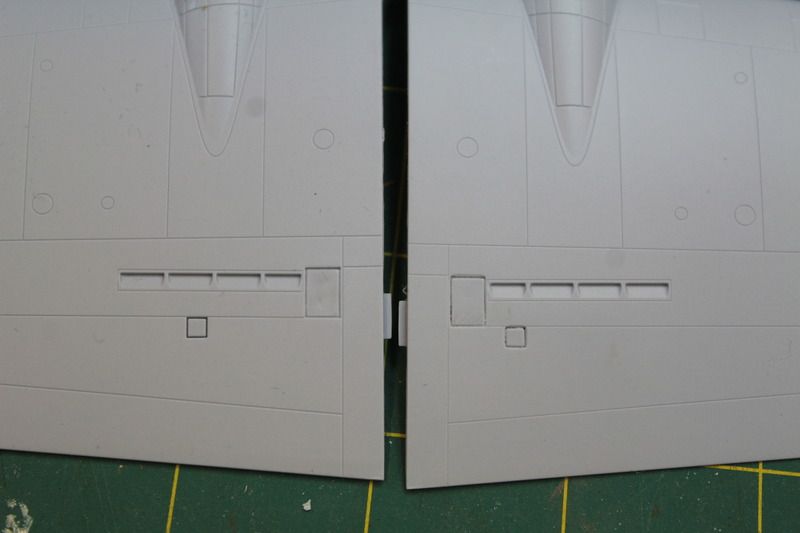

Airfix has provided the parts for the hot air heating system which was on late B-17G's. Late meaning G-80-BO, G-50-VE, and G-50-DL. Now, this is a first in a B-17 kit. However, both sets of markings are for earlier aircraft. What Airfix doesn't tell you is they have provided the parts to do the earlier glycol system. So I will leave off these parts starting in the wheel well where the overboard dump is not needed. You can see in the earlier photo where these were mounted on the back of the wheel well. Then in the upper wings, the exhaust grills will be replaced by blanking plates. Those will need to be made invisible as there were no panels there prior to the hot air system.
Unused parts:
The exhausts will be different but we will deal with that another day.
Here are the blanking plates in place. Looking forward to filling those in !

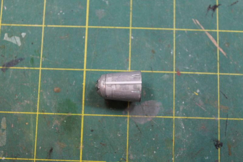

Getting ready to close the fuselage on the Airfix Fort. The fit continues to be very good and the level of detail will be sufficient for the general modeler. I intend to do another with the Eduard goodies . Also worked a bit on one of the engines and it looks decent. Someone with better painting skills will get a better result. While the oil sump is a little too far forward, it still makes a nice looking engine out of the box.

The wings have had the bits filled in where the blocking panels were installed:
Before
After

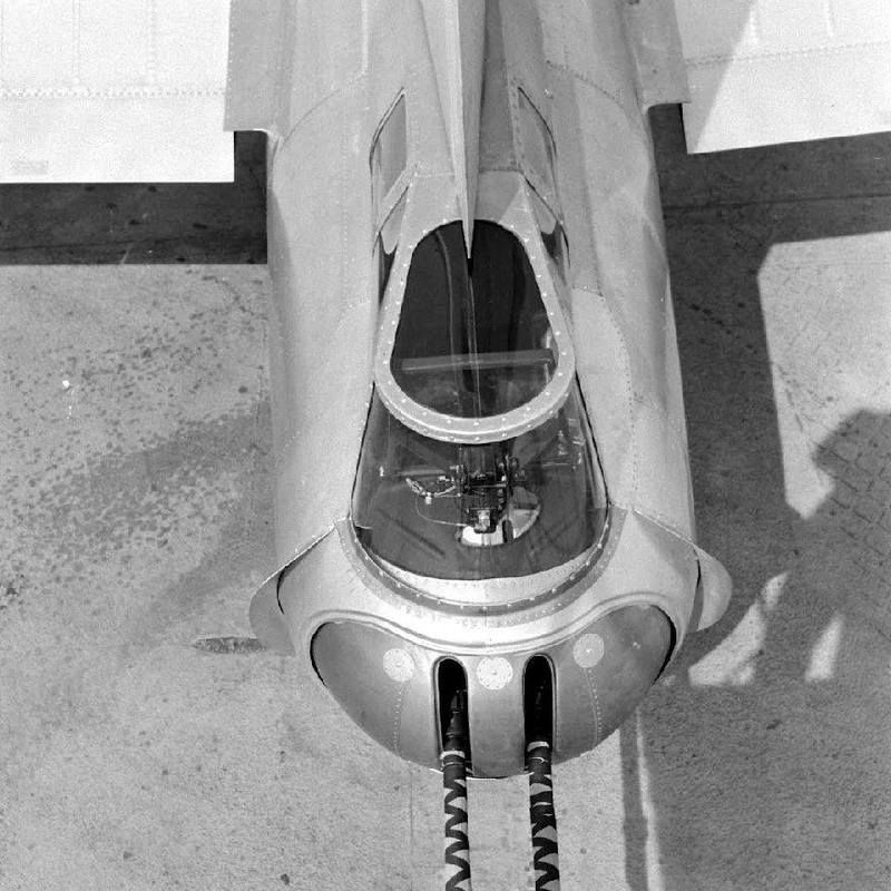

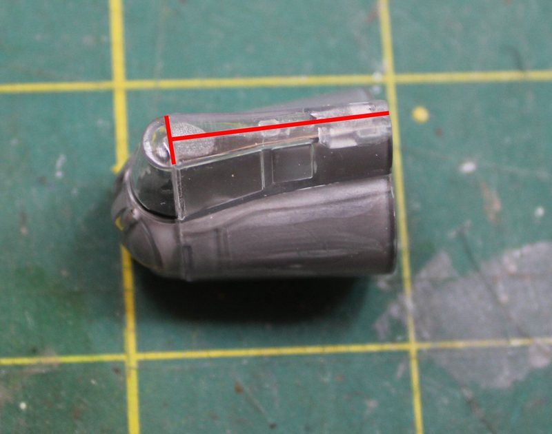

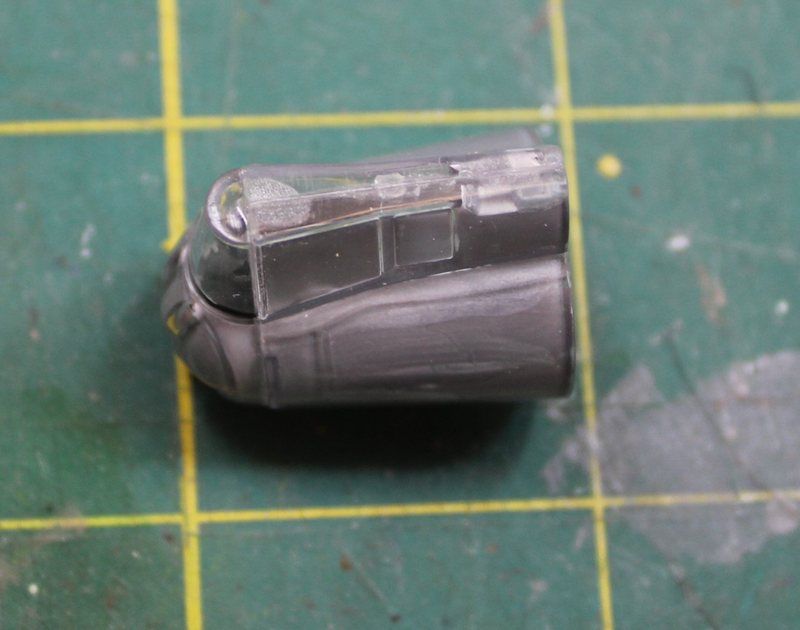

The tail cone has a few issues. First off it is too small and leaves a noticeable step where it meets the fuselage. I glued in a .040 styrene shim in the bottom. I had some concerns that this would cause a problem with end bit, but it is working out.
Because of the way Airfix designed the tail, it has a couple of seams on the top. As it is a bit hard to see in the original photo, I marked the seams in the next one.
Unfortunately, there was a clear panel over the gunners head. Not too difficult to get some clear plastic and make the panel but...
