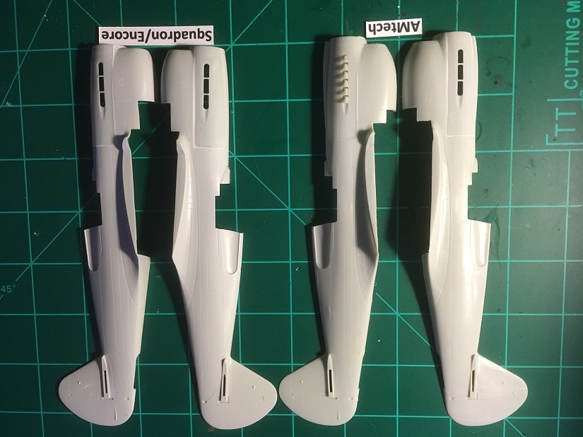

Ok! Ive started taking photos of the (3) different kits and have found some subtle differences. But it seems they all were influenced by one. Not sure if it was the Otaki / Arii or not.
Otaki / Arii kit. While researching on Scalemates, they date this tooling from 1974. The fuselage had some round or bulbous of the rear window panel areas, the cross section at the seat/cockpit area seems to be not as wide as the other (2) kits. The plastic is thick and the surface detail while engraved is on the heavy side. The tail wheel area is not recessed. The cockpit has detail and the engine area has (2) large panels to be attached where the exhaust is installed.
AMtech kit. Again on Scalemates this is the AMT 1996 tooling with more parts.
the fuselage is of similar construction as the Otaki. The cockpit cross section is wider but with office detail added as attachments the rear window panels are more angular and the correct shape. The tail wheel is recessed, the plastic seems to be thinner and more brittle.
Squadron/Encore kit. This is also the 1996 AMT tooling and after some further research, all three kits are decedents of the 1974 OTAKI tooling. The fuselage is exactly the same as the AMtech except for the plastic being better quality. The one difference being the resin scoop added to the top on the engine area and the cockpit detail is all resin.

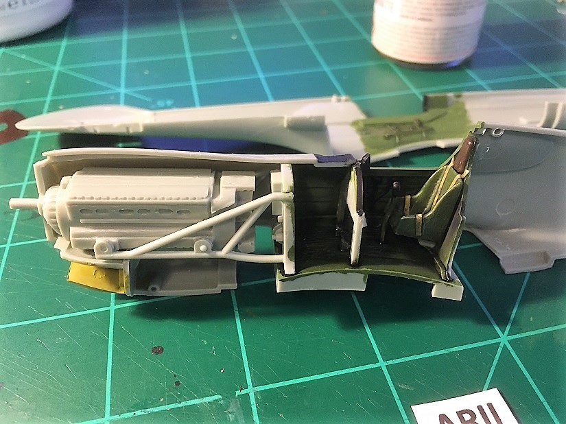

The following photos show the progression of all three cockpits. First a shot of the instructions then all parts followed by each cockpit assembly and finally paint and wash. The Encore cockpit instrument panel will be attached to the fuselage once it has been glued together then the cockpit will be attached to the area following the drying of the instrument panel.
OTAKI: very simple cockpit and seatbelts were made of Tamiya tape were attached to the seat.
AMtech: the cockpit is plastic, but has much more detail than the OTAKI. Seatbelts are molded into the seat. Instrument panel was painted black and the dials were made using a silver PRISMACOLOR pencil.
SQUADRON/ENCORE: this cockpit is the same as the AMtech, but comes with resin floor, seat, back, side walls, and gunsight. I did not use the floor since it was so warped.
The last photo was taken with a flash since the photo of the cockpit before was too dark.

FUSELAGE NOSE AREA:
Each kit gave the option to view the engine by leaving one or both exhaust covers off. I plan on keeping it buttoned up since the AMtech and Squadron/Encore did not come with an engine. All (3) fuselage engine covers are pretty much the same. AMtech and Squadron/Encore give the builder an option of engine cover styles, one with a dimple behind the exhaust (the most common) and one without. I will go with the former. I had to add a piece of card stock inside the fuselage of the Squadron/Encore fuse to keep the engine cover firm in place and as careful as I tried to attach the covers they would not blend without some gap so I will use Liquitex modeling paste to fill in those gaps hopefully without any aggressive sanding just some alcohol and cotton swab to remove the excess paste.
OTAKI comes with a very simple exhaust, but after installed it’s not bad. I plan on drilling out the ends to give it a more realistic appearance. AMtech and Squadron/Encore gives the builder (2) options for exhaust, flared or called fishtail (the most common) the other just a stove pipe shaped exhaust. I have researched the AMtech for markings and will use the fishtail exhaust. My go to data help is the Squadron Signal P-40 Warhawk In Action no. 205.

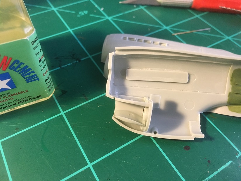

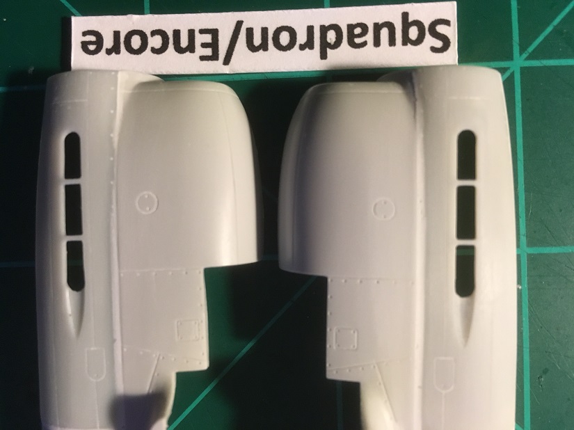

I have been running into several problems with the fuselage assembly now. The chin radiators have been a problem with fitting into each kits place so a lot of dry fitting is needed before glue application is recommended.
Otaki’s part fit the easiest, but that is not saying much.
AMtech’s kit chin radiator parts were destroyed by holding too firmly and were replicated by using some thin plastic sheet.
Encore’s resin chin radiator was the hardest yet, I almost destroyed the fine detail removing the excess resin from the piece. Holding the piece in place to apply some CA was for me almost impossible. I am not left handed at all, but finally got the piece to lay at the proper angle and apply the CA.
After the radiator pieces were installed I finally assembled the fuselage halves together. The easy part was installing the cockpit after the fuselages were together by dropping them into place.
Here is where the different types of plastic OTAKI, AMTECH, ENCORE, brought to front how heavy handed I am with the glue. The seams were pretty much cleaned up by using the back of an Xacto blade.
