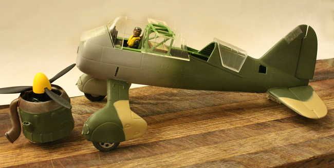

Milestone reached:
Lizzie's got legs! - - - Landing struts attached:
The fuselage continues to be taped together (still) because I cannot seem to stop finding bits and bobs of detailing to add to the interior framework (don't know when this work will ever be complete, will it never end?) but at least the struts are now permanently attached!
Notice how this news is a real head turner for our pilot. (e.g. I thought our guy would look far more natural if his head was not posed so rigidly straight ahead so I turned his head. Now he is posing for the camera - still serious as heck - but at least he is now looking at the camera.)

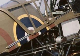

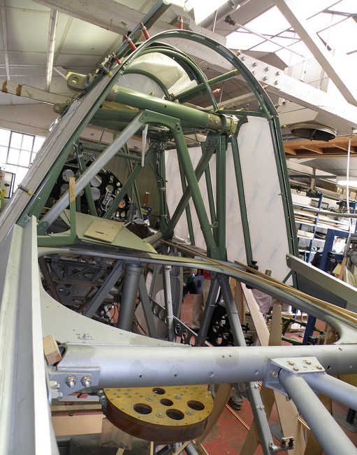

I know I am jumping all around but here is an interesting image that I just found:
Complete airframe:
Shows wing spar tower but ALSO clearly shows pilot's and navigator's "rings".

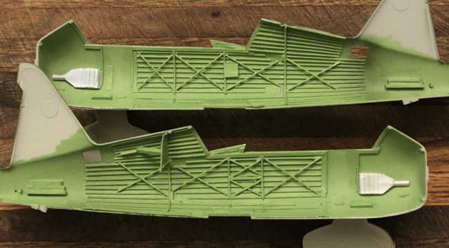

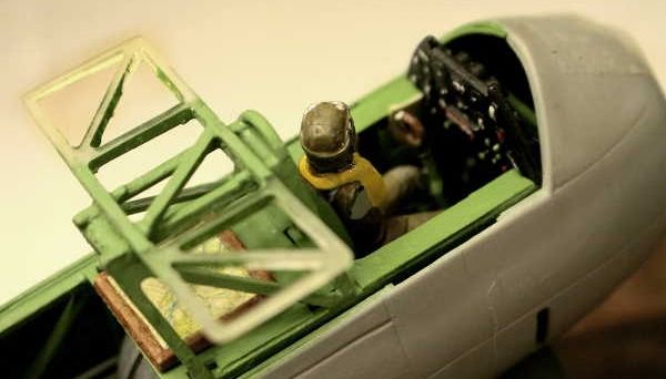

I think my interior bracing work and detailing of the fuselage is complete. (NOT to say the detailing work on the airframe is finished!)
I plan to show both cockpit side windows in the down position. I will therefore cut some clear plastic sheet, mask it to paint the window dividers and add these to the interior of the model.
Cockpit window in the down position. First of two installed.
KitMaker: 8,345 posts
AeroScale: 330 posts
Posted: Wednesday, January 17, 2018 - 02:10 AM UTC

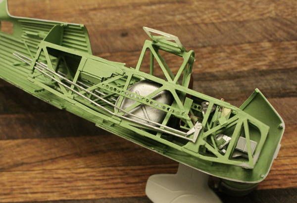

A bit hard to see but more detail (controls and cables) have been added to the structural frame, primarily around the pilot's cockpit. Focusing now on the gunner's area and waiting somewhat anxiously for those twin Browning weapons to show up from Gaspatch and Master!
(Little or no progress on rebuilding the pilot's control panel. I am putting this off simply because this panel will still be removable even after the two-piece fuselage is buttoned up. So it can wait till later!)

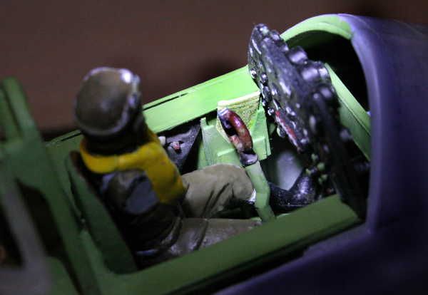

Posted: Wednesday, January 17, 2018 - 12:11 PM UTC
Pilot's cockpit coming together. - Gunner's spot is another subject - much more work to come.

When I saw the engine mount ring on that image of the early Lysander airframe I just knew I was going to have to add it to my model. (Even though once the fuselage is closed up you will never see it again.)

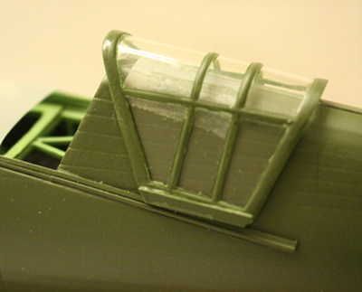

Posted: Thursday, January 18, 2018 - 10:55 AM UTC

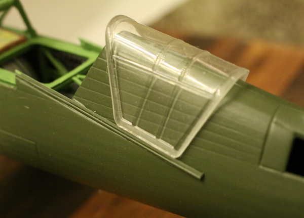

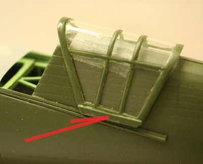

It really bothered me that the rear canopy was not deep (tall) enough to reach the tracks molded in the sides of the fuselage on the model. Also the molded grooves did not extend far enough down the side of the aircraft to give the impression that the rear canopy could actually function.
The solution to both these problems was to add the channel slides to the sides of the aircraft.
I have now also added a flange to the bottom of this canopy. With this addition the glass will almost sit properly on the slide tracks. When I finally glue it on just a slight pressure while the glue is drying and it will sit properly.
If you look at the righthand photo above you can just make out this flange.
(I may want to sand that flange a bit thinner.)

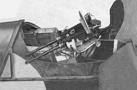

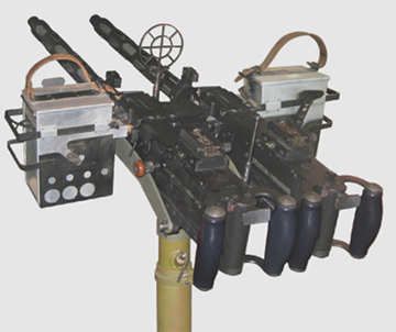

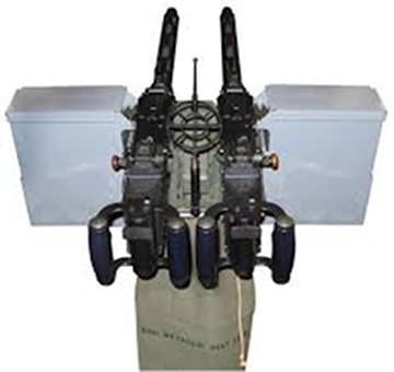

Just found another photo of the twin Brownings! (Still doesn't help with the gun mount.) However it does show the two large cartridge magazines which is new information.
It appears the belts pull from the bottom of the magazines. That seems strange as that would mean the full weight of the ammo belts sit on the portion of the belt being pulled out???
Anyone have any ideas.
(I don't think I'm right on that. It just would not work that the belts pull from the bottom.)
Michael - interesting and a good observation. Although it seems unlikely, perhaps the belts do not lay in the magazines horizontally but instead are loaded in a vertical serpentine fashion. Hmm - any automatic weapons folks out there who can help ?

I spent a good portion of last night looking for some photo reference on the large box ammo magazines that feed the twin Brownings in the Lysander. So far no luck. All I could find were the smaller box mags that actually hung on the sides of some guns.
Good reference on the Browning but no help on the Lysander project.

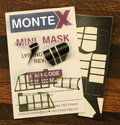

Another item for the 1/32nd Lysander that I found but failed to mention earlier: The canopy painting masks from MonteX.
I would say this is an excellent product, however I must admit this is my first time using a pre-cut mask for doing this type of glass work. (Masking the glasswork has always been my most feared aspect of building model aircraft - a fear carried over from my childhood building an otherwise rather nice B-25 Mitchell only for it to be ruined when I tried to hand paint the window divisions.)
