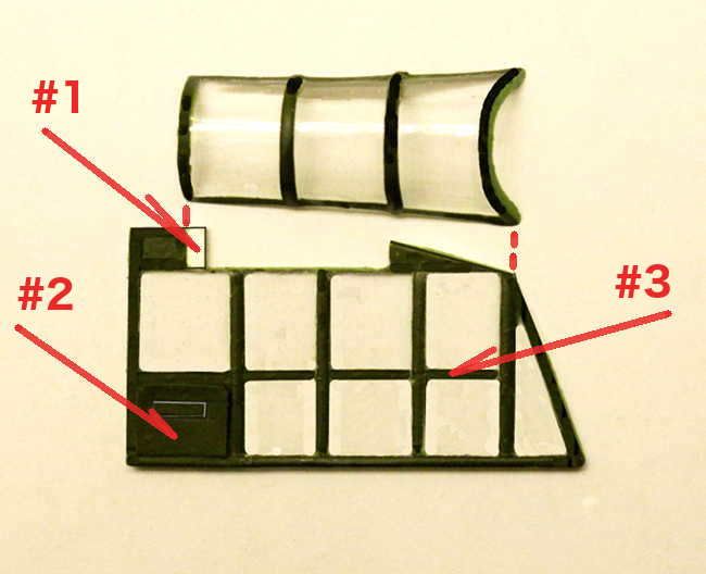

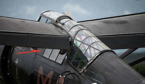

Some notes about modifications needed for these side glass canopy pieces:
#1. A small chunk of plastic needs to be added to this top front tab. First of all, this closes the remaining open space between the canopy window and the wing spar. However more importantly, it gives you a front attachment point for the arched canopy roof. Otherwise the ONLY support for this arched roof is where it glues to the rear corners of the flat canopy sides. If you recall this arched glass must also support the moving portion of the canopy that is directly over the pilot's head.
#2. Lower left window pane; (PORT side of aircraft ONLY) This square should be opaque. This is actually the cover plate for the fuel filler port. The fuel filler pipe connects this port to the main gas tank and can be seen in a number of reference photos elsewhere on this thread.**
#3. Center horizontal window divider should be located here; Both Matchbox and MonteX have left out this detail. I simply cut out a section of each MonteX mask piece to create this crossbar. (I should have glued a small plastic bar at each divider - just a painted line does not give enough detail relief.)
** If the aircraft is equipped with the auxiliary fuel tank the tank has it's own feeder line to the carburetor and also has it's own filler pipe which goes straight up thru the canopy arch. (You have to fill both tanks separately to completely fill the aircraft with fuel.)

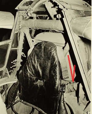

Fuel Filler Cover: . . . . . . . . . . . . . . . . . . . . . . Main Tank Fuel Filler Pipe:
KitMaker: 8,837 posts
AeroScale: 374 posts
Posted: Monday, January 22, 2018 - 07:56 AM UTC
The Canopy Arch and the fuel filler door:
Posted: Monday, January 22, 2018 - 08:02 AM UTC
A Correction:
Only SOME Lysander canopy have that horizontal window divider, others did not. So building it either way is correct.
Photo copyright Dan Pascoe / Airliners.net - used here for historical research and discussion only.

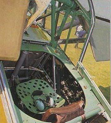

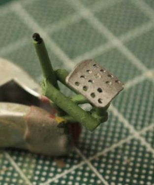

OK, once again I ask the question "bar stool or tractor seat for the gunner?"
Posted: Friday, January 26, 2018 - 11:01 AM UTC

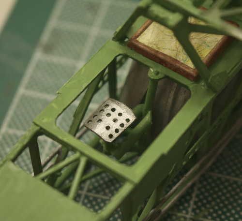

Go'n with the Tractor Seat!
The big cylinders represent springs. I have never seen a cantilevered swivel seat that did not counter balance using big springs with an adjustable control knob of some kind that sets the spring tension. This to off-set the varied weights of different gunners. This device is similar to the double springs on an architect's drawing board lamp. As a gunner this fellow needs to be loose to quickly move around (as loose as Han Solo or Luke in the gunner's seat of the Millennium Falcon.)
Still waiting for those twin Brownings to arrive to give the Gunner something to do.
Early on in this build I made a boo boo. I put the gas tank in backwards. The curved side is supposed to face forward and tuck in just a bit under the pilot's seat. This means the tank now protrudes too far to the rear. To compansate I had to angle the gunner's seat post (slanting to the rear rather than perfectly vertical as it should be.) in order to clear the tank. So if anyone else follows this build, be forewarned.
I should have built a scratch gas tank instead. I don't think the Matchbox offering looks anything like the real deal.

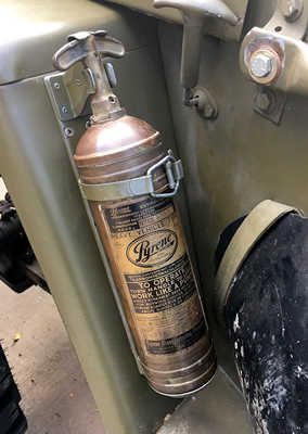

A rookie question:
Fire Extinguishers both British and US - if they were inside a vehicle were they painted red?
Also what color were the oxygen bottles in British aircraft? How 'bout in US aircraft.
I think US aircraft had either pale green or yellow oxygen bottles but what about in British planes?

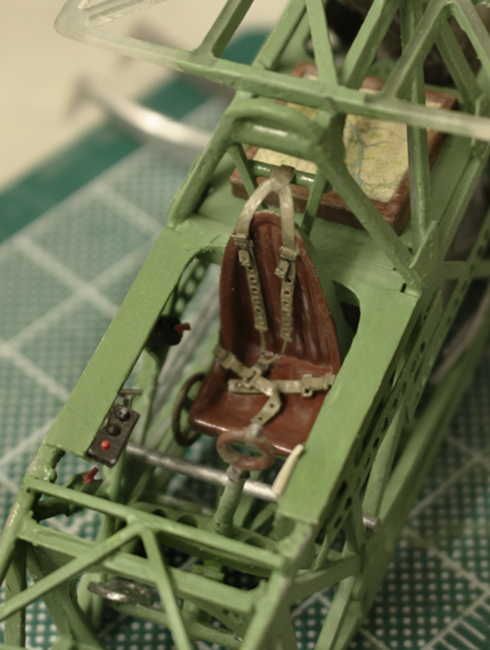

Posted: Friday, February 02, 2018 - 09:40 AM UTC
Despite Patrick's very correct comment - I had already installed the Eduard shoulder harness into the Lysander. It looked so good I did not have the heart to rip it out again. Here is the result: So - they stay!
I think they look so good I just cannot resist!
AND the pilot figure still fits into the seat with his harness and chute pack!

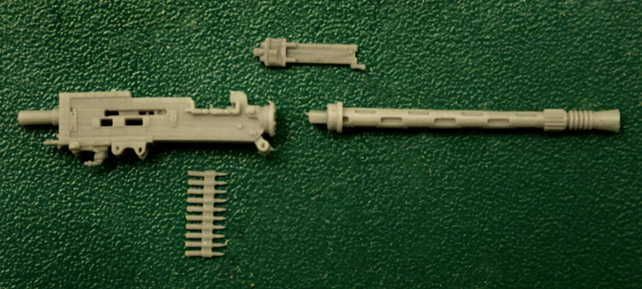

The Brownings have arrived from Gas Patch!
(And I got FOUR when I only expected two!)

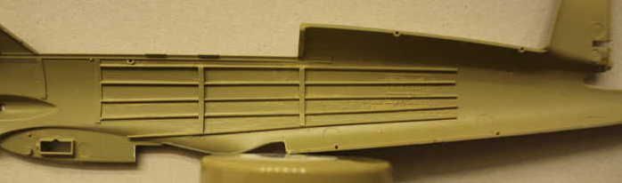

Also I am up to my old Lysander acquired tricks in adding the internal ribs that support the aircraft's cloth skin. It is an easy way, I feel, to add more complexity of detail that will be visible down thru the cockpit openings.
Discovered just tonight that HpH has come out with a resin Arado in 1/32nd scale and they included the cloth ribs on the interior of their fuselage. Makes me feel like I am on the right track when I find a major manufacture making the same detailing choices as myself.

KitMaker: 10,113 posts
AeroScale: 7,348 posts
Posted: Friday, February 02, 2018 - 10:20 PM UTC
Mike,
I just finished reading through your entire build to date. A most impressive build for sure. Your research, willingness to modify, and add detail as needed has resulted in a one of Lysander that's steps ahead of any build I've seen to date.
And thanks for sharing the multitude of reference pictures that just might be useful to WW11 modelers like myself down the road.
I can't answer your question about the color of British Oxygen bottles and fire extinguishers, but the USA aircraft at the beginning of the war used Yellow for Oxygen bottles that was carried through till the end as far as I can tell. Fire extinguishers started off as unpainted bottles with the handles paint red. At some point the bottles were painted. I've seen examples painted in Gloss Red, Gloss Green, & Silver. Honestly, I have no definitive answer. this is another question that I'd defer to Dana Bell.

Joel on the fire extinguishers I get the impression that before the aerosol type extinguishers came out we were just talking about the old fashioned, all brass soda water type Pyrene extingusher. The red handle you had to manually pump. One pump, one little spit of water at a time.
But I know British tanks had some sort of small pressurized extinguisher and I just thought the English planes would use the same.
Posted: Sunday, February 04, 2018 - 08:16 PM UTC
Michael,
Yep, that's what I've understood they used, and that they weren't painted during that time frame.
