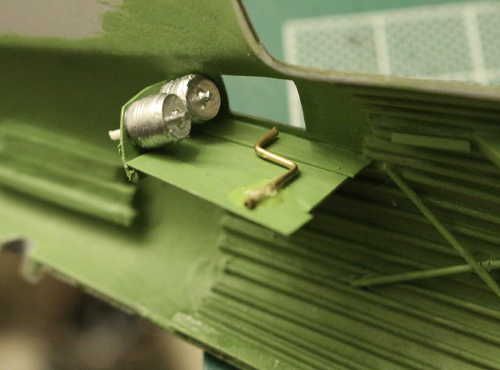

Also I am up to my old Lysander acquired tricks in adding the internal ribs that support the aircraft's cloth skin. It is an easy way, I feel, to add more complexity of detail that will be visible down thru the cockpit openings.
Discovered just tonight that HpH has come out with a resin Arado in 1/32nd scale and they included the cloth ribs on the interior of their fuselage. Makes me feel like I am on the right track when I find a major manufacture making the same detailing choices as myself.
You might want to spray a blotchy red-brown on the inside of the fabric areas and then go over the frames with your paintbrush with interior green. The first coat of dope to go on was tinted red to allow the Erks to see where they sprayed it, and that was visible through the inside of the fabric.

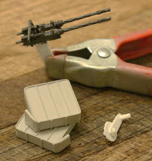

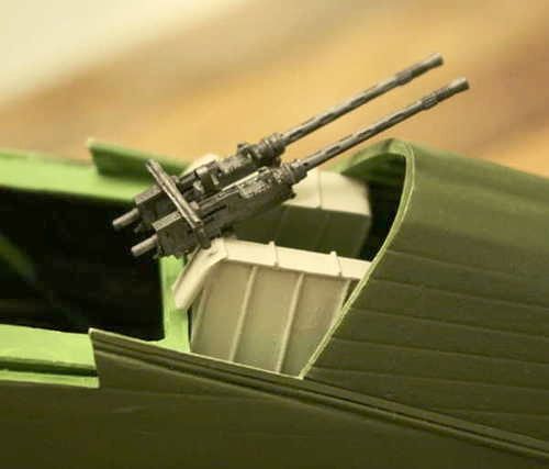

Work'n on giving the Lizzie some teeth!
You can just see one of those big .303 mags above the twin muzzles.
My work today includes the beginnings of the two high capacity .303 magazines for the install.

Posted: Saturday, February 10, 2018 - 08:54 PM UTC

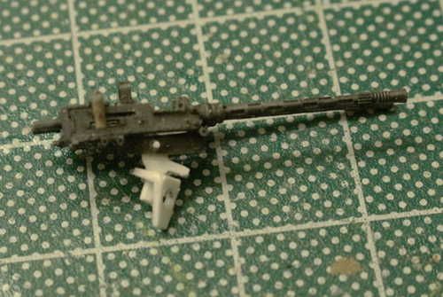

Progress on the twin Brownings:
This photo shows only a temporary mount. The actual mount will be somewhat more forward in the aircraft.
Here the twin guns are mounted on a painting stalk for construction handling. The actual gun mount appears in the lower right corner of the photo.
Still have many problems to solve on the issue of belt feeds for the guns.

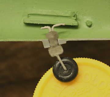

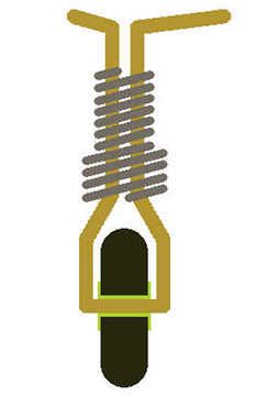

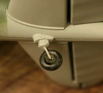

Cleaning up some other small jobs before closing up the fuselage:
The Tail Wheel
I wanted something more substantial than the plastic structure that came with the kit for the tail wheel. So I got some heavy brass rod, drilled through the wheel center hole and shaped the yolk for the wheel using the heavy metal rod. Finished up the assembly with a wrap of thread mixed with super glue. (Not pretty but it certainly is structural and gets the job done.)
The brass will definitely be stronger than the plastic.
This metal yolk will no doubt survive more accidental abuse than the lightweight plastic piece ever would.

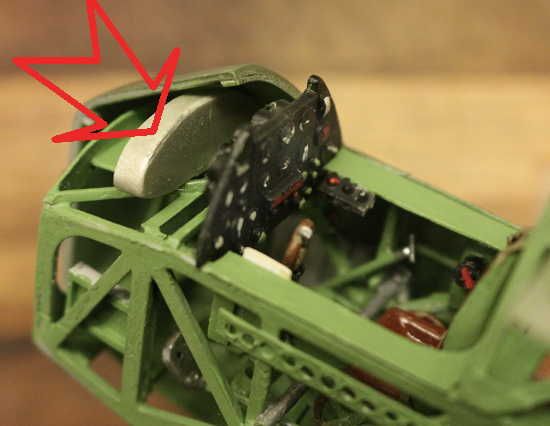

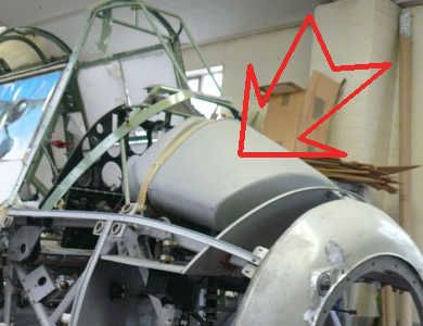

Another fuselage internal housekeeping item:
I built up and installed the front profile plate of the engine oil reservoir (see red arrow) just in case it could be seen around the edge of the instrument panel.
Above photo from the Aircraft Restoration Company used here for research and discussion only.

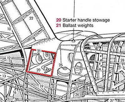

Another fuselage housekeeping item: (Last item before closing up the fuselage halves.)
The rear storage and ballast compartment. This area is accessed by opening one of the two small window/doors near the tail. The compartment contains the engine starter crank and the adjustable flight load balance weights.
