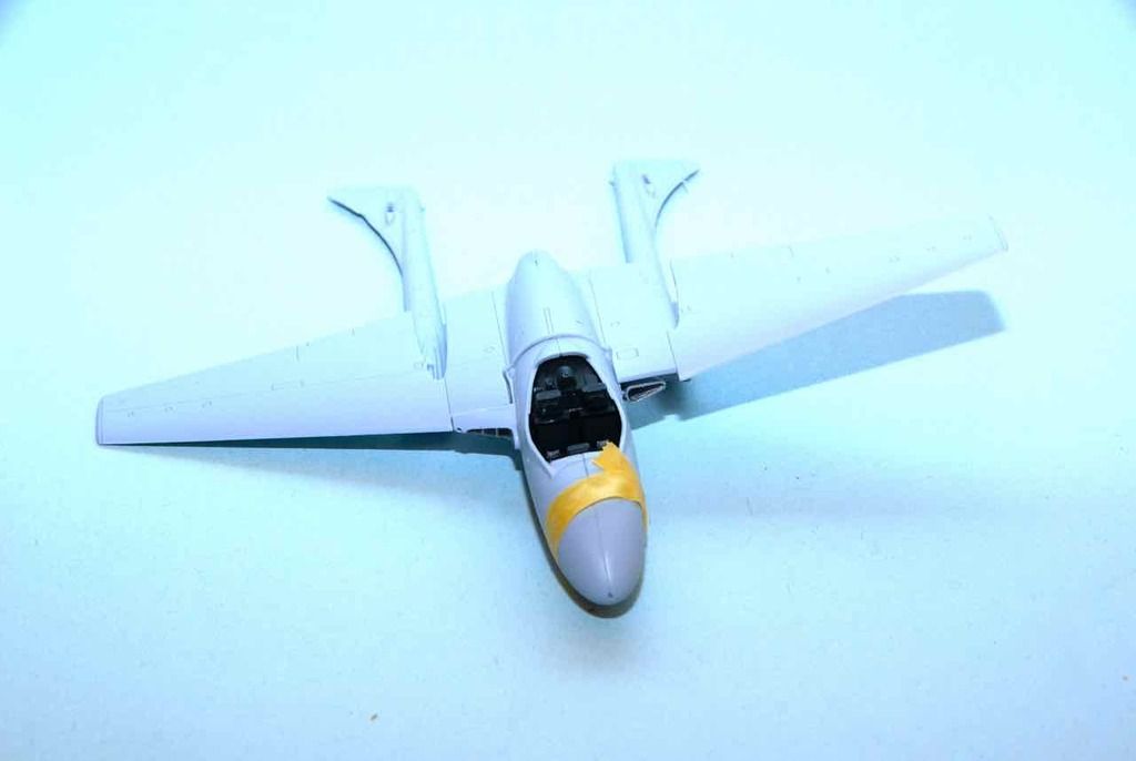

Jan, your Vampire is looking really nice. I like the panel line detail. Just wish that I could find one in 1/48.

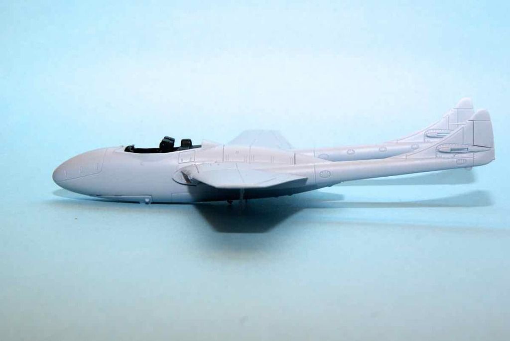

Well not a lot of progress but some is better than none I guess. The upper wing of the Vampire is now officially glued in place (...wonder what 'glued unofficially' would be...). When I tried dry fitting the tail booms they didn't sit equal vertically so I had to spend time using needle files on both the booms and the openings in the upper wing where they reside. Here are a few images of the booms dry fitted.
Oh, forgot to mention that I had to fix the main landing gear struts to the booms as it won't be easily possible after the booms are glued in place. You'll note that the aircraft easily sits node down on the main undercarriage struts so I guess I got enough weight in the nose! Now to figure out how to attach the tail piece between the two booms and have everything line up!

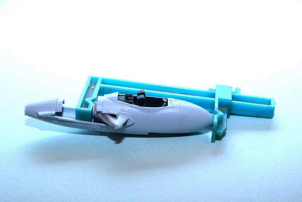

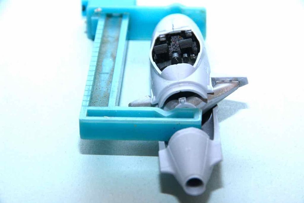

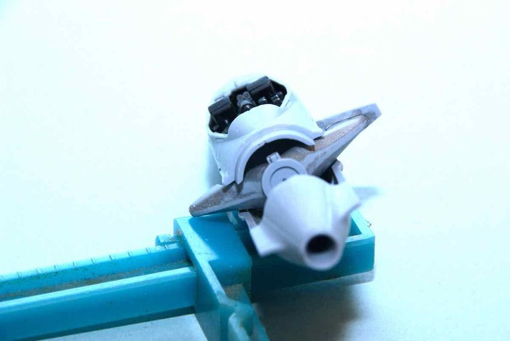

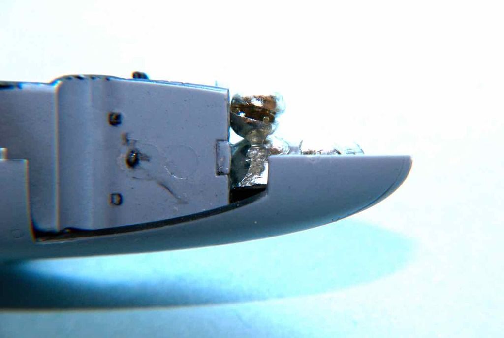

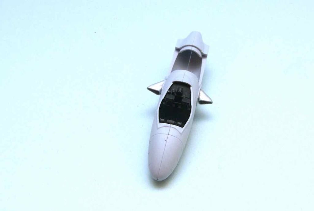

In my case I managed to squeeze in one more sinker weight in the nose, give all the weights one last coating of glue and finally had the nerve to seal up the forward fuselage. Front of the intakes are attached as is the intake manifold assembly, cockpit and engine exhaust. Ive also installed the forward landing gear bay and cannon cover plate.
You may notice in the image above and the next image that I spent some time smoothing out the seams in the nose section.
If you notice the seam it's actually a bit of staining from when I sprayed the cockpit interior with flat black. If one runs the end of a pin or strider lightly across the seam it feels totally smooth. The final image shows the fuselage assembly from the rear and work done on the upper seam lines.

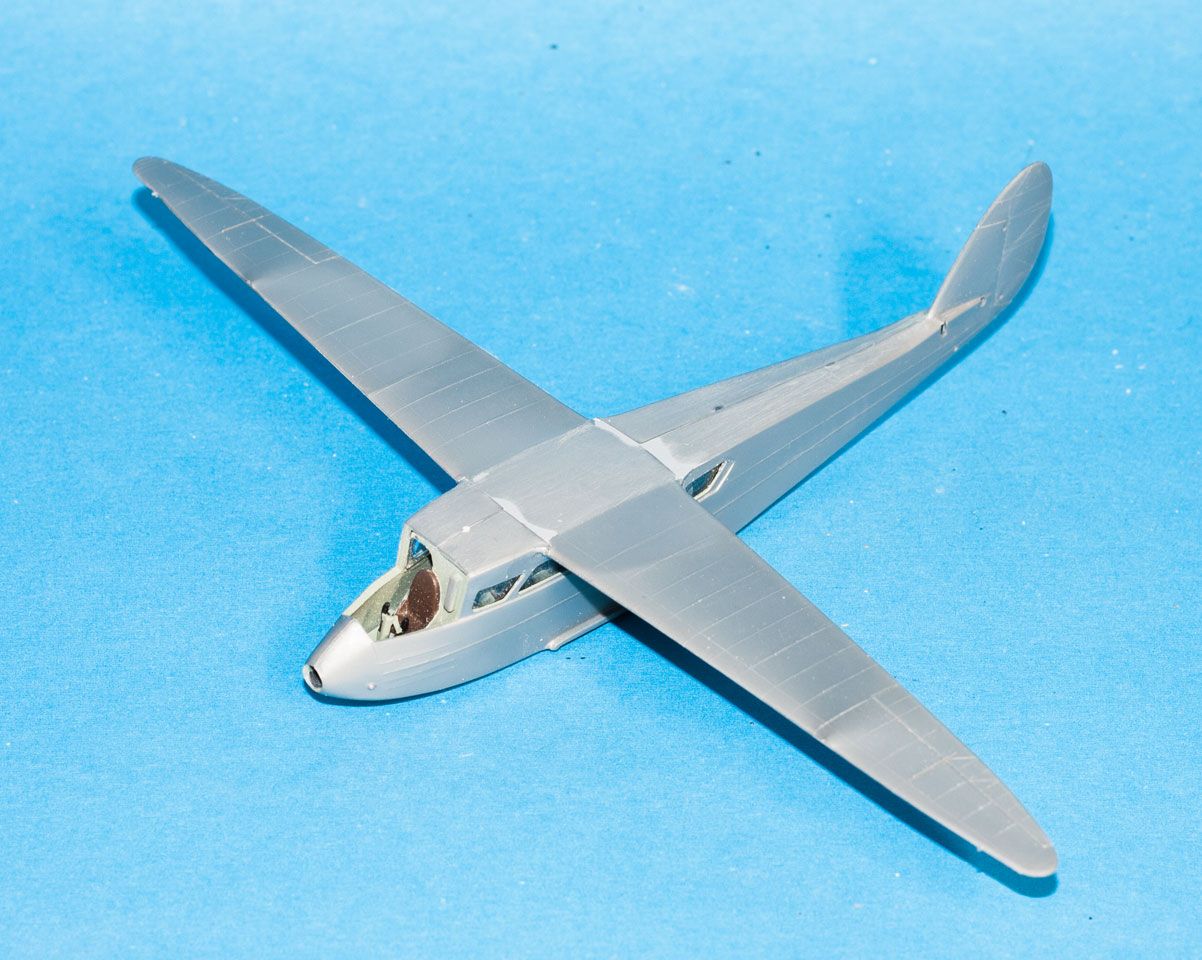

Almost ready to prime:-

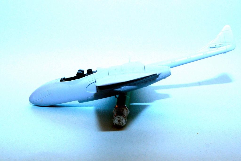

I've been agonizing about the nose weight for a few days now. Is there enough and where could I place more even if I wanted? SO "damn the torpedoes and full speed ahead", oops wrong site? I glued the cockpit together, glued it into the port fuselage halve with as many sinkers as could fit in the nose area and glued up the fuselage halves..
Next I dry fit the intake ductwork into the body and dry fit the wings. I took a round hobby knife handle and placed the Vampire so that the handle rested under where the main landing gear will be located. With one tailboom dry fit the nose dropped like the proverbial stone.
Even when the second tailboom and tailplane in place there should be enough weight so it's not a tail sitter. After gluing up the intake manifold pieces and adjust its fit the ductwork was glued in place.
Next I can start on the tailboom/wing pieces and start making this thing look like a plane.

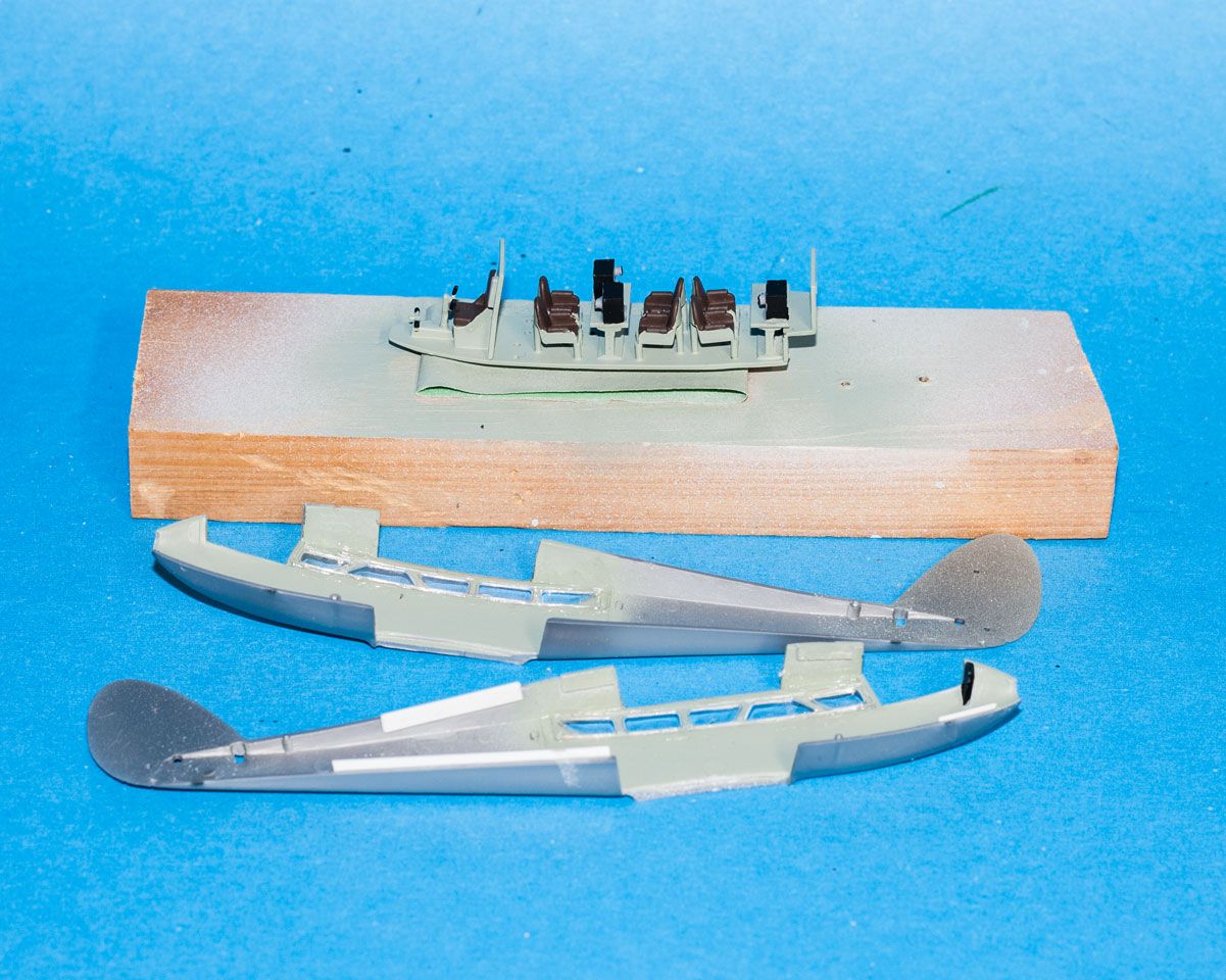

Richard, she is looking nice. I did not think there was that much room for personnel.
Hi Bob
The only information I could find mentions six trainees and Rx/Tx radios so I came up with my interior.

Here is an update of my build:-

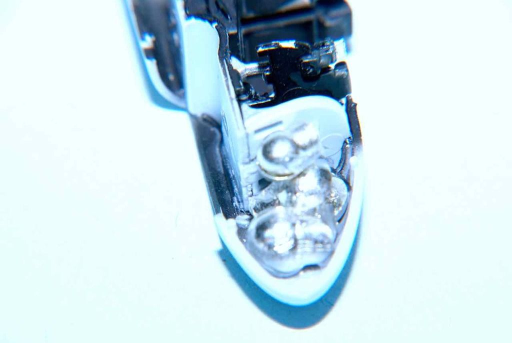

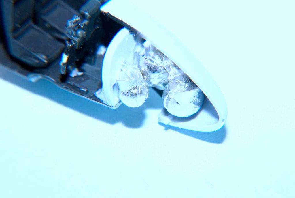

More progress although rather slow. I finished adding the nose weights and will hope that there is enough to keep this bird from tail drooping. I used a glue called "LePages 100% Glue" to attach the weights to the front fuselage. The stuff is supposed to be useful for almost any material. It is the consistency of the old model tube glue, becomes tacky very quickly and after about 15 minutes has a gelatine like consistency. Thorough drying time is stated to be 24 hours and it dries crystal clear. Images of the weights in place:
Here's a picture of a dry fit of the fuselage halves together and the intake manifold place in position.

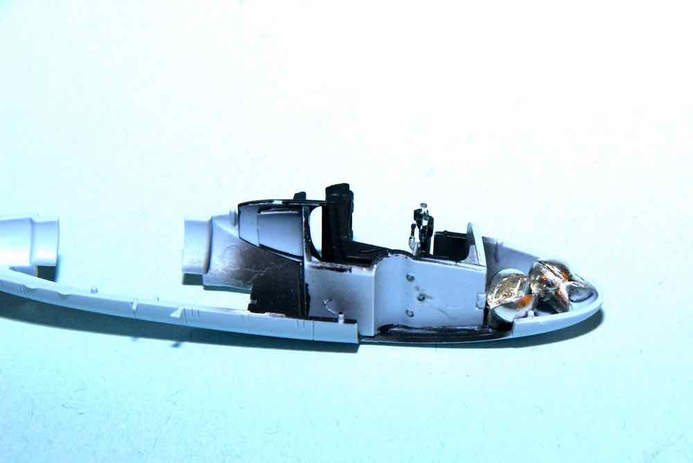

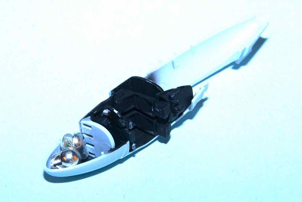

Well I'm back again but not with the progress I thought. Turns out that the Vampire is going to require 1/4 ounce or 7 grams of weight in the nose so that it isn't a 'tail sitter'. I picked up some fishing line sinker weights to hopefully fulfil the need. Unfortunately they don't tell the mass of the four different size weights so Ill have to "guesstimate" what will be appropriate. Here's some picts uf what I'm talking about and the cockpit is now glued onto the port side of the fuselage.
I chose the biggest and second biggest of the weights and yes, I've tried dry fit closing the fuselage and the weights fit. I've glued in the two larger weights and added the third smaller one but images of that couldn't be taken until the glue on the weight dries more.
